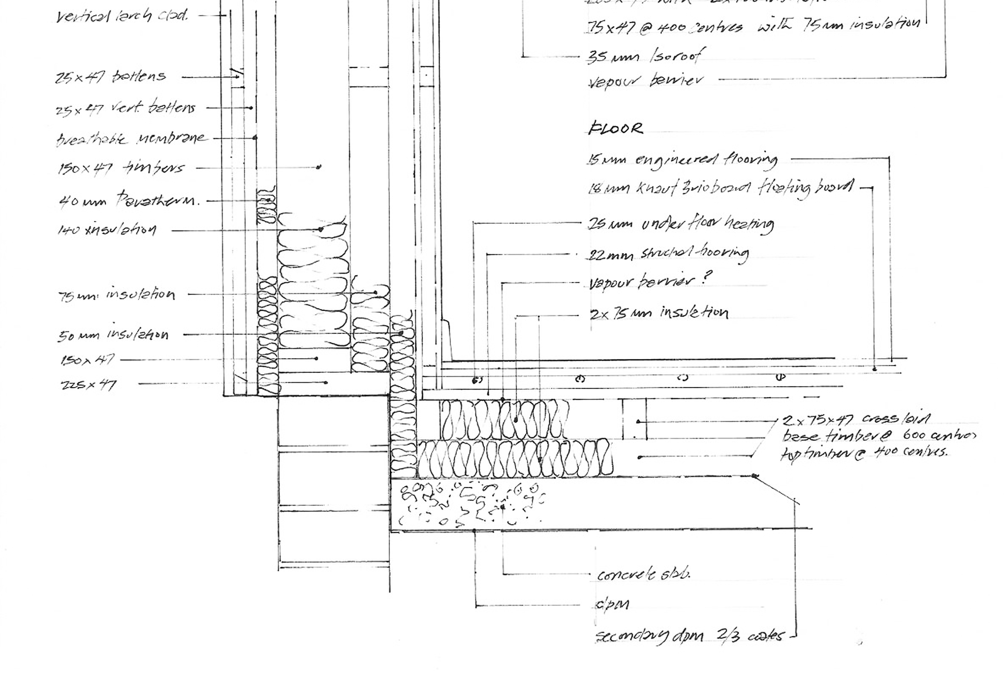

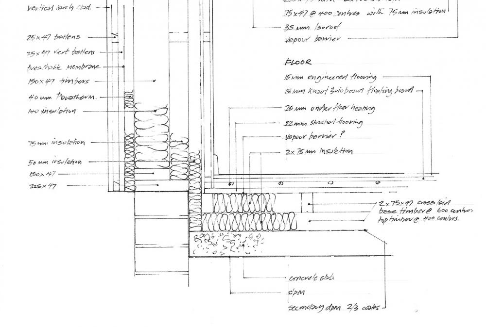

The concrete slab is already in. Celotex seems in short supply at the moment and the cost has risen another 20% so was considering a suspended floor instead, it also avoids the final screed cost as well.
I was planning to fit 150mm celotex, UFH, screed then engineered flooring on top of the 100mm concrete slab but due to rising costs and supply issues wondering about an alternative approach. I have enclosed a drawing (by hand) which shows the build up. 2x75x47 cross laid, base timber @ 600mm centres, top timber @ 400mm centres. 2x70mm Rockwool flexi. Then vapour barrier, is it needed? , 22mm structural flooring, 25mm underfloor heating, 18mm Knauf Brio floating board and finally 15mm engineered flooring. Looking at the list not sure if it would be any cheaper but will cost it up. Does anyone have any costs for floor screed per sqm as a guide. Your thoughts appreciated as always,
