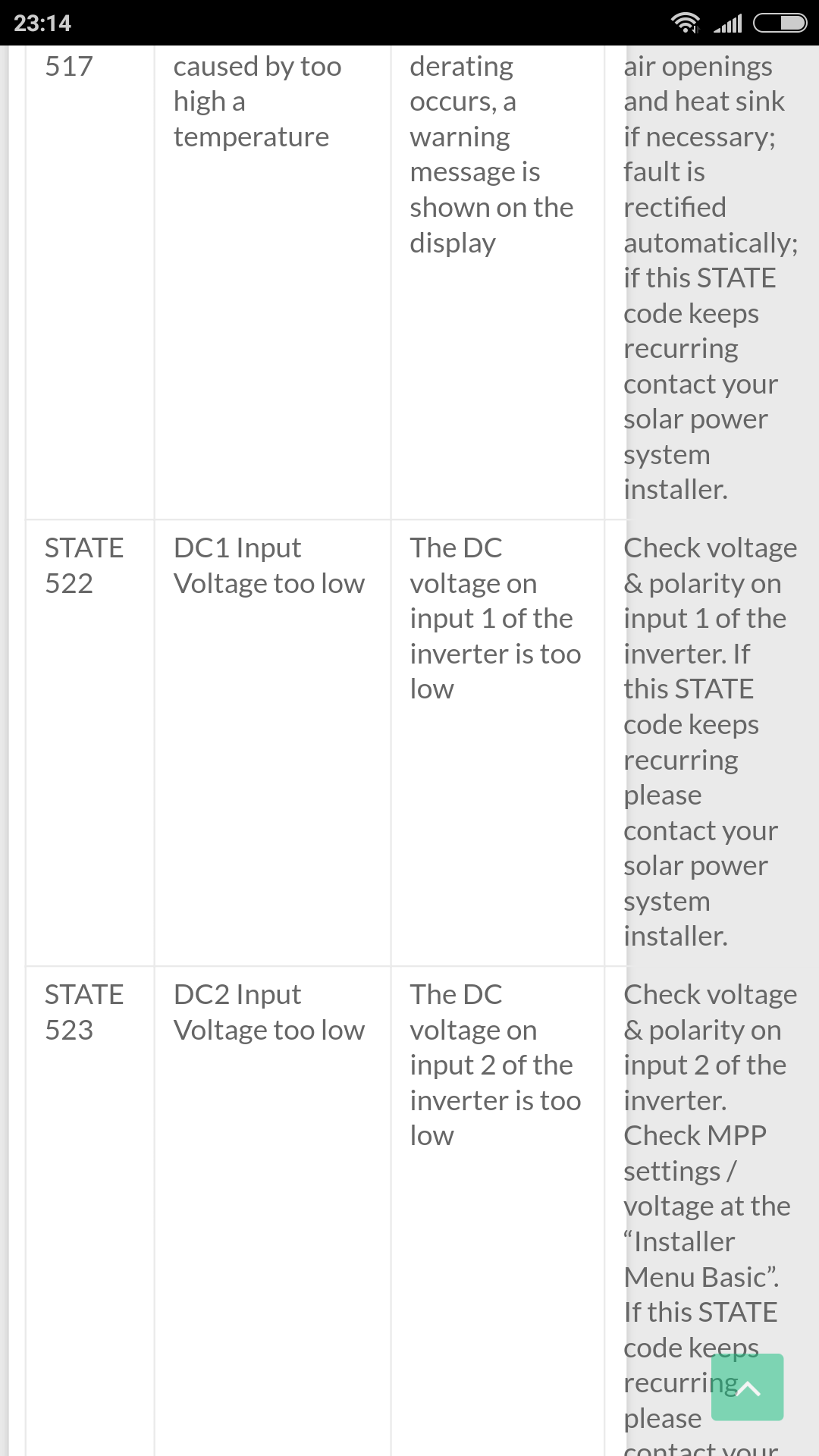

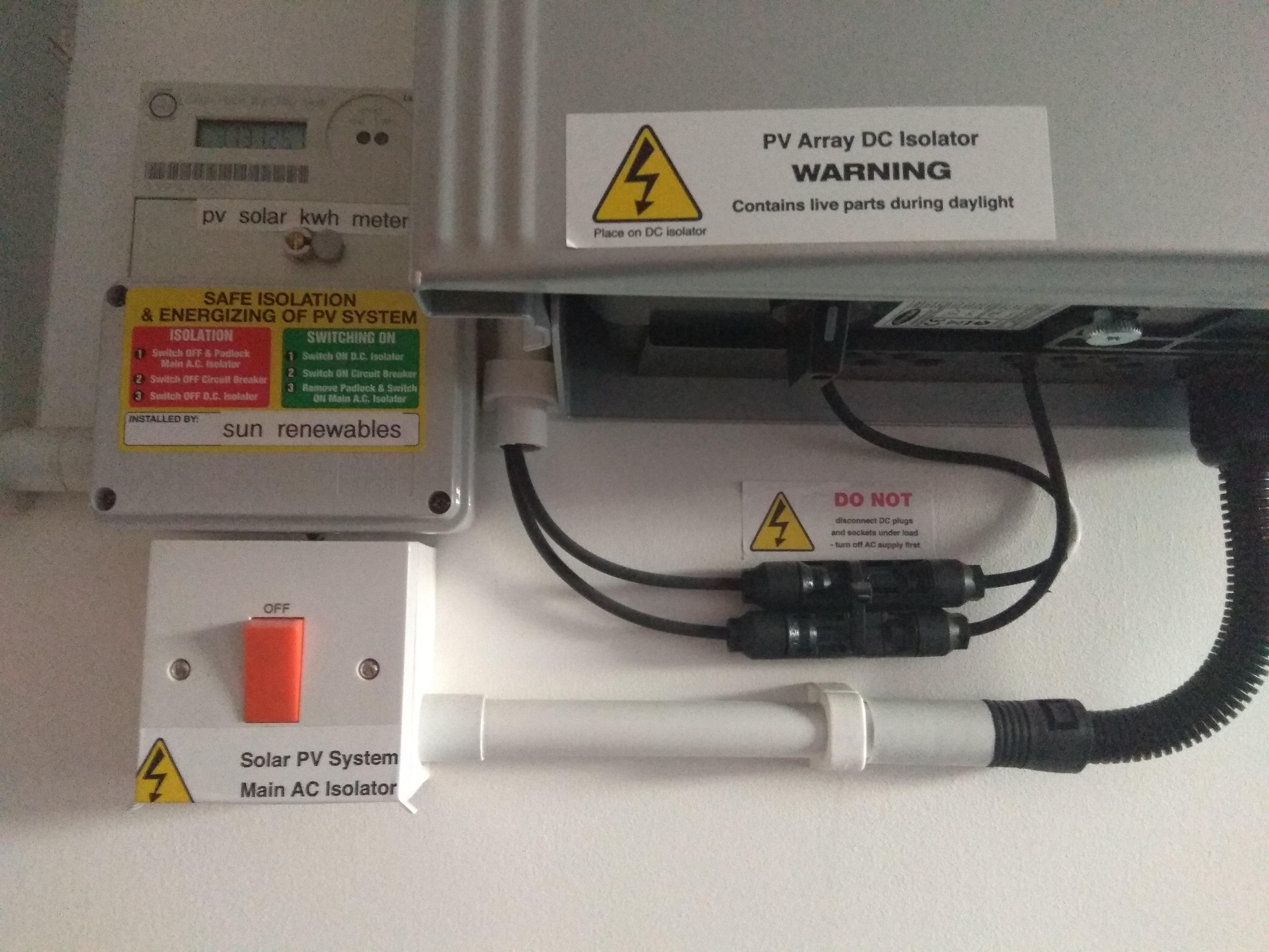

The fault codes are below so by swapping the wires the fault has moved to the other string. Is that not what was supposed to happen.
