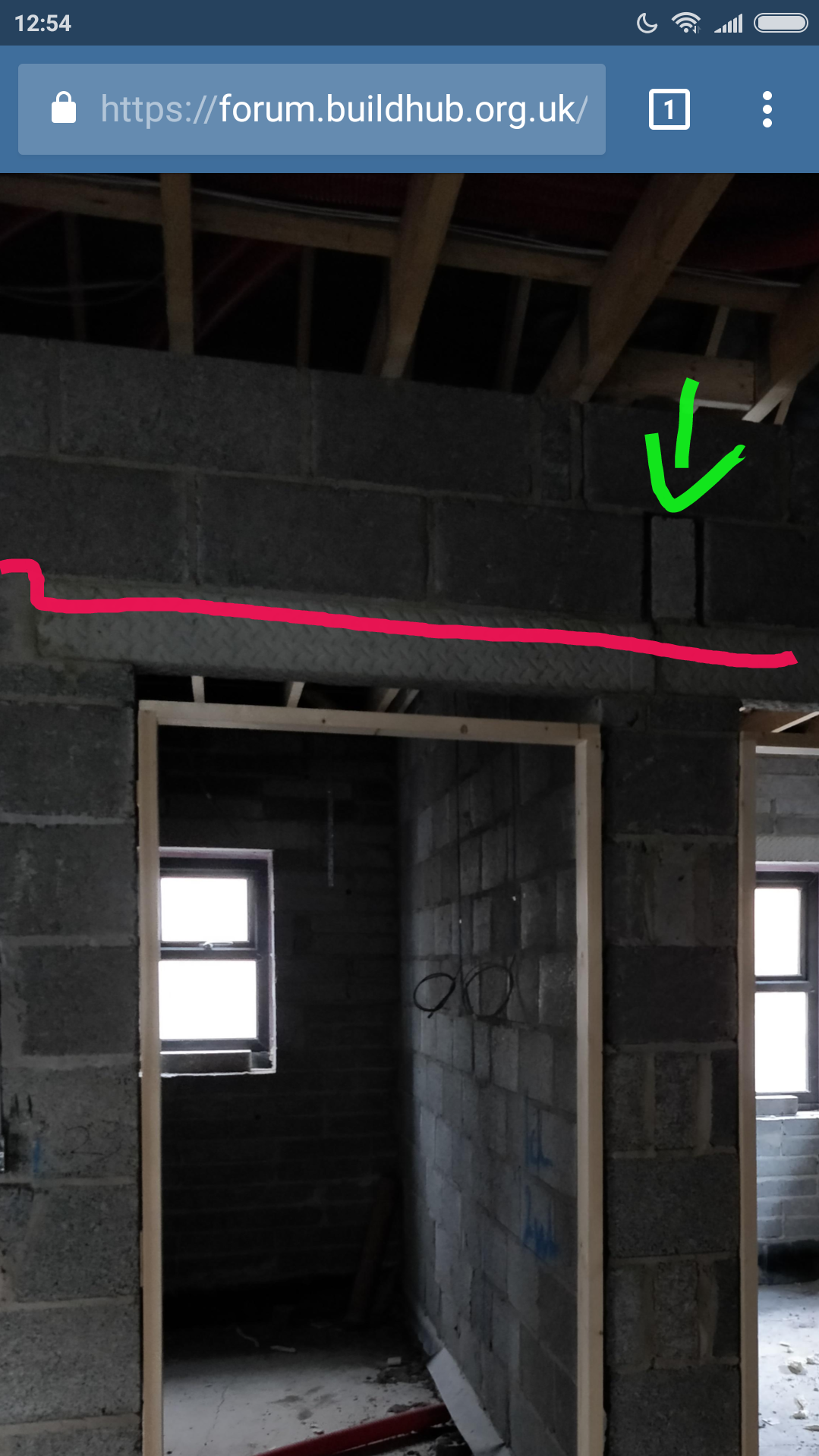

That's a brick under the head. A brick ,75mm, plus a 150mm concrete head gives you 225mm which is block coursing measurements. If they had of cut the brick down with a saw then they would have been out on the next row as the blocks on the wall beside it would sit higher. How would they have dealt with the step down in the wall as shown in the pic. They would have needed to bed blocks up 50mm in 2 courses. Good luck trying to get them blocks to sit. Plus the wall that is tied into this blockwork , green arrow, how would that have worked as it would be 40/50mm higher that the wall with the concrete head on it. It's just how every single block house is built. Unless they are going to start making concrete heads at 180mm to suit over door openings then there will always be a gap. Most builders don't even fill the hole. The scratch coat will come down a bit and the skim coat another bit and once the door architrave is on its hidden.

They weren't being lazy they have to build it like that to keep in coursing. If they had of built the head in at the height the brick sits at you would be chopping the bottom of all the doors. I put timber blocks in the gap and cut some cement board up into strips. Screwed these to the blocks on each side and put a mesh over and then the scratch coat came the full way down.
