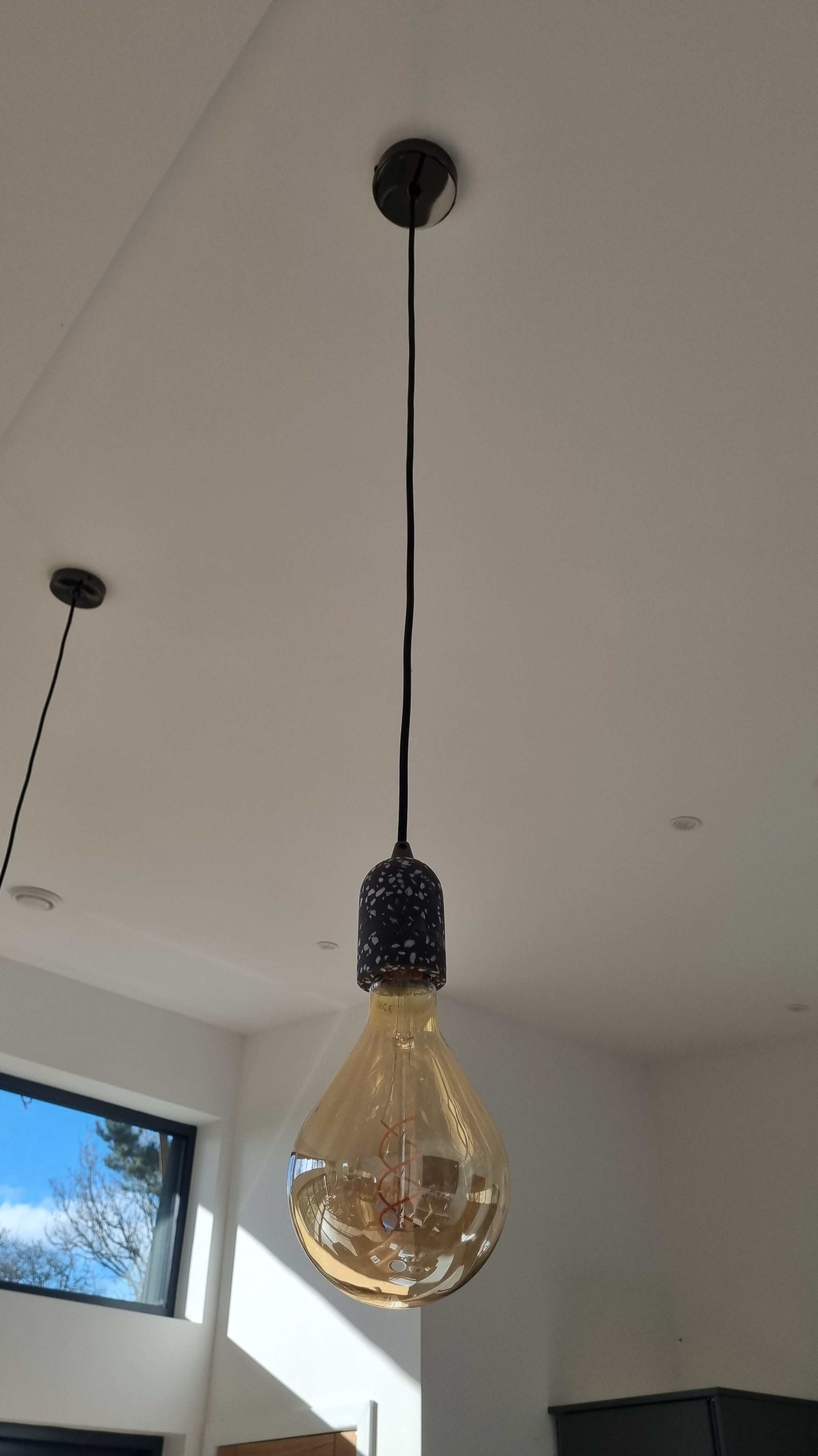

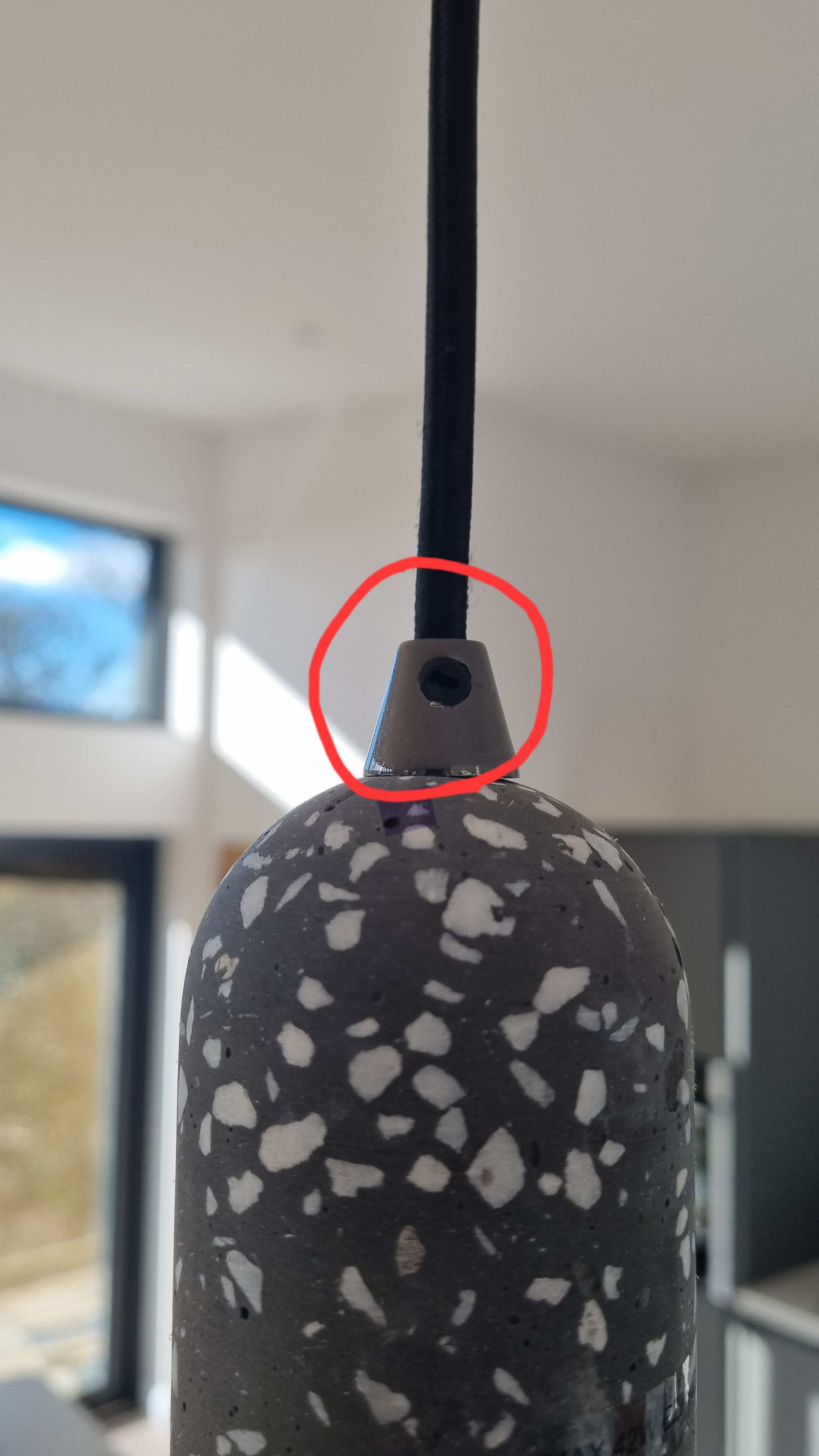

Vaulted ceiling pendant lighting conundrum
BotusBuild replied to Lincolnshire Ian's topic in Lighting
We have a sloping ceiling in our open plan living area. Over the kitchen island we have 3 pendant lights that hang down. Each cable is about 1m. At each end of the cable there is a "grommet" on the fitting (i.e. at the ceiling rose, and the light "socket") that has a plastic grommet screw that holds the cable - these take the strain of the weight than the cable screws inside the fittings.
