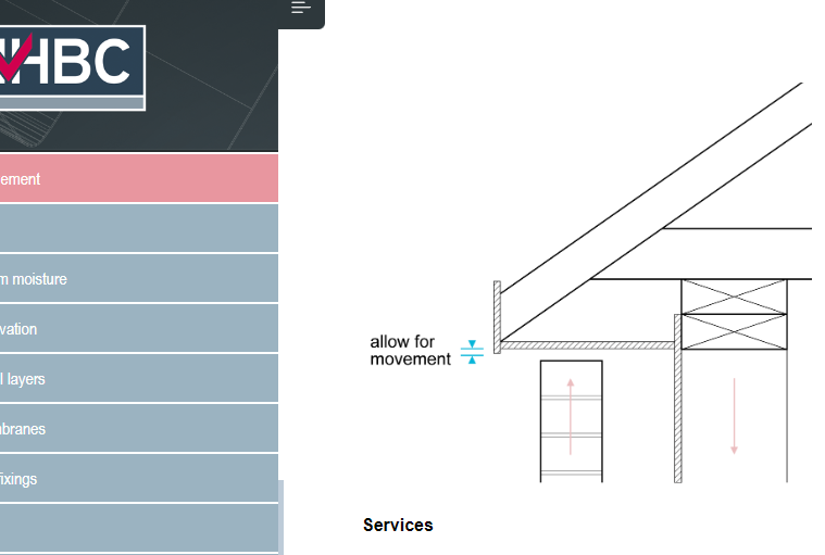

Filling the gap between soffit & outer skin brickwork
Mr Punter replied to Mikey's topic in General Construction Issues
Unless you are doing this for aesthetic reasons as part of a facade remodel you are wasting your money. You can do a 2 storey rear extension without full PP.
