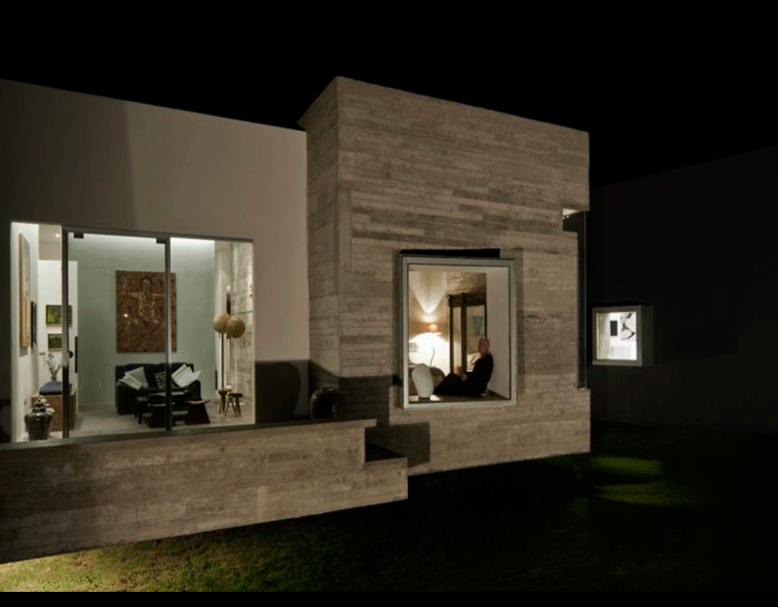

  23. No, keep oblong box room but make its big window a bay in a cheese wedge shape....bad example here but 1st I could find in a hurry;
