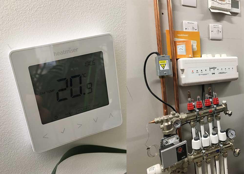

  7. Given you've already wired to thermostat positions (are the back boxes on?) you can start by using as a single zone and if dont like then just cut through to the back boxes and put stats on. You'll also need to add actuators to the manifold and a wiring hub alongside it. I've used Heatmiser neostat v2's and neohubs. I've 2 manifolds with 4 and 7 loops from which i've created 6 zones (stats). The kit and caboodle to do this cost ballpark £650 plus (from the stage you're at now) it'll be an electricians day to hook it all up. Slightly off your topic Viv, I wonder if those promoting a single zone approach would do so almost regardless of house layout? I'm dealing with essentially a long bungalow with one half being bedrooms and the other being a single open plan live/dine/kitchen, and historically we never actively heat bedrooms(though they've always been upstairs so benefitted from rising heat).
