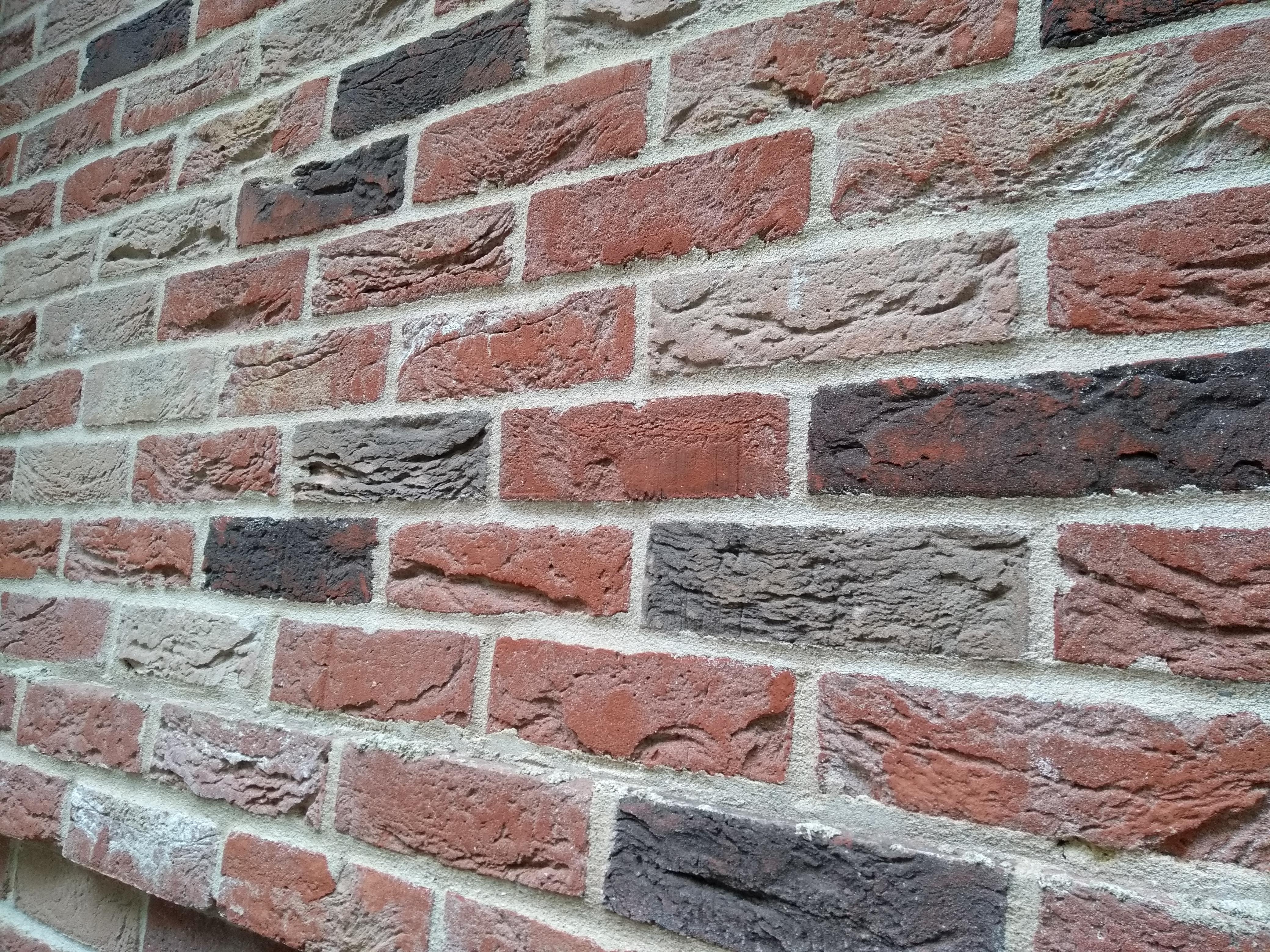

Our bricks are similar and we went for bucket handle although a 1" dowel was actually used. Got any spares bricks you can experiment with?
