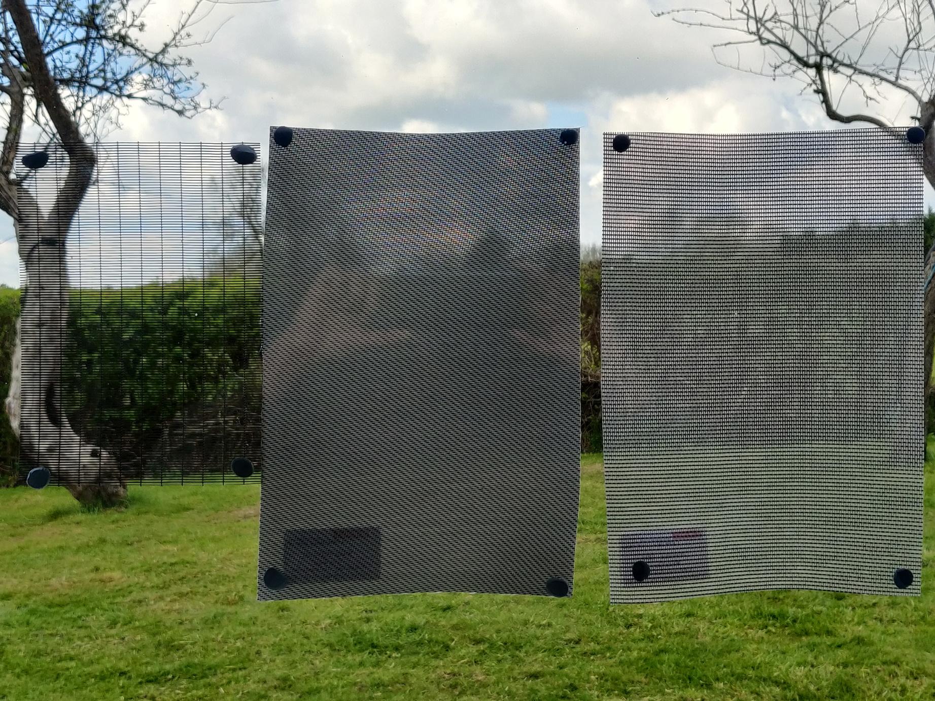

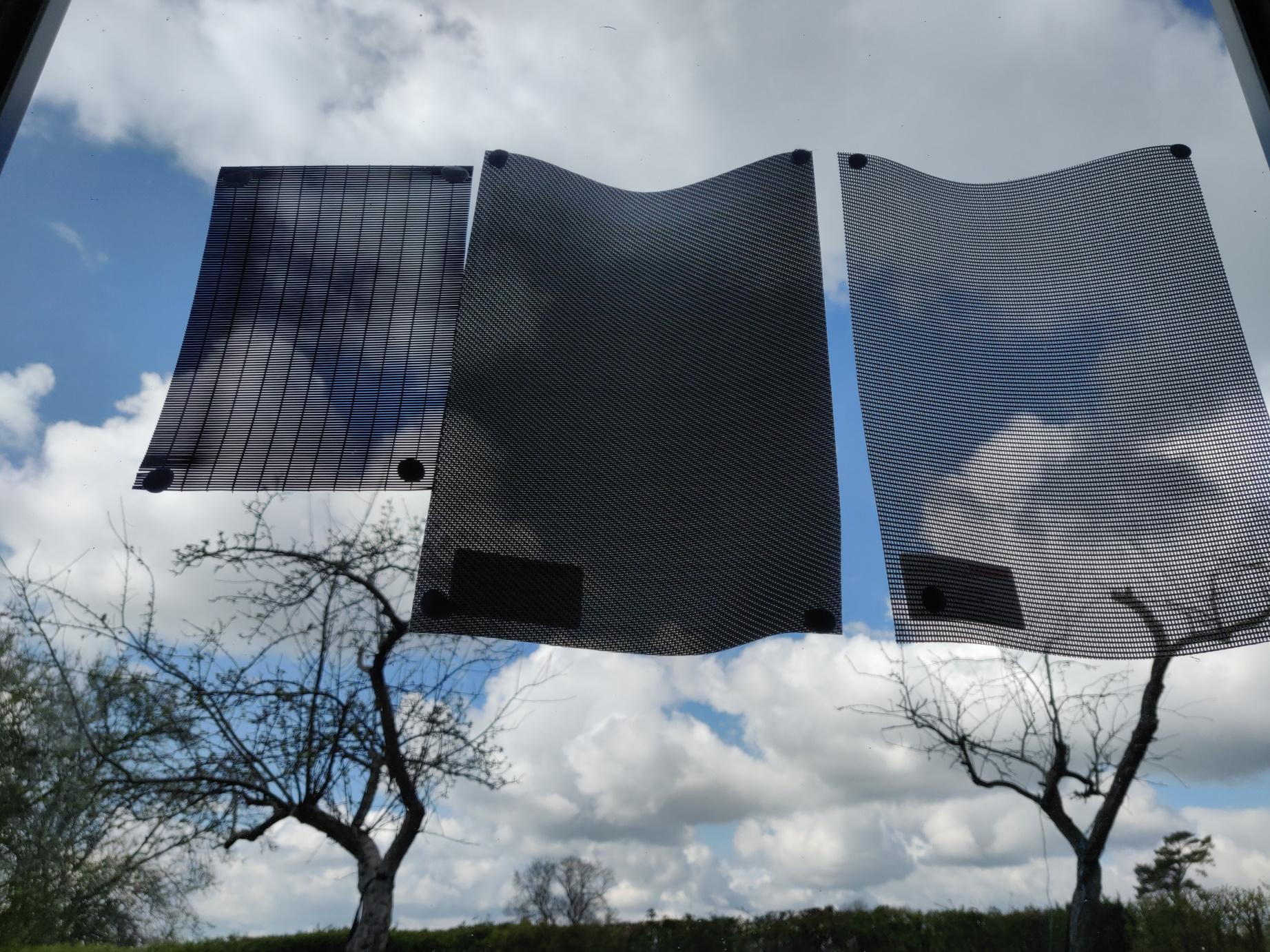

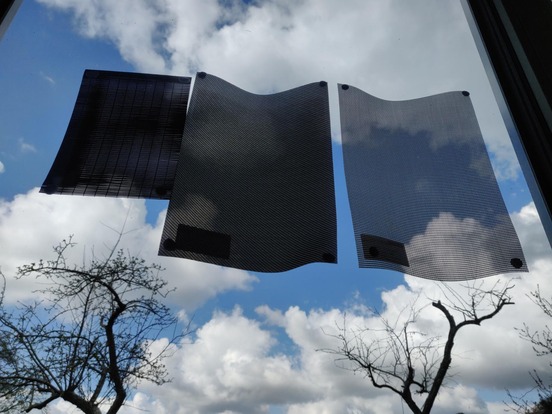

ragg987 replied to ragg987's topic in Environmental Materials & Construction Methods
Comparing Microlouvre to Mermet Satine 5501 to Mermet Ultravision. Images at 0, 20, 40 degrees inclination. -
Living in our build for over 5 years now (is that still a new build?) and turning to first cycle of maintenance. Internal painting, quotes on way. Check. Cleaning drains / gutters. Check We have approx 20m2 of South and West facing glazing. Great in the winter as the light and solar gain is very welcome. But last summer we got too hot indoors, despite running the ASHP to cool. A large patio umbrella has helped, it partially shades 2 of the glazed areas. But... Googling I came across this product, Microlouvre. https://www.smartlouvre.com/ It looks great, I could clip it on to the windows, externally, around April or may and remove it in aug or sept and store in the garage. A sample arrived and it looks good, permitting a view out while completely blocking sun from about 40 degrees up. Anyone got any experience? Not priced it yet... Alternatives I looked at: External solar film. Not removable and reduces light and solar gain in winter. External roller blinds. To be effective for solar shade they pretty much block the views and light. V expensive for electrical control. Light sails, awnings, brise soleil. Don't like the big overhang, not practical in our build. V expensive for electrical control. Fixed slats. Already have this on one window, works well. Other half not keen. Plus impractical for glazed doors.
