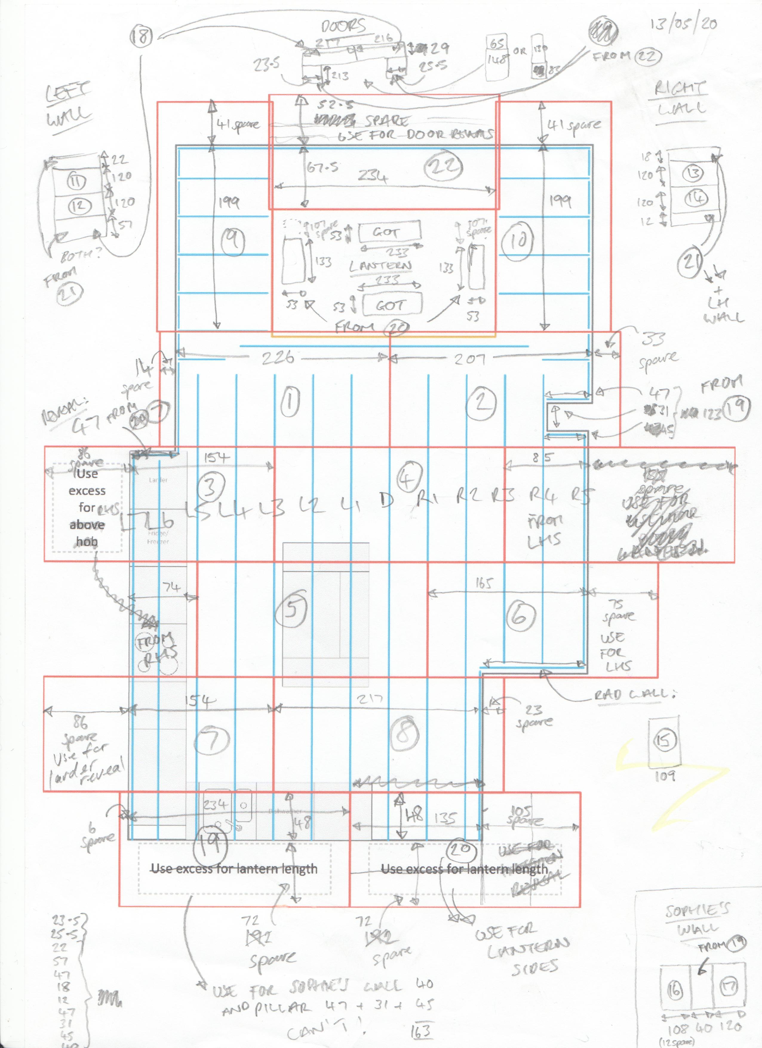

  13. Whether it's my tight Northern roots or an undiagnosed OCD I go to what normal people would likely regard as extreme lengths to maximise return and minimise waste on things like this... Here's the plasterboard plan for our family room ceiling and walls: It was pretty successful and led to barely a handful (literally!) of offcuts! Even at minimum wage though I bet I spent more planning and 'solving the puzzle' than I saved on materials so I don't think I'd necessarily recommend it! It also meant I couldn't afford to screw any cuts up which, unusually for me, I somehow got away with. A great feeling when it all goes to plan though!
