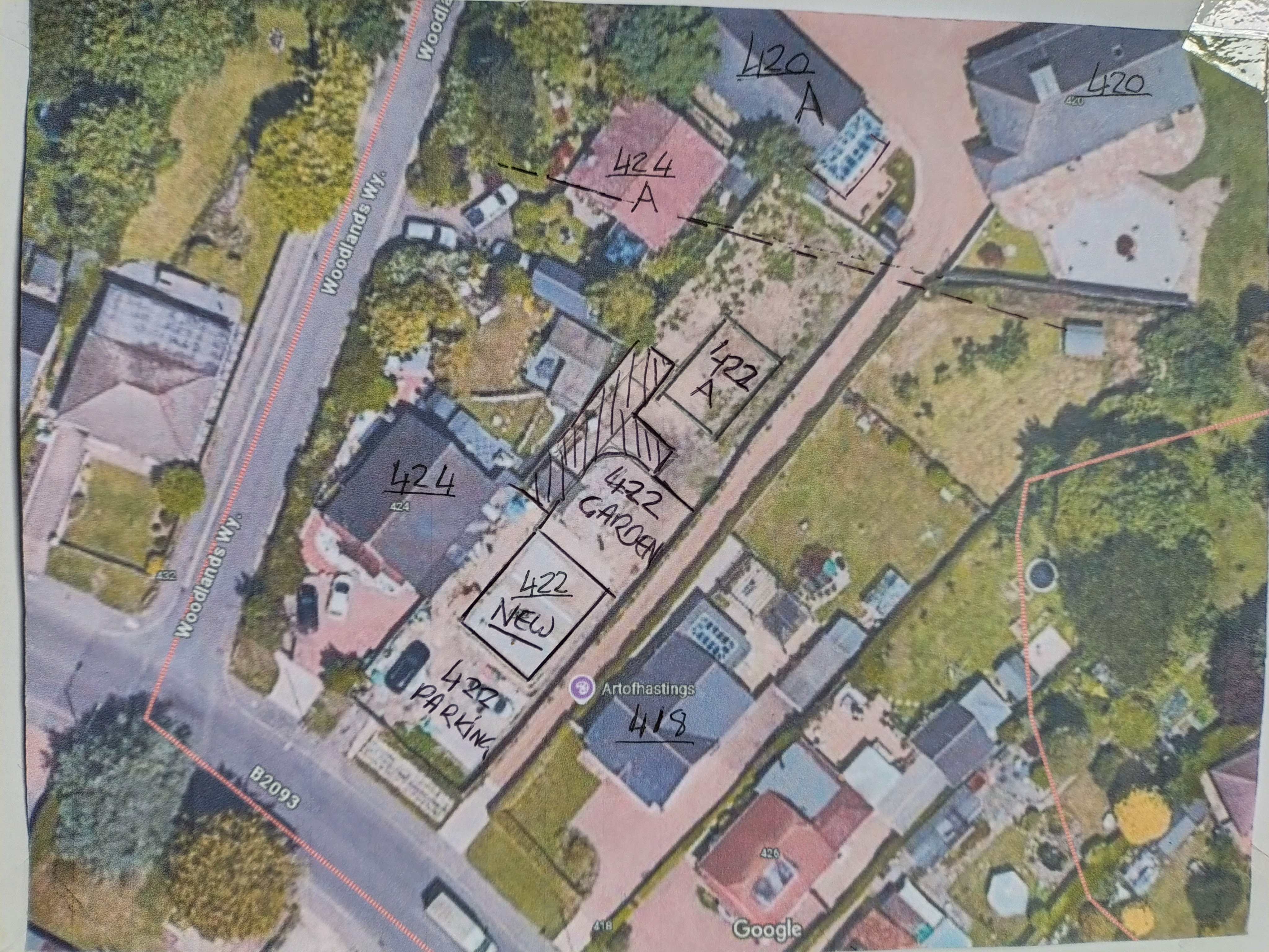

Looking for advice as nearly completed our new chalet bungalow in place of the old 1930 bungalow. Have access to the rear garden down side of New build. (3.3m width) Brief history 424A built in early 80s not allowed rooms in roof! 420A Annexe is a converted garage with a conservatory attached. 420 recently developed extra rooms and new dormers in the roof area. 418 extensions front and rear sometime in the 90s Do we go for outline planning for a 2 bed single storey bungalow or put in a full application?? Pre app advice from planning is a couple of hundred ponds more than outline or full planning! The site area would be 27m deep by 14m narrowing to 13m at top of garden area. Advice and any ideas would be appreciated.

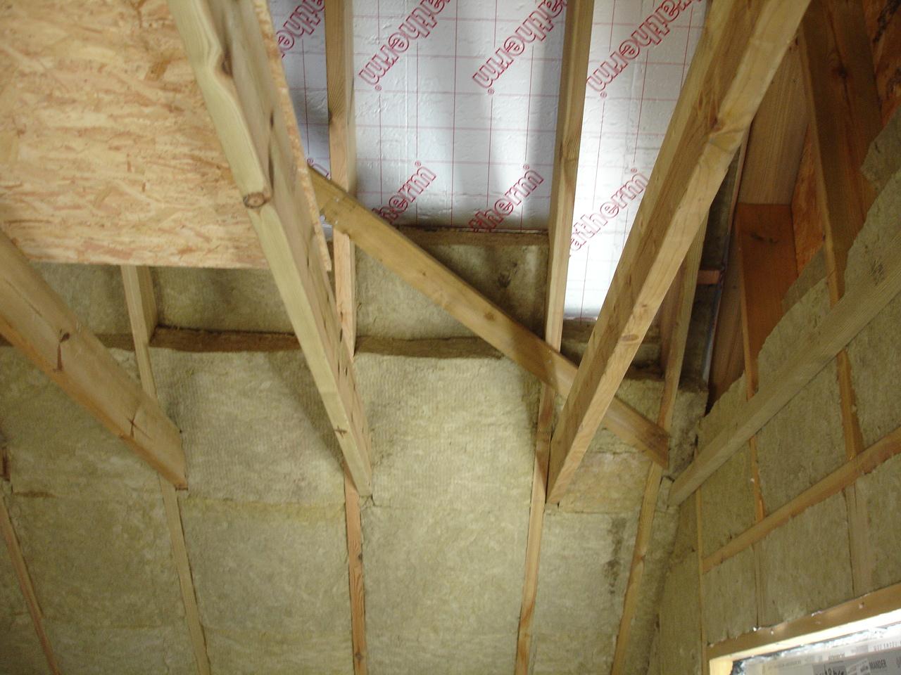

A bit late to reply, but make your own insulation saw!! Take an old standard wood saw and grind teeth on each side down, so it just has teeth and will cut through rockwool like butter!!
I would recommend the RWA45 packs. 100mm and 50mm always on offer online. Easy to cut to tight fit with insulation saw. I cut 2 pieces out of a 600x1200 and very small amount of waste. 2 layers of 100mm in between rafters will stay in place, no problem1

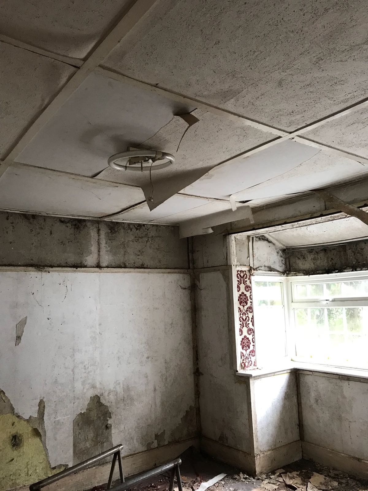

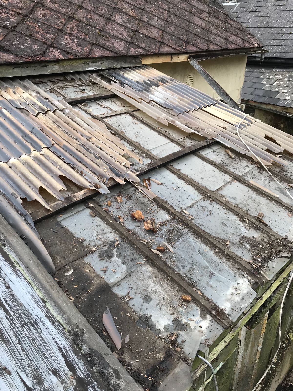

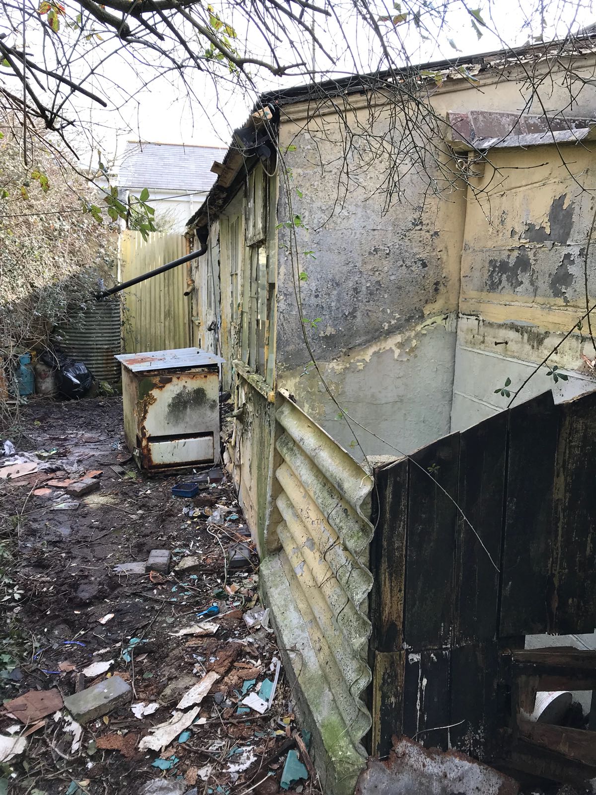

We had a 6 yard skip from local waste operator for stripping old bungalow, lined with a https://www.123bigbags.com/uk/asbestos-bags/asbestos-removal-bags-355x170x115?channable=4060eb6964003538320e&gclid=EAIaIQobChMIhsTV5_uz_gIVpO_tCh191Q5eEAYYASABEgJzUfD_BwE and paid for weight and haulage! Good quality masks and PPE and hosepipe running continuously, think about 3 ton in total. Recall about £1200.

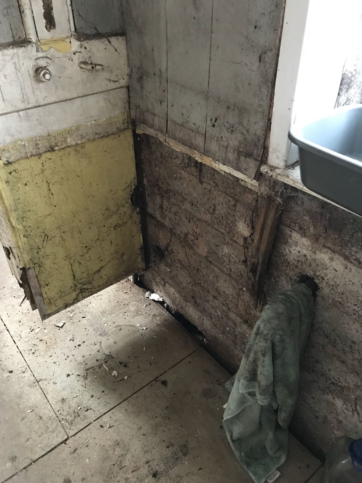

I sent the above pictures to valuation office and was told the bungalow did not qualify to be deleted for council tax. I eventually got valuation officer to visit, he took one quick look around and deleted the Bungalow from the purchase date! -
