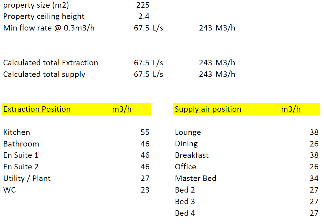

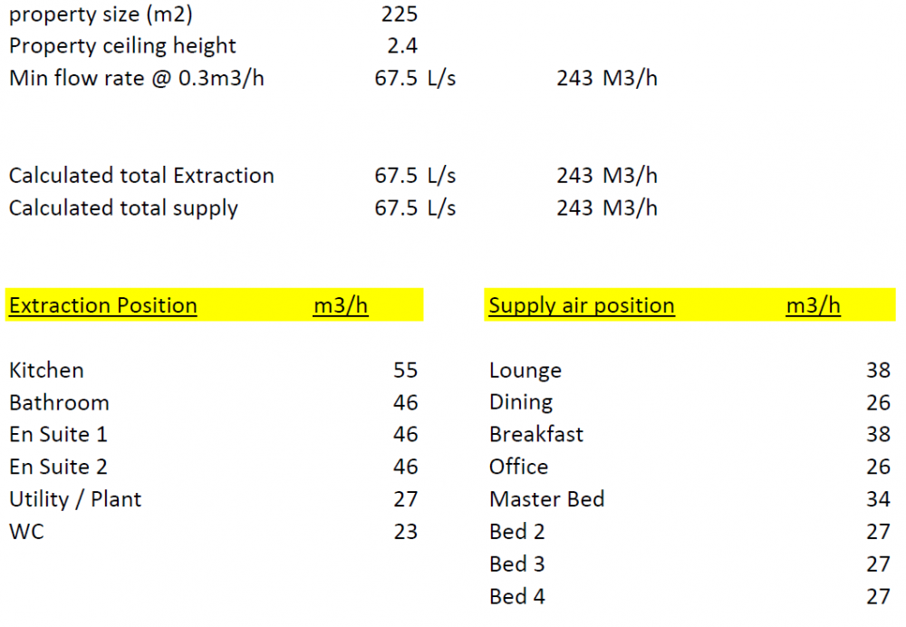

CC45 replied to john0wingnut's topic in Mechanical Ventilation with Heat Recovery (MVHR)
I've attached calcs for ours - done by BPC. I had the impression that as long as you are there overall with a bias towards more ventilation in bathrooms & kitchens then its OK. Kitchen is approx 0.5m3/hr with bathroom @ about 2m3/hr. Despite the ensuites being a fair bit smaller they still seem to get the same extract rate. I assume I've got it right... (all my notes are down the plot - not here). -
