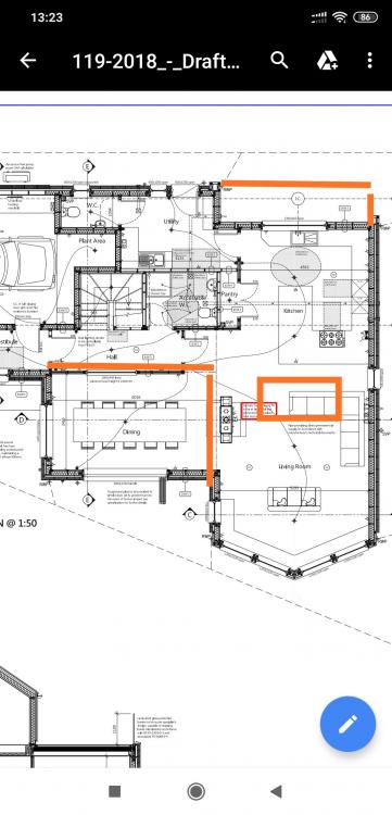

Mrs S Posted May 28, 2019 Author Posted May 28, 2019 On 27/05/2019 at 20:09, bassanclan said: The design is far too complicated to be brought in on a £1000/sqm budget. The architect has not understood your financial constraints at the start. With tweaks you might get a similar looking house at a lower cost, but would mean going back to planning etc. Expand Thanks, but our budget excluding what we paid for the plot is £1300-£1450/sqm
ProDave Posted May 28, 2019 Posted May 28, 2019 On 28/05/2019 at 06:53, Mrs S said: Thanks, but our budget excluding what we paid for the plot is £1300-£1450/sqm Expand I think the point we are all making is you won't build that house for your budget and sadly it looks like your architect has designed a house that cannot be built for the budget you set him. In any other business if you ask someone to design something that meets certain parameters and they designed something different you would have reasonable expectation to get redress somehow. I would be going back to the architect and saying "this was your brief, you failed" In our case I knew we had a small budget, so I designed a house that was just a rectangular box with few frills, and this will come in at about £1000 per square metre with me doing a LOT of the work myself. We don't have lots of different bits to the house, we don't have flat roofs with walk on balconies, we don't have acres of glass etc etc. I still think your way forward is simplify the house so you can afford to build it now, perhaps smaller than you really want, but designed such that you can extend it later to eventually get what you want.
Mrs S Posted May 28, 2019 Author Posted May 28, 2019 On 27/05/2019 at 17:46, Mr Punter said: A few points: The flat roof above the dining has not been designed with a fall and one is required. This may mean a step up to the balcony area from the hall. Price the terrace separately as it is likely to be very expensive once balustrade and paving is added. There is lots of East facing glazing to bed 1 so the sun will be there first thing (although in Scotland this is not a given). Curtains will be very hard to achieve and you may well get overheated in the morning. Unless you have mountains looking up I would go for normal windows or at least price them in comparison. Windows are much costlier than walls and far worse at insulating. Get the facing materials priced for comparison. I imagine the stone is fairly pricey so you could reduce it where the external fan units are. There seems to be some metal cladding, which can also be expensive. Look at any other local materials and get prices for these too. As per earlier, you could finish the roof in concrete tiles and save a fortune. Make the downstairs shower wheelchair accessible and fit the walls out for future grab rails, seat etc. Consider making it a wet room. Expand Sorry, what do you mean by a “fall”? There is going to be a slight step from the hall onto the balcony. This has already been passed by BW & planning. I understand where you are coming from regarding the large glazing, but we are directly on the coast and have a stunning view, hence why the windows have been designed as such. It’s possible to get blinds to suit your window shape, which should help with the early morning sun. We have taken the step to reduce our facing materials, and are putting it by planning to get the ok. Concrete tiles are a definite no go, we have to use slate, as we are in a conservation coastal area. We’ve already had to change our roof design, as it “wasn’t in keeping with the area” ? The downstairs shower room is already designed to be wheelchair accessible.

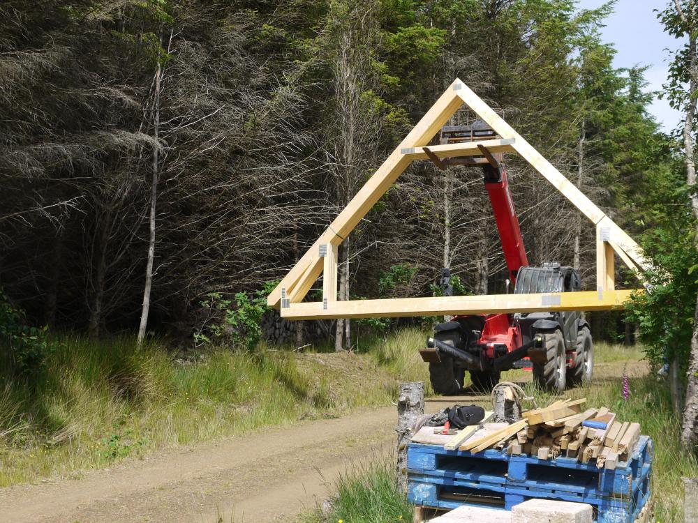

Jeremy Harris Posted May 28, 2019 Posted May 28, 2019 As a tip, we had blinds made to fit our front gable glazing. Be prepared for a hefty bill, as there are only a few companies who are able to make blinds to fit a gable and they are far from being cheap (think thousands, not hundreds). The blinds do nothing to keep the solar gain down, unfortunately, we needed to fit external infrared reflecting film to the windows to help reduce that, but the blinds do add privacy. With hindsight, we could have saved money by opting to fit smart glass to this elevation, as even though it would have cost perhaps £1000/m² for the glass, it would have been worth it overall. 1

Jeremy Harris Posted May 28, 2019 Posted May 28, 2019 On 28/05/2019 at 07:35, ProDave said: Our planners started on the "must be slate roof" tack, but I argued. Eventually they accepted Marley Edgemere Riven finish as a concrete tile that looks close enough to slate to be acceptable. Expand Ours were the same. They started off by saying they would only accept slate or hand made clay tiles. I fitted Ikoslate (recycled plastic made to look like slate) and they couldn't refuse as they weren't able to spot the difference between that and real slate. Anyway, their case was blown out of the water when I pointed out that the listed building opposite (which was being used to restrict what we could do) had a roof covered in old asbestos slate.

Bitpipe Posted May 28, 2019 Posted May 28, 2019 (edited) On 28/05/2019 at 07:08, Mrs S said: Sorry, what do you mean by a “fall”? There is going to be a slight step from the hall onto the balcony. This has already been passed by BW & planning. I understand where you are coming from regarding the large glazing, but we are directly on the coast and have a stunning view, hence why the windows have been designed as such. It’s possible to get blinds to suit your window shape, which should help with the early morning sun. We have taken the step to reduce our facing materials, and are putting it by planning to get the ok. Concrete tiles are a definite no go, we have to use slate, as we are in a conservation coastal area. We’ve already had to change our roof design, as it “wasn’t in keeping with the area” ? The downstairs shower room is already designed to be wheelchair accessible. Expand A fall is the angle built into a flat roof (usually 15%) that enables rain water to flow off it to a gutter. If it's completely flat then you'll just have a big puddle. The fall means that if you want to use it as a balcony, you need to install a deck over it that is level - we did this on two small balconies (1m x 3m) and it cost about £5.5k supply & fit inc glass (ex VAT) for both together. Edited May 28, 2019 by Bitpipe 1
