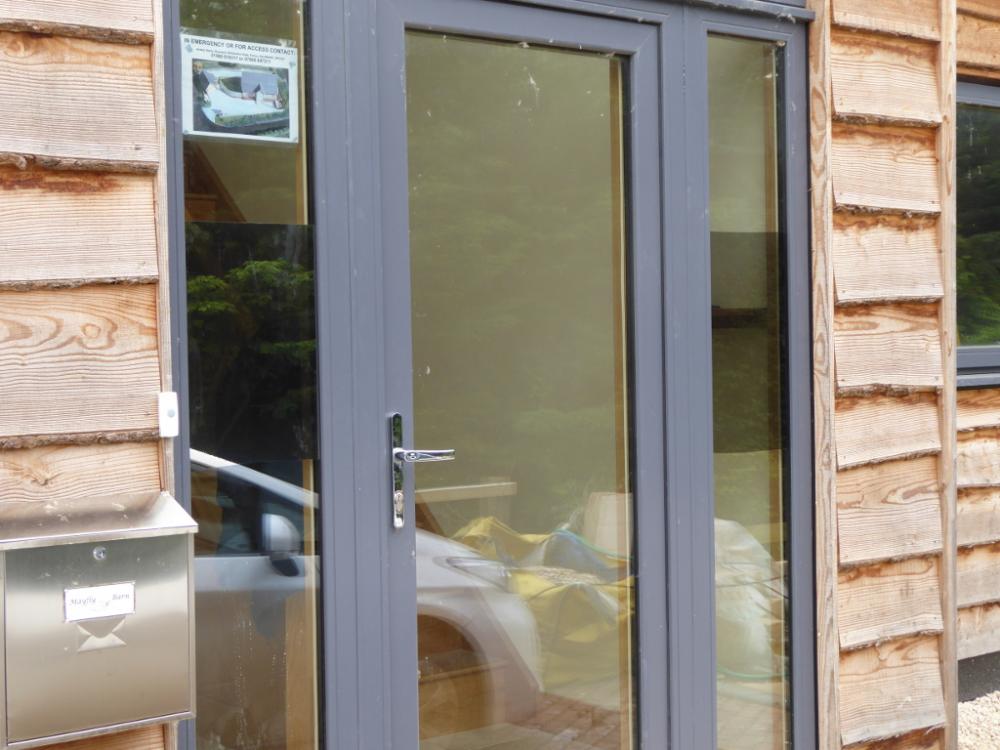

Jeremy Harris Posted June 10, 2016 Share Posted June 10, 2016 The chap's just left, having stuck a couple of samples on to the glass so we (well, more like SWMBO) can choose which we prefer. I have a sample of the Sentinel Plus Stainless Steel, which wasn't one I was interested in as in photos it looks very reflective. However, when stuck on the glass it looks less reflective than the plain glass; the advertising images are very deceptive. I also have a sample of 3M Prestige on the other side, a non-reflective, non-metallised, multi layer film than lets more light through than the Sentinel Plus. TBH, from inside the house you can barely notice either film visually, even though they are just squares stuck on to the windows. The Sentinel Plus is slightly darker looking, whereas the 3M Prestige is a bit lighter, and in terms of privacy the Sentinel Plus is definitely better. It's very hard to photograph this stuff, but here's a photo taken a short time ago from outside. The Sentinel Plus is on the left, the Prestige on the right: And here's a view from inside, with the Sentinel Plus on the right (please excuse the dirty windows - the whole house needs a damned good clean!): Link to comment Share on other sites More sharing options...
