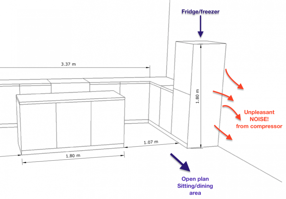

Dreadnaught Posted April 9, 2019 Posted April 9, 2019 (edited) Open plan kitchen. How could I reduce the noise of fridge freezer's compressor (while keeping the back of the fridge ventilated of course)? Ideas: A short stud wall section beside the fridge freezer? Sound-absorbent foam behind Any better ideas? (By the way, ignore the kitchen design. Its just a rough draft.) Edited April 9, 2019 by Dreadnaught
Ralph Posted April 9, 2019 Posted April 9, 2019 Soundproofing aside and assuming there is nothing actually wrong with your fridge a fairly simple thing is to make sure your fridge is completely level.
Moonshine Posted April 9, 2019 Posted April 9, 2019 Is the fridge not integrated anyway rather than free standing, and going to be box, and have an end panel to hide the side and rear of the fridge? the mass of end panel should be enough rather than a whole stud wall. 1
Dreadnaught Posted April 9, 2019 Author Posted April 9, 2019 2 minutes ago, Moonshine said: Is the fridge not integrated anyway rather than free standing, and going to be box, and have an end panel to hide the side and rear of the fridge? the mass of end panel should be enough rather than a whole stud wall. I should have explained that the house is not built yet. I am working on the plans so I can do whatever is best to minimise the noise. I was thinking that there might be a solution for acoustic insulation that was superior to usual thin kitchen panels. What might you recommend? By the way, I don't plan to have a build-in a fridge-freezer, with a front panel to blend in with the other kitchen doors. I have always thought that was somewhat pointless as many modern fridges looks good without, especially the stainless steel ones.

ProDave Posted April 9, 2019 Posted April 9, 2019 The problem with "buy a new fridge" is how do you know how noisy it was. The LG double door "American" FF in our last house proved to be the quietest FF we have ever owned. That was luck, not judgement. In the new house SWMBO did not want anything that big but when we looked most upright FF's (one above the other) were too small. We ended up with a Becko FF because it was 700mm wide and had quite a bit more space than the majority that were 600mm or less wide. There really was not much choice. Let alone then being able to choose the quietest one in that format. As it happens it is disappointingly noisy. It is in the "kitchen / family room" and now sits alongside a bit of projecting stud wall next to it that has quietened it a bit. This just reinforces my view that open plan rooms incorporating a kitchen are a very bad idea. I am now very glad we have the other living room available away from the noise of the FF, the dishwasher, the fan oven, and the extractor hood. Kitchens are WORK rooms, not relaxing rooms.

Dreadnaught Posted April 9, 2019 Author Posted April 9, 2019 (edited) Thanks all. Interesting about the new compressor technology, @epsilonGreedy. Didn't know about that. I will certainly be choosing as quiet a one as I can find. Back to the original question — how best to build a housing for a fridge-freezer that allows air circulation but muffles noise? I like @ProDave's idea of a stud wall. Any other ideas? Edited April 9, 2019 by Dreadnaught
Ferdinand Posted April 9, 2019 Posted April 9, 2019 Change your wall finish behind and beside the fridge to be absorbing.
