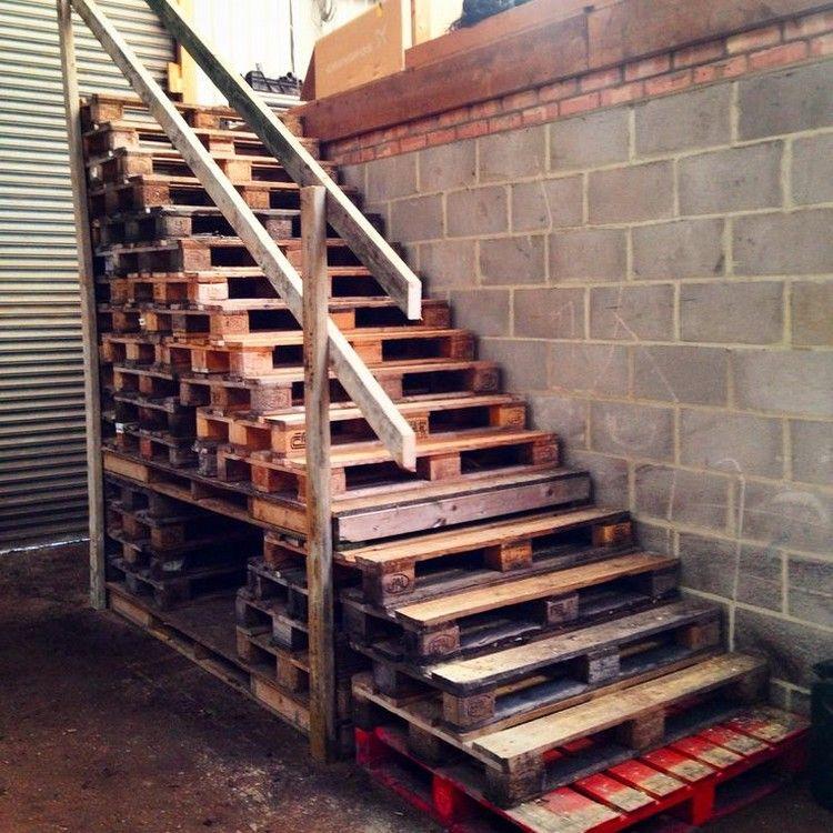

ToughButterCup Posted January 18, 2019 Posted January 18, 2019 I need some temporary stairs. And I have a huge pile of pallets. See where this is going yet? And then I bumped into this. And I have enough lead in my pencil to do it this weekend . But caution suggests I ask the commentariat for comment first

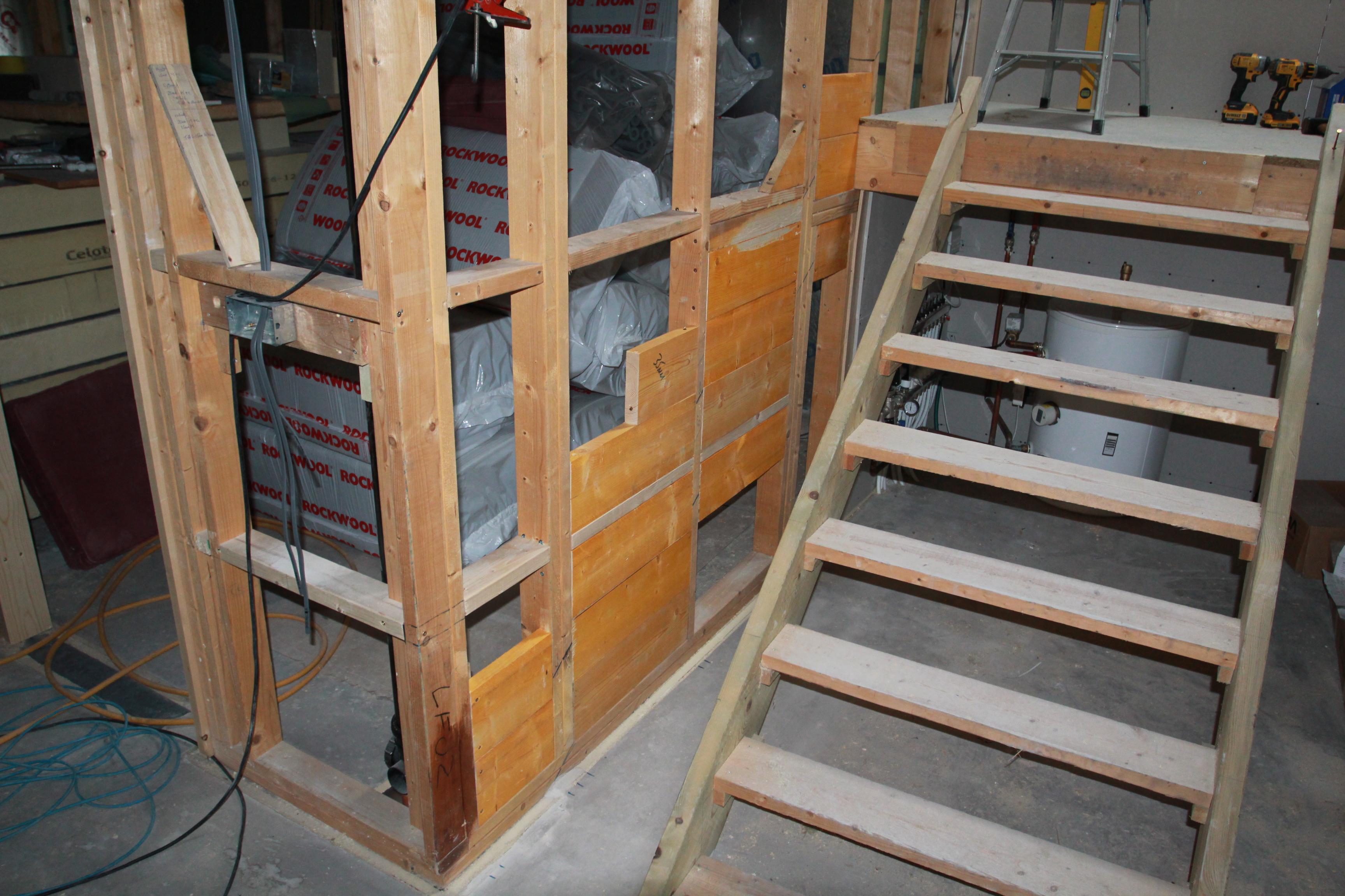

Pete Posted January 18, 2019 Posted January 18, 2019 Got some wood for £60 and made mine. They need to be solid as you will be carrying a lot of heavy stuff up them.

newhome Posted January 18, 2019 Posted January 18, 2019 Noooo! Too risky. Your neck is worth more than the couple of hundred quid for a Stairbox one. Please don’t!

ToughButterCup Posted January 18, 2019 Author Posted January 18, 2019 4 minutes ago, newhome said: Noooo! Too risky. [...] I like controlling risk down to acceptable levels. And I have a huge pile of waste wood. And ever dwindling piggy bank.
newhome Posted January 18, 2019 Posted January 18, 2019 Define acceptable. Risking your neck ain’t an acceptable risk IMO ?. Use the wood on another day. Have a look on fleabay or gumtree to see if someone is getting rid of an old one although the transport might be a PITA.
nod Posted January 18, 2019 Posted January 18, 2019 40 minutes ago, recoveringacademic said: I need some temporary stairs. And I have a huge pile of pallets. See where this is going yet? And then I bumped into this. And I have enough lead in my pencil to do it this weekend . But caution suggests I ask the commentariat for comment first Bloody hell Ian Just burnt ours As Jacks says It’s not worth the hassle 100 quid for a straight flight Easy to move out of the way
ToughButterCup Posted January 18, 2019 Author Posted January 18, 2019 4 minutes ago, newhome said: Define acceptable. [...] Wot Debbie says. Risk appetite varies, and since I'm operating outside CDM2015 (because this is pure DIY - nobody else will be using then) and I have a huge incentive to stay fit, I expect the risk to be as low as using normal stairs or lower. @nod well I won't be burning mine.... ?

Mr Punter Posted January 18, 2019 Posted January 18, 2019 If they are the heavy duty Euro Pallets - all the same size - it might be doable by stacking 2 per tread, fastening with long timber screws and supporting mid way from the ground. This construction would weigh about 400Kg and represent a significant trip and fire hazard.

Pete Posted January 18, 2019 Posted January 18, 2019 33 minutes ago, recoveringacademic said: You mean you made them from CLS and ply? No, i bought two lengths of 8 x 2 for the strings and then made the steps out 6 x 2. If the wood is bent, warped twisted I always get the price reduced and cut it up and use it in small pieces. When I dismantle them will use wood for shelving in the garage

Gone West Posted January 18, 2019 Posted January 18, 2019 Certainly not the best but lasted me six years and cost nothing as surplus 4"x2".
Onoff Posted January 18, 2019 Posted January 18, 2019 Stacked pellets......aka a Fireworks Night bonfire ready to happen as alluded to above. A LOT of dry wood with a lot of air gaps to fan any flames. I still might have the CAD drawing for the jig but it's router specific.
joe90 Posted January 18, 2019 Posted January 18, 2019 Actually I would use the pallets, stacked they are very solid and simple to add a handrail. But I am very tight ?.
