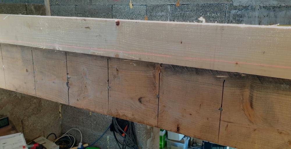

I was glad I didn't do a final check  for level when I stopped working on the mezzanine joists last night. I would have had another really bad nights sleep.

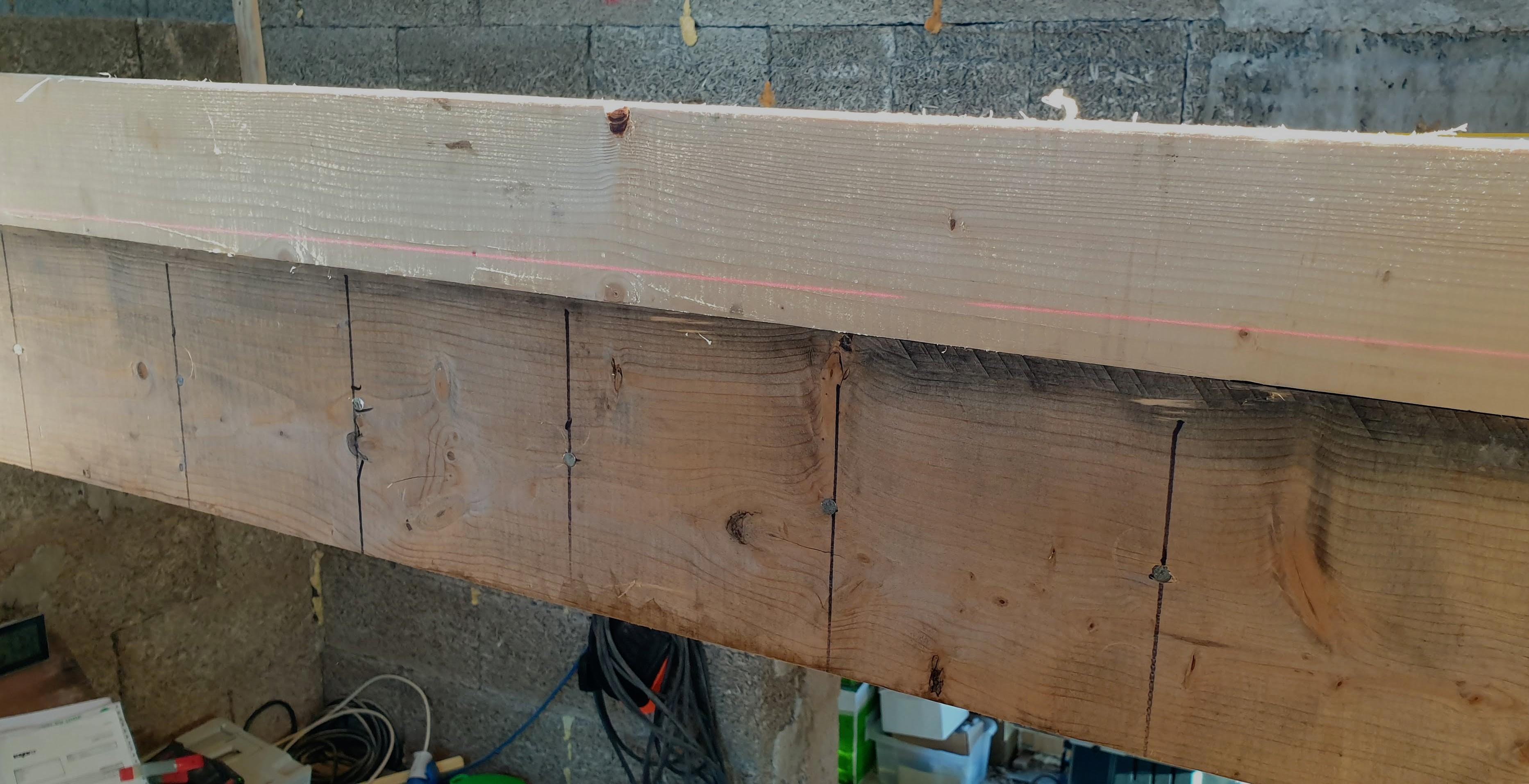

Look at this.... this is how un-level  I managed to nail the joists hanger: no, the red laser line isn't disappearing to infinity, it's 30mm out at one end and 0 on the other - over 2 meters
For those of you wondering what self-build does to you - it makes you tired enough to make significant - and sometimes costly- errors

But no, I had to hammer home 24 nails on the joist hanger with one end of the joist 30mm too low.
In the cold light of day it beggars belief .
The remedy?
Make a 2 meter long stealer piece (wedge) : half a day's work
Or just pack the end of the support beam up by 30mm! Job done!
