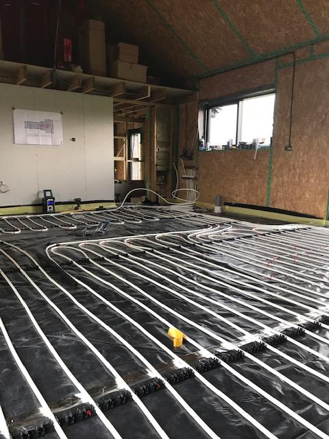

Nestor Posted November 22, 2018 Posted November 22, 2018 I have just fixed 1200 metres of UFH pipe on the ground floor , screeders booked for next week. I would recommend doing the studwork first for all designated rooms with their own zone. For the kitchen I measured and marked where the island and units will sit after screed applied.

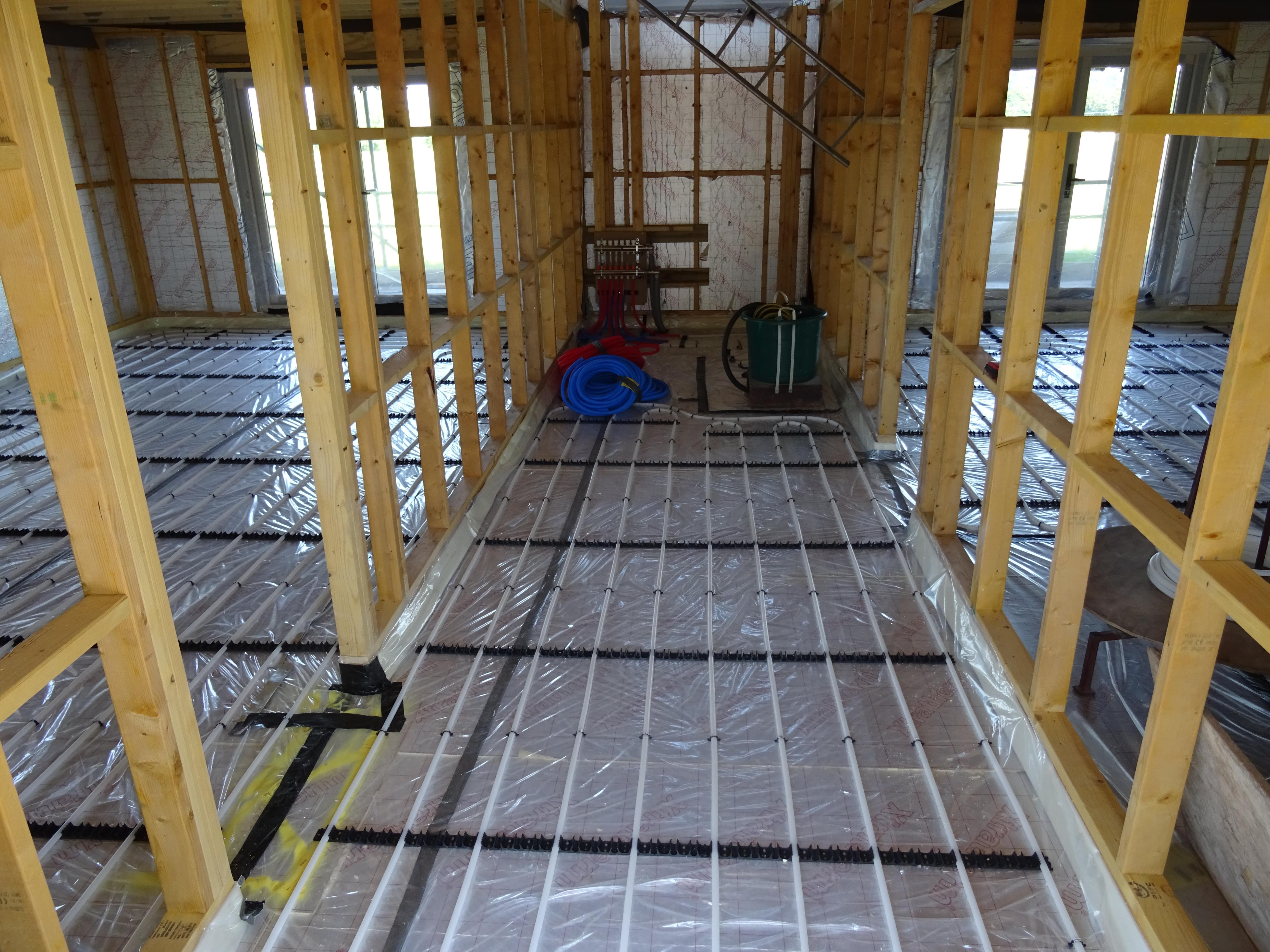

Redoctober Posted November 22, 2018 Posted November 22, 2018 Our studs went in first and we even glued one set of studs as this was fitted after the screed was poured. You will see from the images, the bottom of the studs are protected and the manifold is already in place. Hope this helps. 1

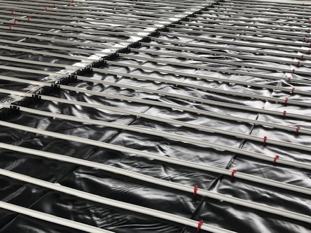

TerryE Posted November 23, 2018 Posted November 23, 2018 7 hours ago, nod said: Always studs first This is a safe and conventional solution, but with the usual hassles of laying the screed on a per room basis which induces level issues etc. Quite a few of us have gone for a single-slab approach which requires a more competent crew and tighter quality standards -- which is probably an ask too far for most builders. See @Stones and @JSHarris blogs for examples of this approach used successfully. In my case the upside was that the entire slab was flat to within a few mm over 11m, and was cheaper too. But either way you really need to have your floor plan fixed and accurate to ~1cm IMO, and that includes where your doorways and any fitted units and cupboards are going to go. Any variations as @Russell griffiths says will need to rely on gluing. @Redoctober, I am not sure why you took your pipe runs so close to the room boundaries . For example in your hall I would have stuck with 9 instead of 10 runs. Your wallside runs look about 50mm from the CLS. By the time that you've boarded up and fitted the skirting your it looks like your carpet fitter will be nailing his gripper rods in directly over the pipe runs. Maybe you should consider using adhesive grippers 1

TerryE Posted November 23, 2018 Posted November 23, 2018 2 hours ago, PeterW said: or you need both a flow and return...... Durrhhhh, up too late. But still, ending up with the outside runs so close to the wall is asking for trouble, IMO. I would keep it to an absolute minimum of 100mm, even if you move runs over 1 click.

Redoctober Posted November 23, 2018 Posted November 23, 2018 16 hours ago, TerryE said: I am not sure why you took your pipe runs so close to the room boundaries . For example in your hall I would have stuck with 9 instead of 10 runs. Your wall side runs look about 50mm from the CLS. By the time that you've boarded up and fitted the skirting your it looks like your carpet fitter will be nailing his gripper rods in directly over the pipe runs. Maybe you should consider using adhesive grippers Rest assured @TerryE the floor area in the middle section and to the right are being laid with stone tiles, so no problems in that regard. As for the floor are to the left, that will be carpeted and our UFH installer was aware of this. We were more than happy with the spacing as it was more generous than it appears. As for 9 runs instead of 10, I can't really comment other than the installer knows more about this sort of stuff than me and if he felt it needed 10, then who am I to argue. But I suspect @PeterW is correct with his suggestion. 8 hours ago, PeterW said: ... or you need both a flow and return......

Conor Posted November 17, 2020 Posted November 17, 2020 On 22/11/2018 at 21:36, Redoctober said: Our studs went in first and we even glued one set of studs as this was fitted after the screed was poured. You will see from the images, the bottom of the studs are protected and the manifold is already in place. Hope this helps. What are you studs built up on? Concrete sub-floor? Mind sharing the details?
