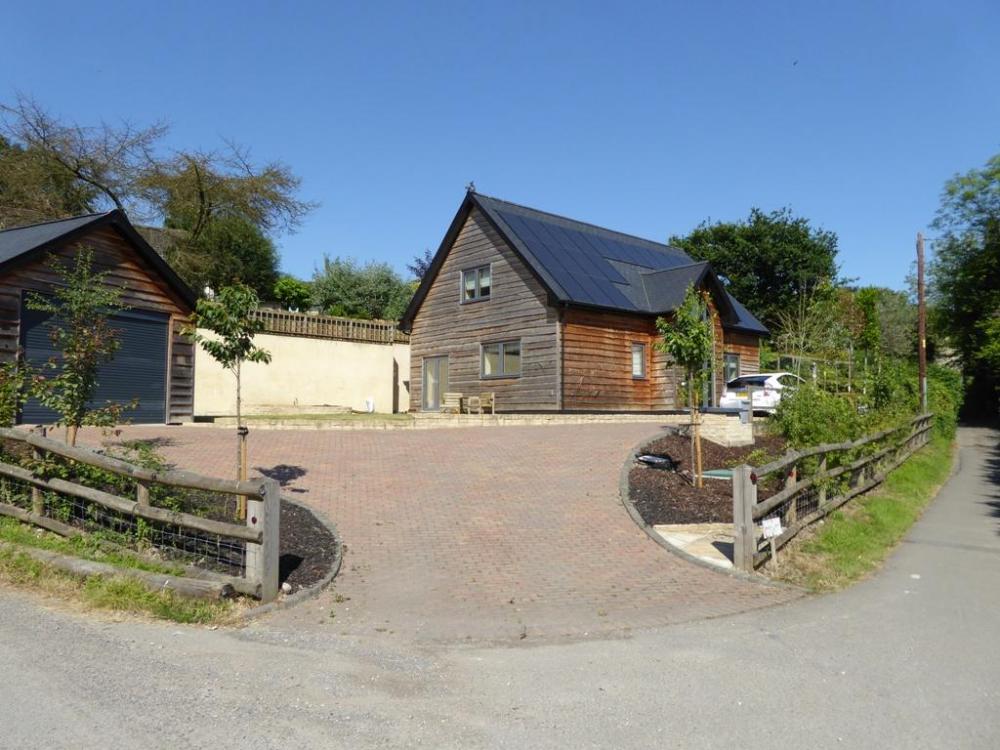

Onoff Posted November 12, 2018 Share Posted November 12, 2018 No vested interest here whatsoever but I can confirm, having visited @PeterStarck's house that UFH is not really required. Might have something to do with his meticulous attention to detail on the build where it counts and the fact his air tightness beats the regs by a factor of something like x4. The sprayed icynene insulation too. 1 Link to comment Share on other sites More sharing options...
Gone West Posted November 12, 2018 Share Posted November 12, 2018 @scottishjohn We don't have UFH and use electric towel rails in the bathrooms as our main source of heat. We also have warm air through the MVHR system. The U factor for PH walls and roof has to be less than 0.15W/m2K. The U factor for my walls and roof are 0.095W/m2K, which along with good airtightness, is what contributes to the fact that I don't need UFH . I live in the south of England near the coast which is another reason I can keep my house warm without UFH. I found it very useful to play around with the PHPP using different U factors, glazing and weather data to come up with the the best wall and roof construction. My blog has all the gory details. Good luck with your project. Link to comment Share on other sites More sharing options...
Onoff Posted November 12, 2018 Share Posted November 12, 2018 1 minute ago, PeterStarck said: @scottishjohn We don't have UFH and use electric towel rails in the bathrooms as our main source of heat. We also have warm air through the MVHR system. The U factor for PH walls and roof has to be less than 0.15W/m2K. The U factor for my walls and roof are 0.095W/m2K, which along with good airtightness, is what contributes to the fact that I don't need UFH . I live in the south of England near the coast which is another reason I can keep my house warm without UFH. I found it very useful to play around with the PHPP using different U factors, glazing and weather data to come up with the the best wall and roof construction. My blog has all the gory details. Good luck with your project. I forgot @scottishjohn was in the Arctic! Out of interest how would your build fare up North? At what point doesn't it "work"? Link to comment Share on other sites More sharing options...
Gone West Posted November 12, 2018 Share Posted November 12, 2018 Just now, Onoff said: I forgot @scottishjohn was in the Arctic! Out of interest how would your build fare up North? At what point doesn't it "work"? Quite honestly I don't know because I only used weather data for this site. It would depend on the general weather data for the area and the openness of the site. Link to comment Share on other sites More sharing options...
