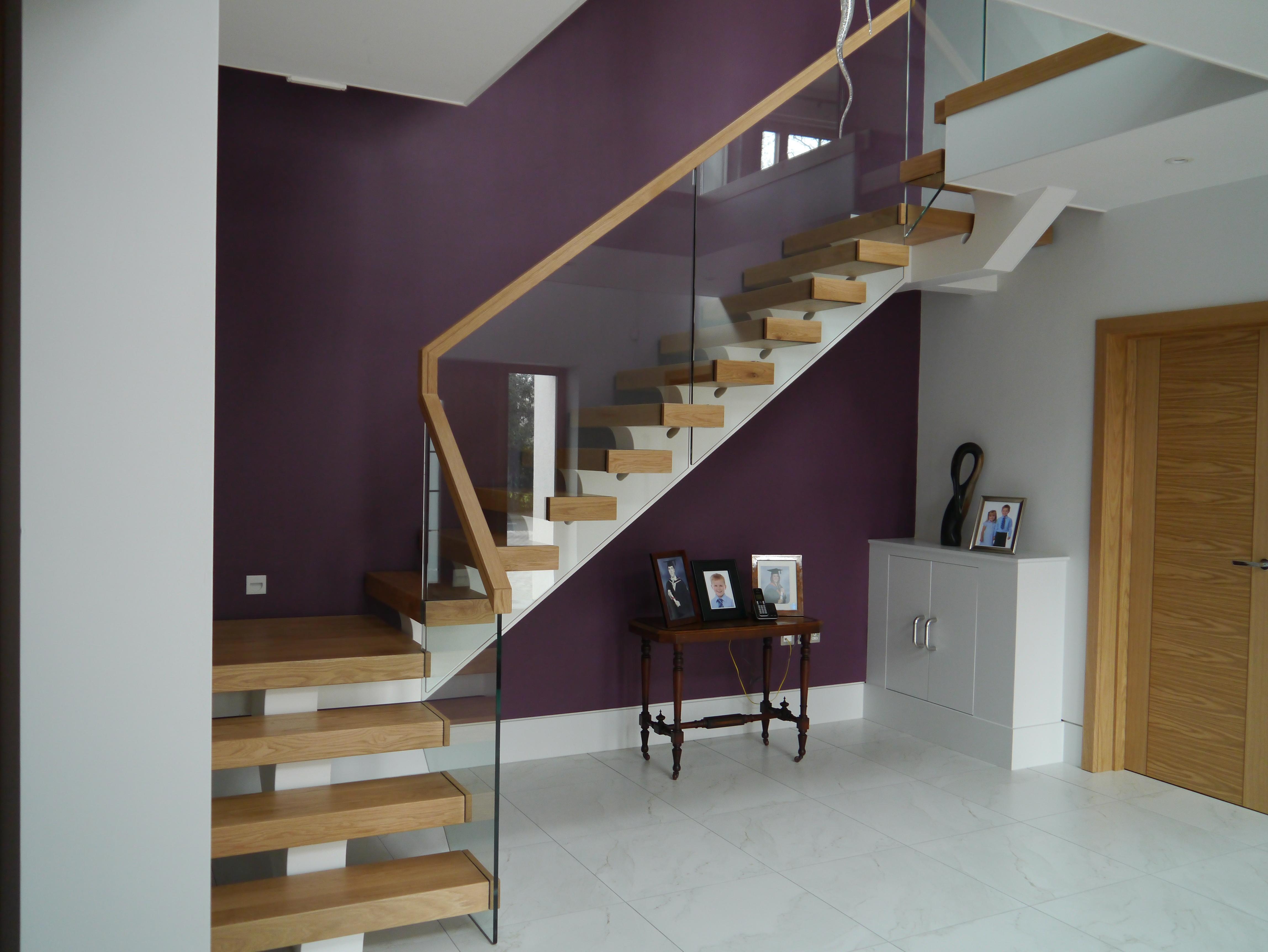

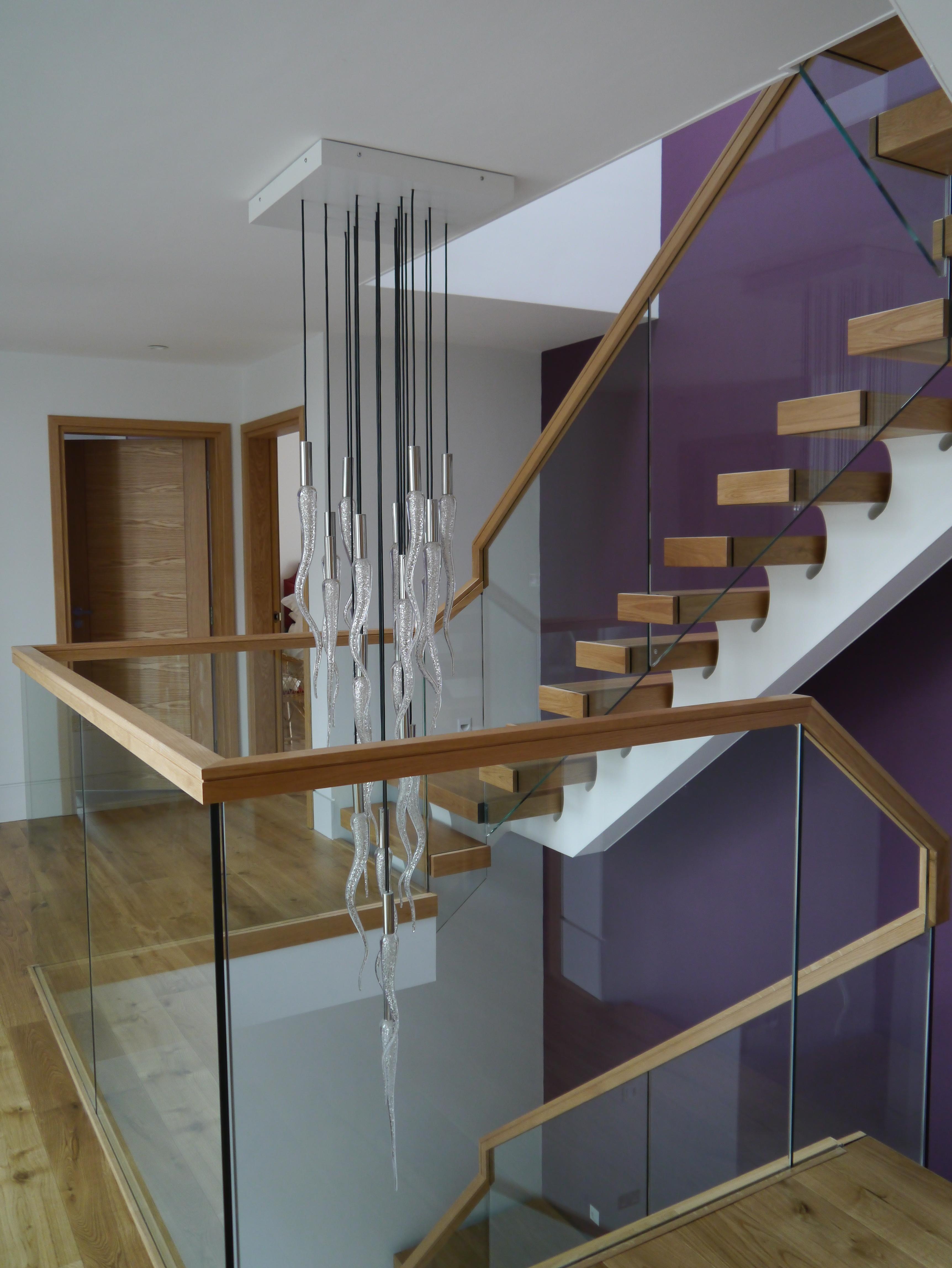

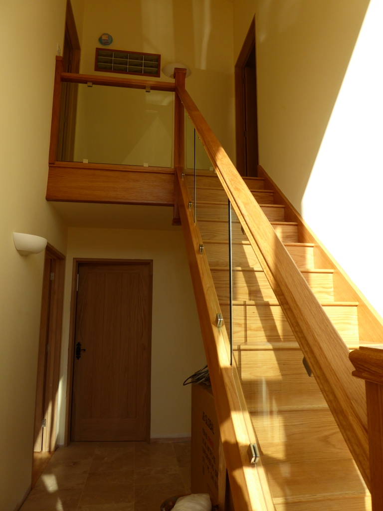

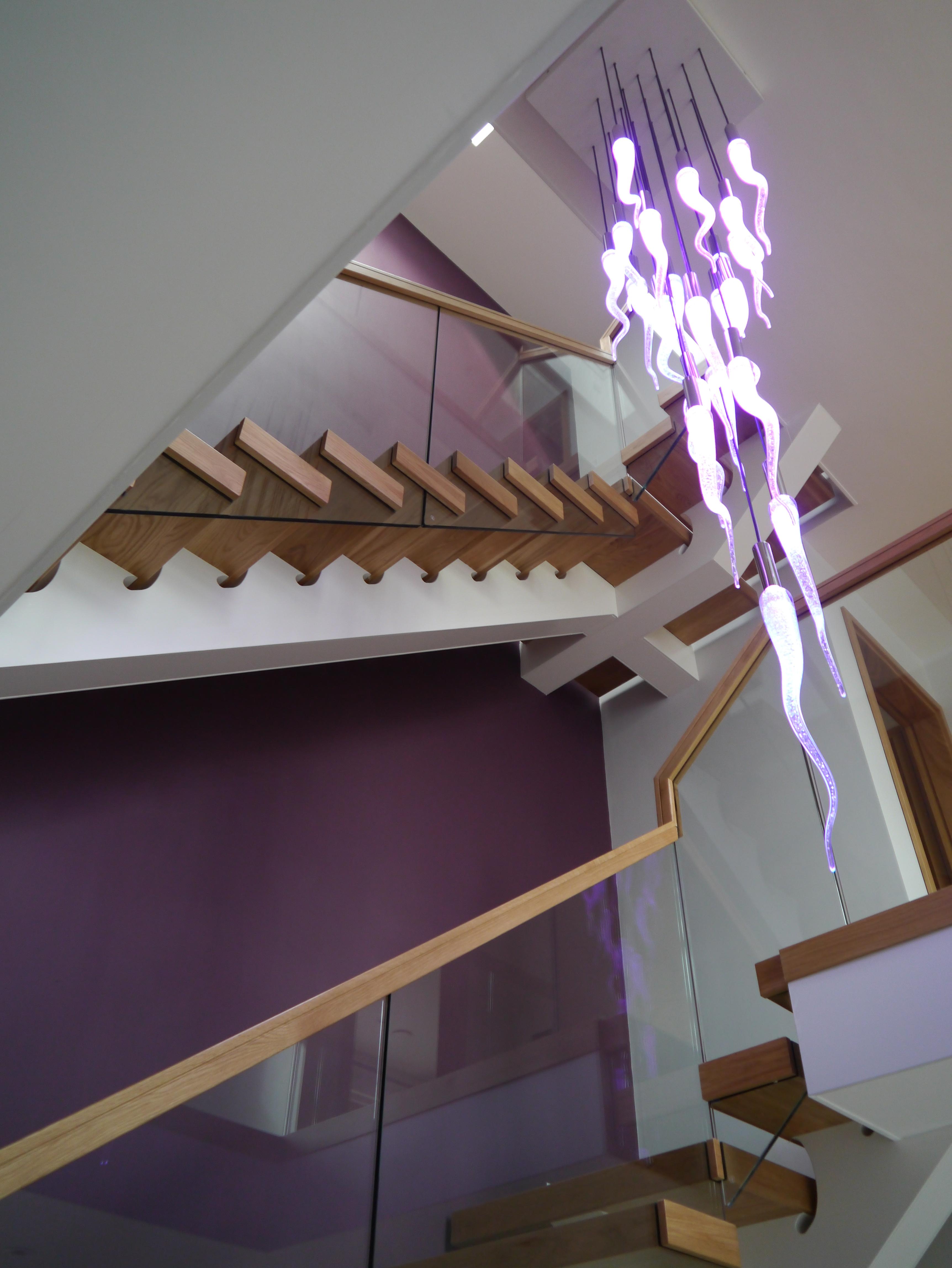

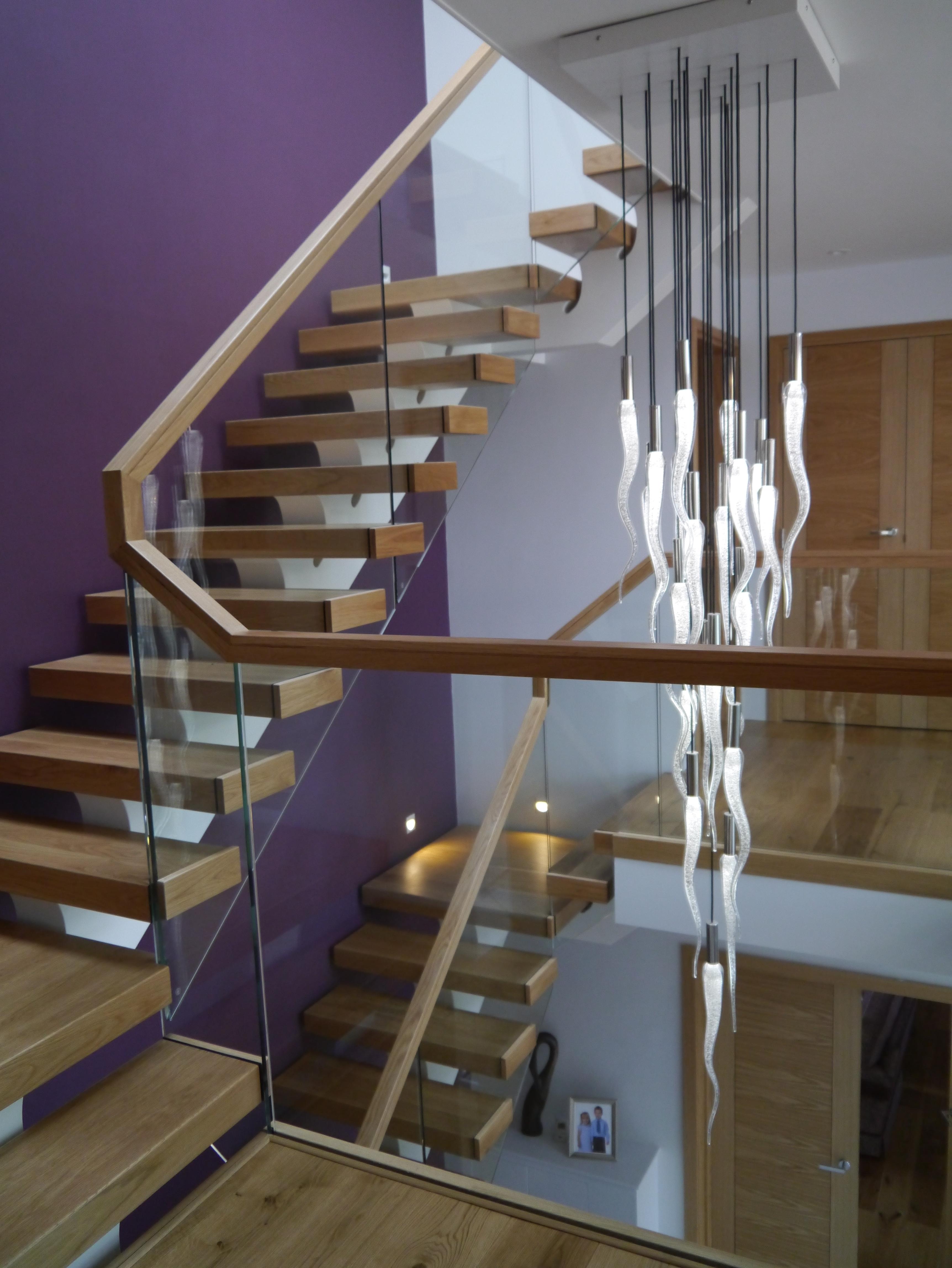

HerbJ Posted October 29, 2018 Share Posted October 29, 2018 Our stairs were designed and manufactured by a specialist stair manufacturer in Dublin - Jea Stairs, Colin Walsh. colin@jea.ie - see www.jea.ie, The stairs were all assembled in the works, for acceptance, diassembled and shipped to the UK, with the glass balustrades delivered separately. They did a great job and Colin was very helpful. with practical advice and support. I attach a few photos 8 Link to comment Share on other sites More sharing options...

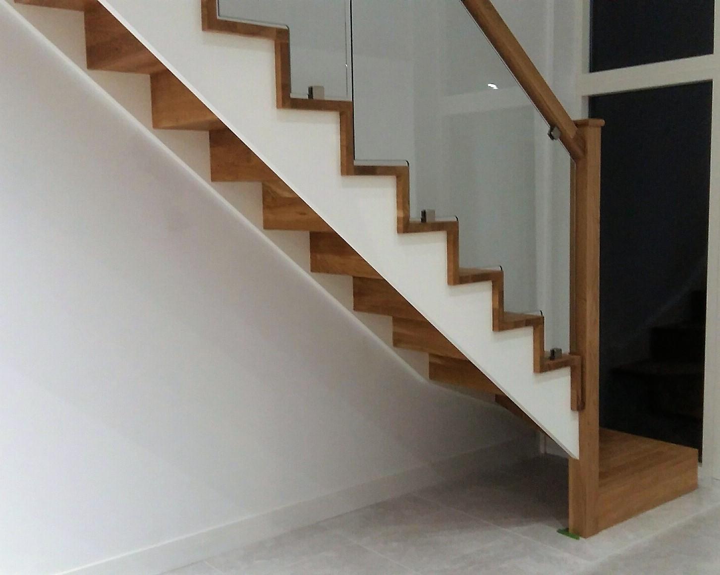

Roundtuit Posted October 29, 2018 Share Posted October 29, 2018 Still finishing painting mine: oak treads and risers, softwood strings and glass balustrade. This was the best compromise between style and cost I could find: It's a stairbox design, rock solid, and a third of the price of the steel/oak/glass design on my original wish list. 1 Link to comment Share on other sites More sharing options...

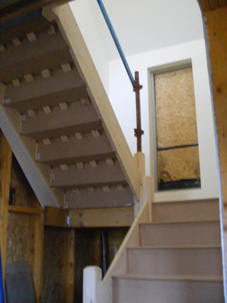

ProDave Posted October 29, 2018 Share Posted October 29, 2018 These are mine from Stairbox, they must be the most basic you can get. The stringers will be varnished (have been now but not photographed) and they will be carpeted hence the mdf / ply treads. Note the dwarf newel posts ready for the fusion system handrails I linked to before. Link to comment Share on other sites More sharing options...

HerbJ Posted October 29, 2018 Share Posted October 29, 2018 My stairs are on the oak & glass end of your spectrum but JEA Stairs do all sorts of stairs - the stairs in their manufacturing facility are beechwood ply = and would be well worth talking to for something special in more economic materials. They have a CNC machine so can manufacture to high standards. Link to comment Share on other sites More sharing options...

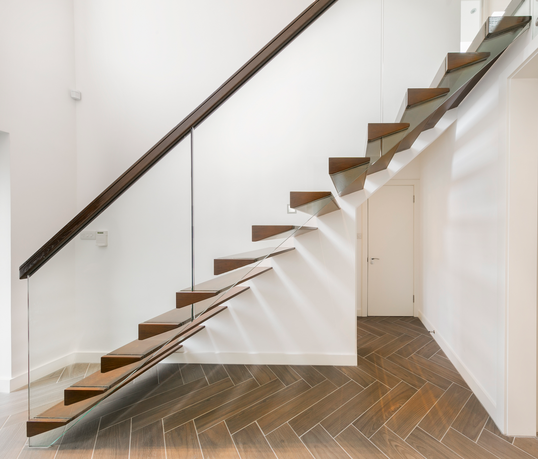

Simplysimon Posted November 3, 2018 Share Posted November 3, 2018 too modern for me, however, i really like these. i like the way they change shape as you look upwards Link to comment Share on other sites More sharing options...

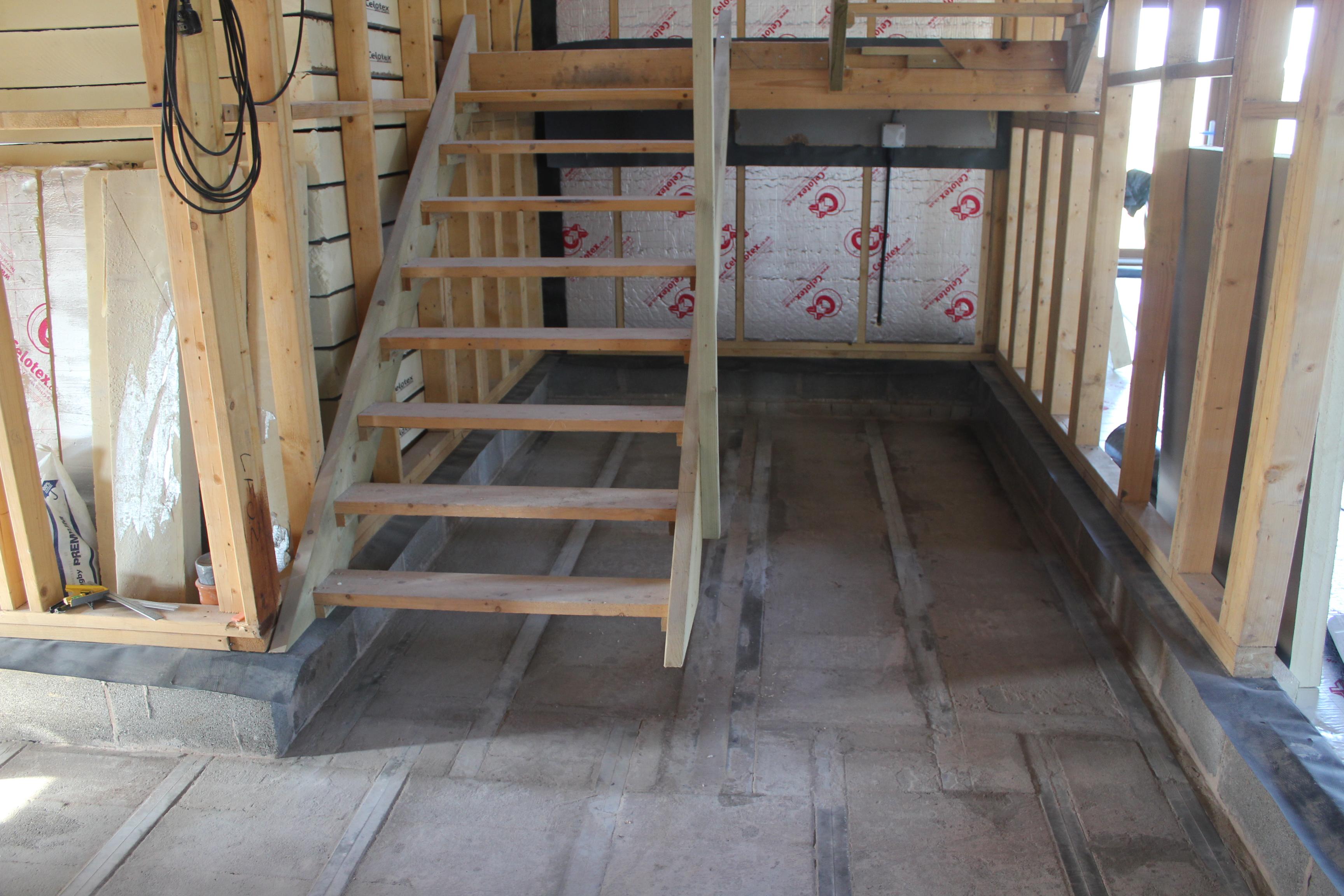

Weebles Posted November 6, 2018 Share Posted November 6, 2018 27 minutes ago, CC45 said: I'm going to fit ours towards the very end. Not going to risk it getting trashed. We've got a home made temp one at the minute. How did you make your home made temporary one? Any photos? Link to comment Share on other sites More sharing options...
CC45 Posted November 6, 2018 Share Posted November 6, 2018 I just bought some 6x2 - cut them to length. Screwed some timber pieces on them in parallel to the floor and then screwed some 6x1.5 on as treads. No risers. All screwed into our timber frame. Nothing fancy at all but they are solid and easy to move up and down. Not that proud of them that I took any pics! - hang ed found one: Link to comment Share on other sites More sharing options...

Weebles Posted November 6, 2018 Share Posted November 6, 2018 @CC45 They look mighty fine. I think I would be proud of them. Is your half way platform the permanent one or a temporary fix too? We have a similar stairwell so standard temporary staircases (straight ones) don't fit too well. You might just have inspired me to build some stairs......we have some timber kicking around. Link to comment Share on other sites More sharing options...

CC45 Posted November 6, 2018 Share Posted November 6, 2018 Half way platform is permanent but easy enought to knock up anyway. Few hours to make - an ideal evening job. These have been in service for 3 years and all ok. Make sure the gaps are even all the way. GFI Link to comment Share on other sites More sharing options...

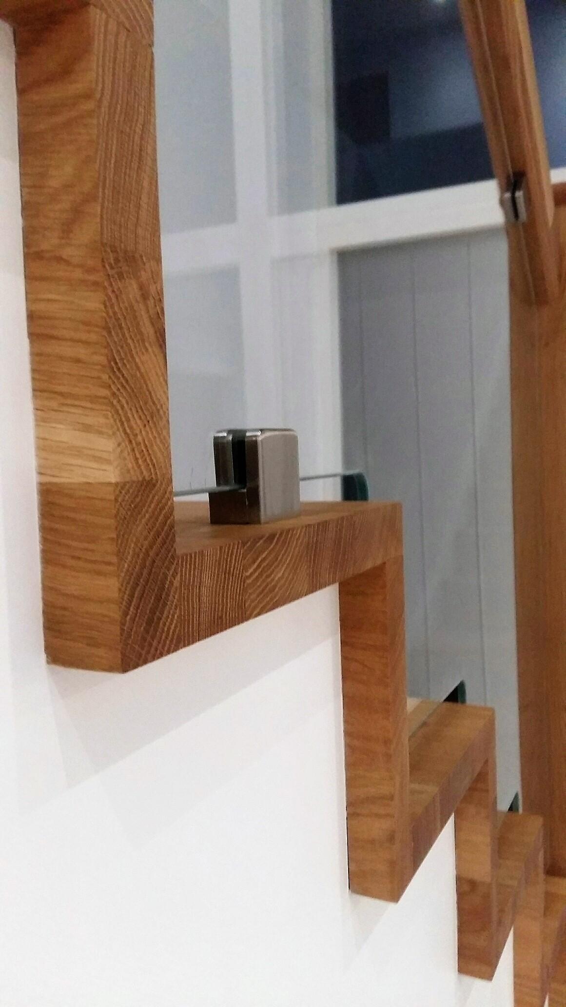

eandg Posted July 1, 2023 Share Posted July 1, 2023 On 29/10/2018 at 18:53, Roundtuit said: Still finishing painting mine: oak treads and risers, softwood strings and glass balustrade. This was the best compromise between style and cost I could find: It's a stairbox design, rock solid, and a third of the price of the steel/oak/glass design on my original wish list. That looks great. We are currently designing on Stairbox and had been looking at something similar to this: How do you set it up with the cut stringer like you have and spec the overhang (it might be that's only possible with closed risers)? On a related note, has anyone used Stairbox and required a landing? We're needing a halflanding c. 2100x100 and want it to match the stairs as closely as possible. Link to comment Share on other sites More sharing options...
Roundtuit Posted July 1, 2023 Share Posted July 1, 2023 57 minutes ago, eandg said: That looks great. Thanks! I didn't use the design tool, they did the design from dimensions. I think it was what they call the ClearCut design. I had several phone conversations with them; definitely worth giving them a call to explore options but I don't think a half-landing will be a problem. Link to comment Share on other sites More sharing options...
