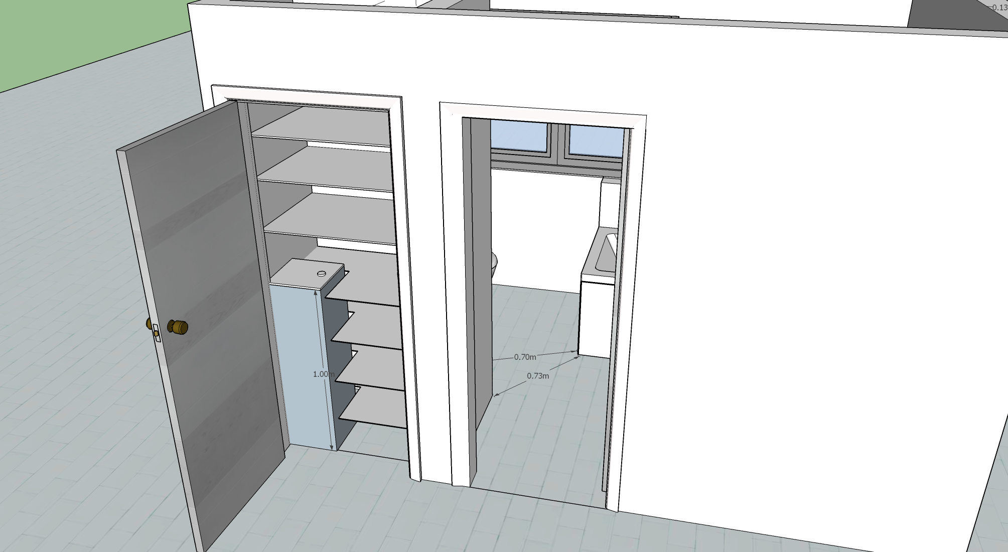

PeteTheSwede Posted October 7, 2018 Share Posted October 7, 2018 Hi all As part of a major renovation I'm thinking about including a laundry chute from the airing cupboard on the first floor into the ceiling of the utility room directly below. At this point the chute will empty into a laundry basket sitting on a worktop in the Utility. I've been looking at these guys https://www.laundrychutes.co.uk/smartchutelaundrychute.htm#datasmartchute The smart chute is a 25cm diameter flexible tube, and for £600 inc VAT they give you 2m of it, with a stainless steel to make the bit that sticks into the ceiling of the utility room a bit more attractive, and a 30 min fire rated door. The door isn't particularly attractive but it doesn't matter to me as it will be inside the airing cupboard. The chute needs to be boxed in in 9mm plasterboard for fire protection, up to 1m above the floor (to avoid small children climbing in) and can go through a 27cm hole in the floor. This currently seems doable but would be grateful if anyone had experience of this kind of thing and might point out something I've not considered. There's not much discussion on here about laundry chutes. Thanks in advance Peter Link to comment Share on other sites More sharing options...

Mr Punter Posted October 7, 2018 Share Posted October 7, 2018 Looks to me that you will lose a fair bit of space in the airing cupboard and the room below. You still need to get the stuff to the airing cupboard and then carry it back up to the bedrooms. Unless the stairs are a very long way this seems fairly pointless. Link to comment Share on other sites More sharing options...
PeteTheSwede Posted October 7, 2018 Author Share Posted October 7, 2018 The dirty washing currently gets lobbed down the stairs, and sits in a pile at the bottom. This way it can get thrown directly into a wash basket in the utility room... The airing cupboard is close to the bedrooms upstairs so is easy to get to. You obviously do sacrifice space in the airing cupboard, but that's only a 30cm square box in the airing cupboard, and still leaves enough of space i think. As for the utility room, I don't think it will take any more room than a pile of dirty washing would anyway. Link to comment Share on other sites More sharing options...

PeteTheSwede Posted October 9, 2018 Author Share Posted October 9, 2018 Thanks for the all the comments. The other half is keen on having all washing machines/dirty washing piled up in one room, and the only place we have space for that is the Utility room downstairs. On 08/10/2018 at 09:55, MrMagic said: ... I also like the laundry chute idea although £600 for that hose seems a little bit pricey. Perhaps look at a fire hatch from Jupiter blue and some aircon/HVAC duct or just make your own by boxing in? Now that I think I am going to be able to do a straight vertical drop, I think you're right. The tube is more useful if you need to kink around corners and avoid snagging. A simple square plasterboard box with a fire proof access panel on the top will probably do. That's the kind of door the smartchute guys supply anyway. Link to comment Share on other sites More sharing options...
PeterW Posted October 9, 2018 Share Posted October 9, 2018 If you make your own you can drop it into a custom cupboard and split the chute into dark / light and also have boxes at the bottom. I can’t see how this could cost less than £100 to do as you could use a standard fire door on the top and also fit intumescent or smoke seals around the edges. Link to comment Share on other sites More sharing options...
