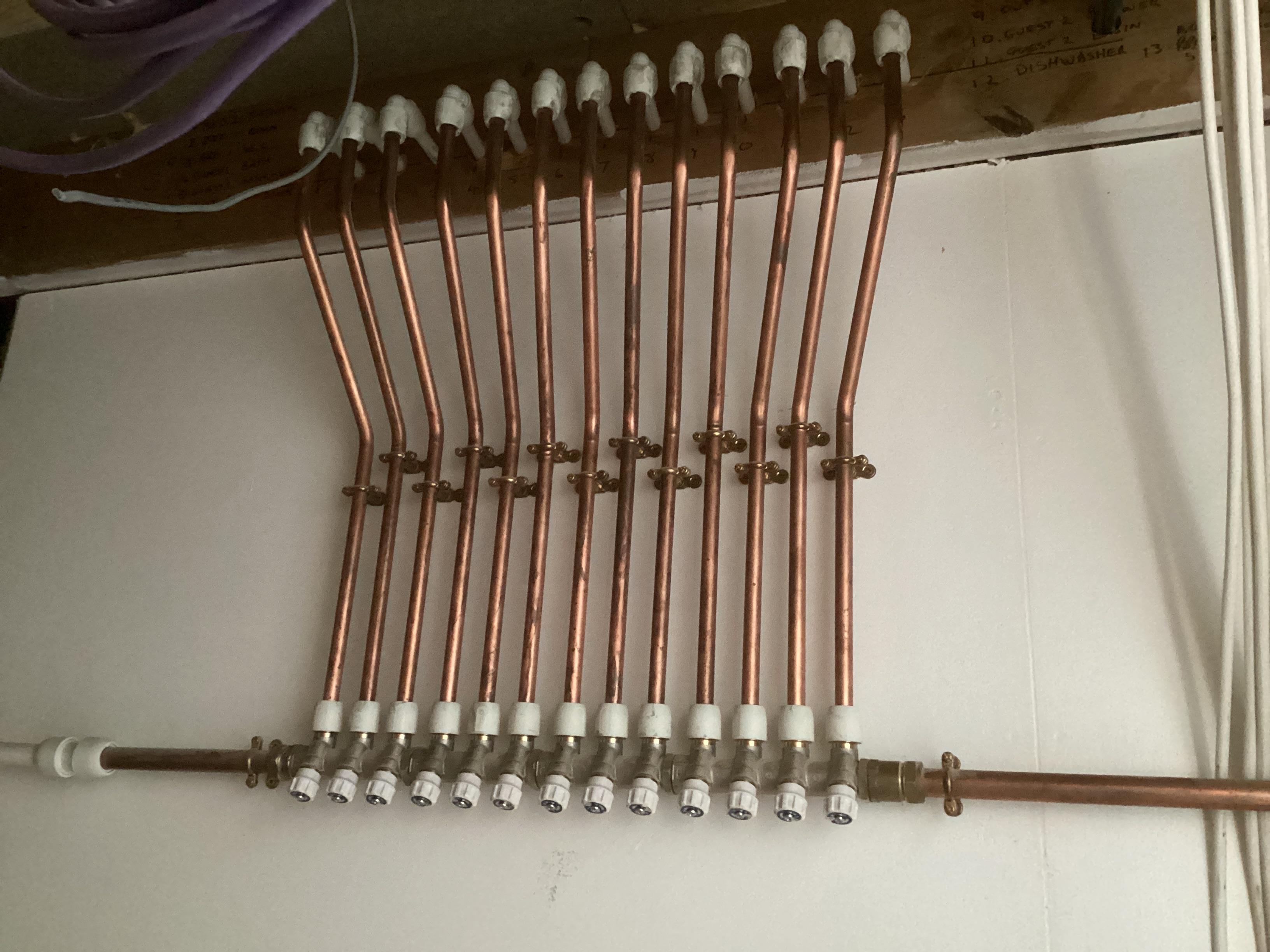

crispy_wafer Posted March 13, 2024 Share Posted March 13, 2024 I've been pottering about with hep over the last couple of evenings, getting the Hep down from the 1st floor void into the plant cupboard in and orderly and tidy fashion is proving a challenge, I know its only a plant cupboard, but it will look crap and bug me forever. To resolve I can think of two options 1) cut the hep up in the void and install 90's on each and run copper tails down the wall to the manifold, or 2) install the manifold in the floor void and just run supply and drain tails down the wall. Have an access hatch in the ceiling so I can poke my shoulders, head and arms in there should I need to. What do you think? Link to comment Share on other sites More sharing options...
BotusBuild Posted March 13, 2024 Share Posted March 13, 2024 I would choose option 1. IMO better to have access to the manifold in the plant room than having to scrabble around in a void. Easier to isolate just one pipe (assuming you have isolators on the manifold). 1 Link to comment Share on other sites More sharing options...

Russell griffiths Posted March 13, 2024 Share Posted March 13, 2024 @crispy_wafer I did this. Link to comment Share on other sites More sharing options...
crispy_wafer Posted March 13, 2024 Share Posted March 13, 2024 27 minutes ago, Russell griffiths said: @crispy_wafer I did this. now that's exactly what I'm thinking of, whether I can execute it aswell remains to be seen. But thats just perfect for me. How did you finish the ceiling? Cut a rectangle out of the board, or fingers for all the pipes? Link to comment Share on other sites More sharing options...
BotusBuild Posted March 13, 2024 Share Posted March 13, 2024 That, Mr Griffiths, is a thing of beauty. Link to comment Share on other sites More sharing options...

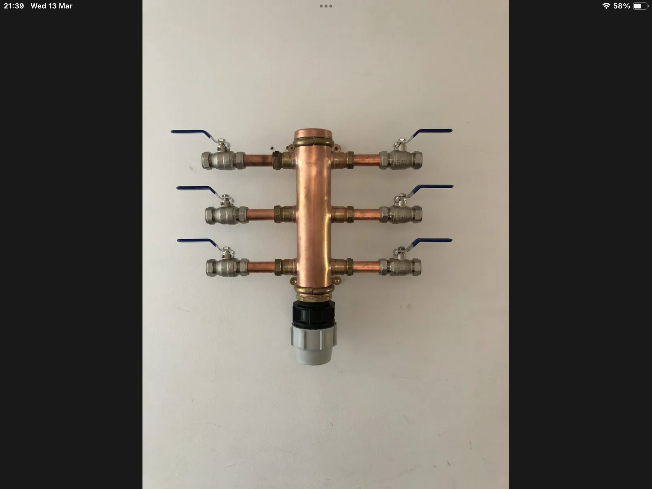

Mr Punter Posted March 13, 2024 Share Posted March 13, 2024 46 minutes ago, Iceverge said: Anything wrong with the 22mm Hep push fit? Worked well for me. I imagine it is fine but we are feeding 8 flats. We have a new 32mm MDPE supply so we are thinking 28mm copper with 28mm x 28mm x 15mm reducing tees to each of the meters. The 28mm will also have a cold water accumulator. Current setup is 15mm spaghetti, so electric showers tend not be too impressive. Link to comment Share on other sites More sharing options...

Russell griffiths Posted March 13, 2024 Share Posted March 13, 2024 5 hours ago, Mr Punter said: I imagine it is fine but we are feeding 8 flats. We have a new 32mm MDPE supply so we are thinking 28mm copper with 28mm x 28mm x 15mm reducing tees to each of the meters. The 28mm will also have a cold water accumulator. Current setup is 15mm spaghetti, so electric showers tend not be too impressive. There is a company on e bay, who make up purposes designed manifolds for splitting incoming mains. have a hunt, they look good. Link to comment Share on other sites More sharing options...
Russell griffiths Posted March 13, 2024 Share Posted March 13, 2024 this sort of thing @Mr Punter 1 Link to comment Share on other sites More sharing options...
Mr Punter Posted March 14, 2024 Share Posted March 14, 2024 13 hours ago, Russell griffiths said: this sort of thing @Mr Punter Yes I saw those and they look v good value compared to the commercial stuff from plasson etc but we are in a tight space and the plumber suggested Ts from a 28mm. I know not much about plumbing but thought if the purpose designed one leaks you would need to replace the whole thing where with normal fittings maybe not. Link to comment Share on other sites More sharing options...
