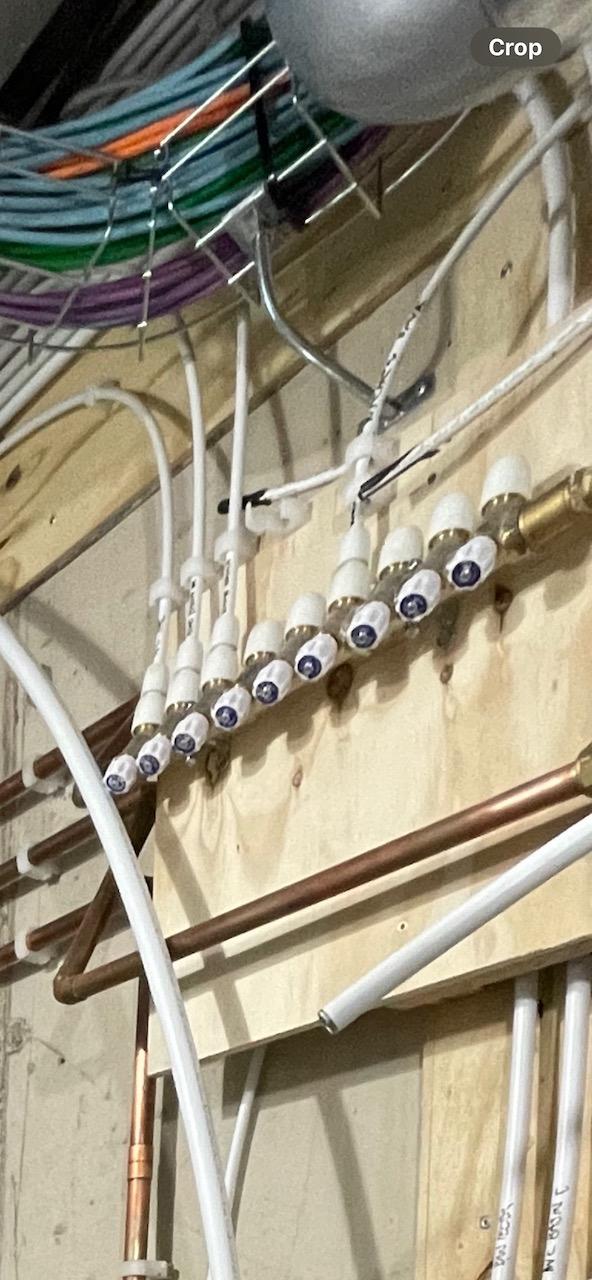

  • They look good the HEP20 ones...
  • Nickfromwales
    Nickfromwales
    This is the best 'zoom-able' pic I can find.  The rails are supported by the pipe work which is held in place with brass Munson rings. Copper to irons on each end, and as a belt n braces job I cr

    My DIY H or C manifold under test using my DIY tester at 2.5 bar

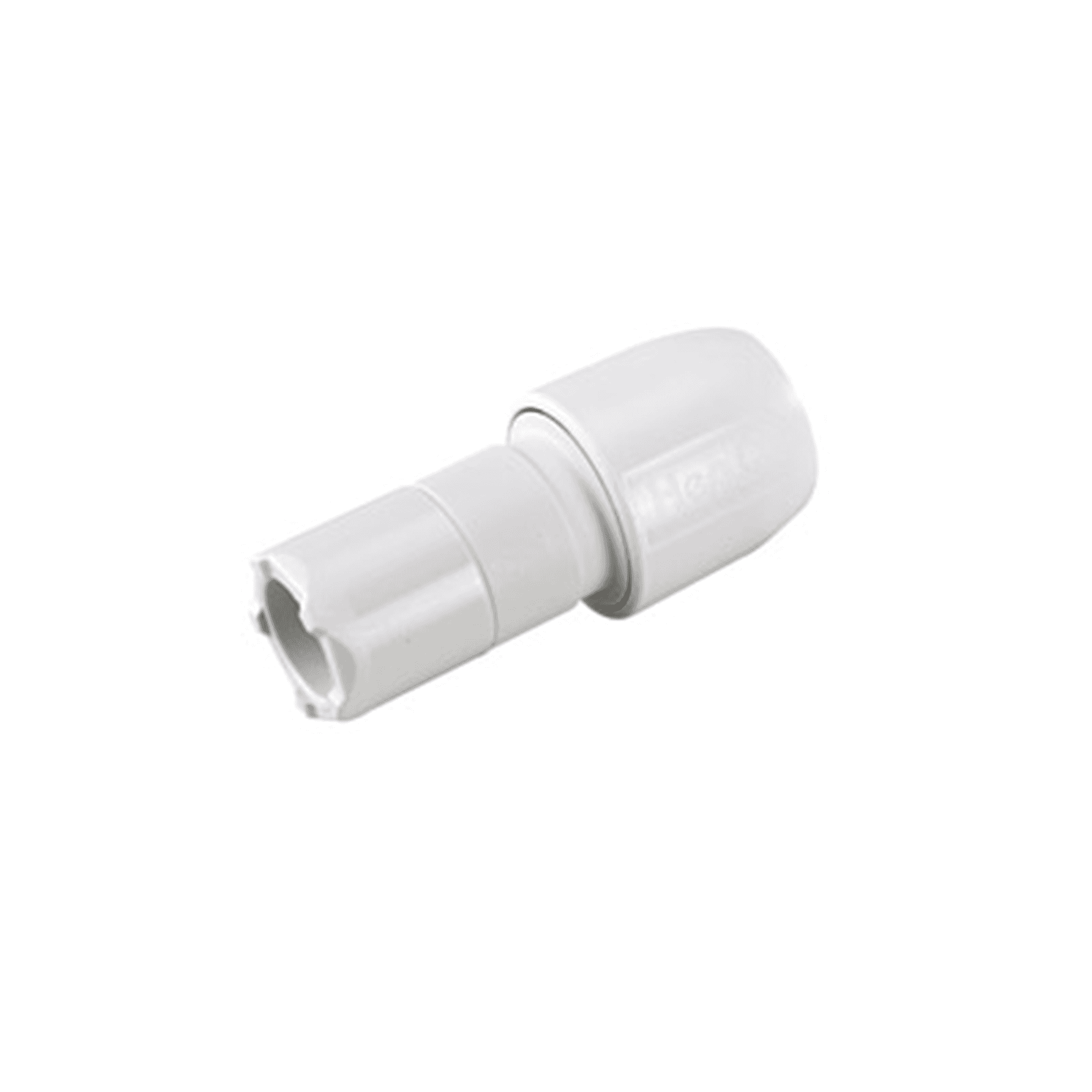

When reducing to 10mm from the manifold 15mm female can you just use a 15-10mm reducer spigot pushed straight into the manifold
Sorry if it’s a daft question this plastic stuff is all new to me 😀
that's what we did
there was some discussion about it as @Pocster found removing them a pain in tight confines but @Nickfromwales said that it was all ok and so I just went ahead and did it! here's that discussion
Brilliant thanks @Thorfun
I had read quite a bit of that thread but missed that bit, probably fell asleep as it’s 23 pages in and a monster thread, very informative in places though 😀

 Yes, this fitting worked for me.  Between Thorfun’s thread and MortarThePoint Hep20 threads, a lot of pushfit plumbing questions are very well covered.
