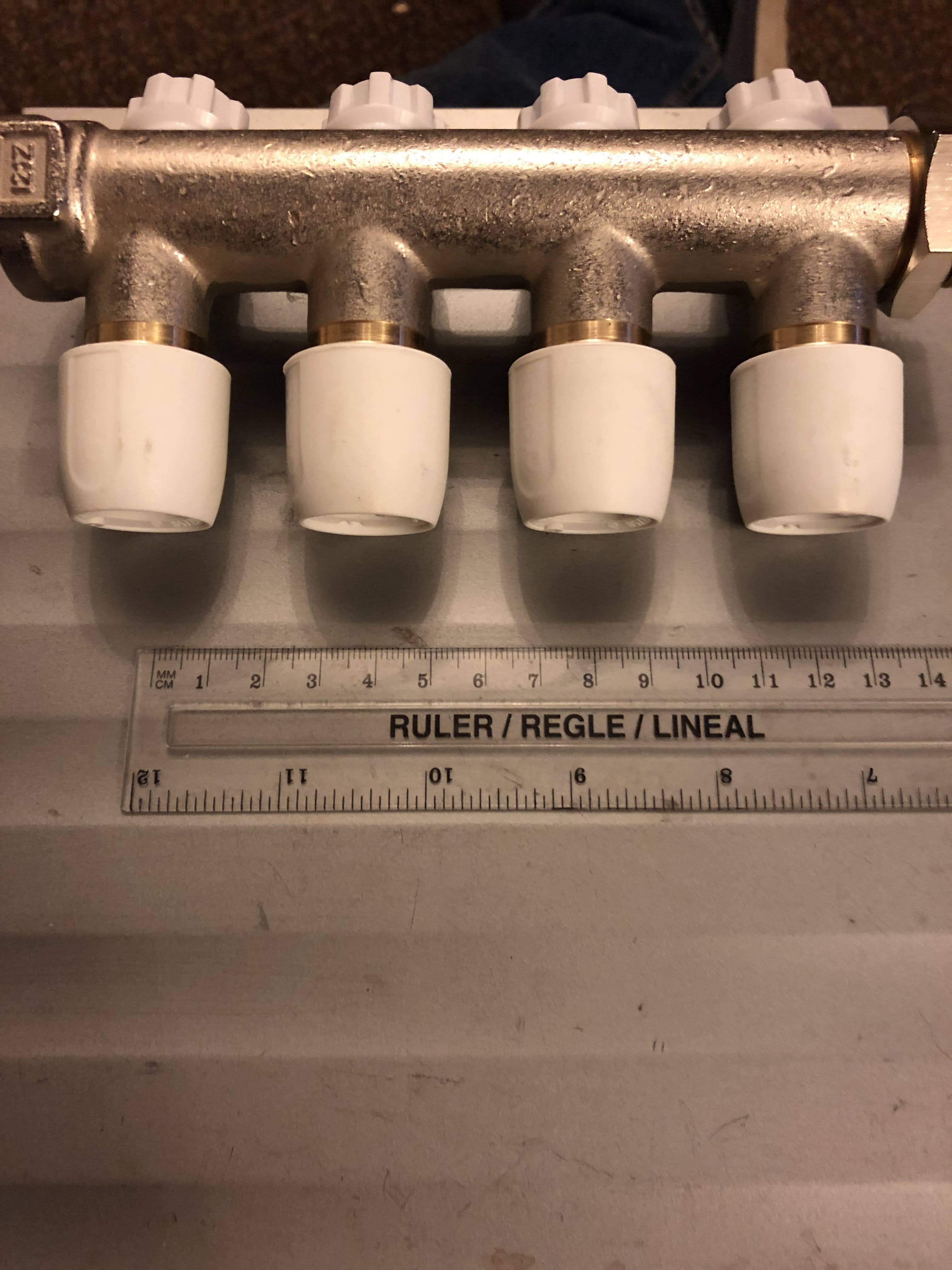

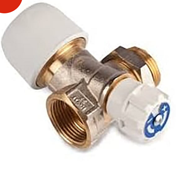

Does anyone know if these Hep2o manifolds, or any other hep2o manifolds, can have an actuator attached? I'm thinking like the standard actuators that Wunda sell (link1) (link2). The knob in the photo below doesn't look promising.
Nope. Those types of actuators are slow functioning and quite 'weak', which is fine as they're only ever supposed to close off a slow-flowing UFH loop, not mains water at that kind of potential.

The knobs on my Hep2o brass manifolds are really sturdy
Yup. Robust bits of kit. Require a high number of turns also to go from 100% open to 100% closed, and need a bit of a "pinch" at the end of the rotational operation to be sure they're fully closed, so actuators wouldn't work with them.

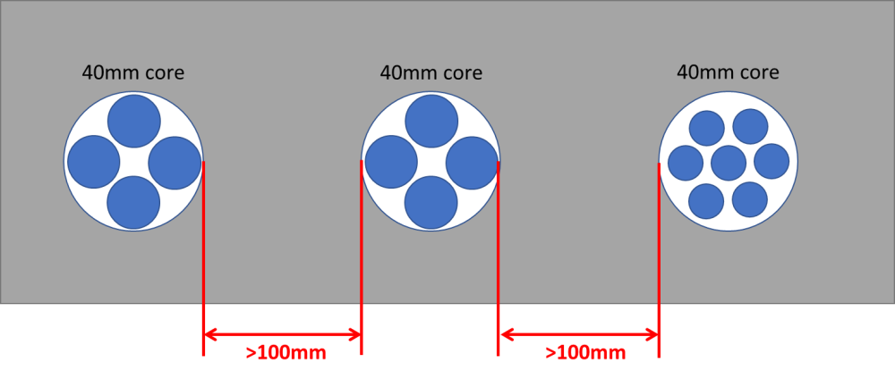

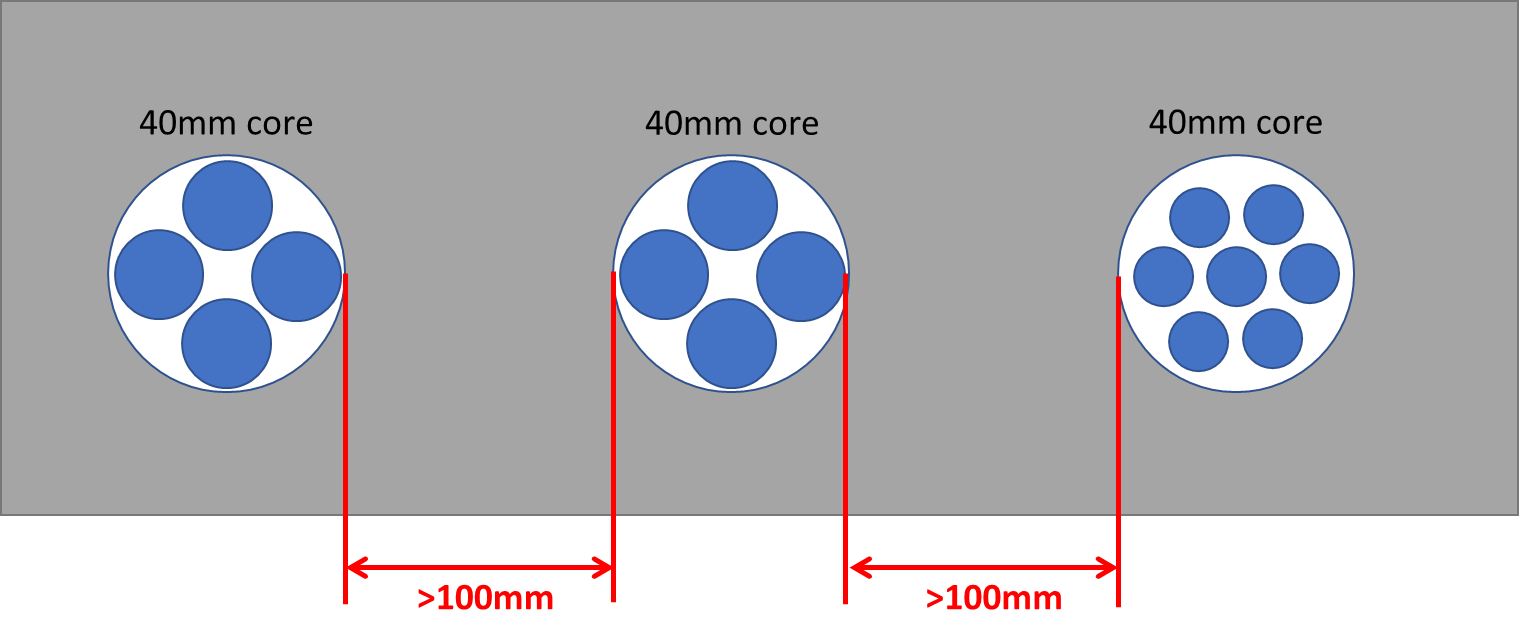

I've worked out that if I have all my outlets as independent runs from the utility cupboard, I'd have 31 runs (12no. 10mm and 19no. 15mm). It would use 108m of 10mm and 132m of 15mm and no additional fittings vs 34m of 10mm and 108mm of 15mm with a dozen or more fittings. The extra cost at the manifold likely wipes out the saving on fittings, but means if I have a leak it will most likely be either at the manifold or at the outlet itself.
It would involve passing 26 pipes through a blockwork wall though, rather than just 12 pipes. I haven't made provision for this, so is the simplest thing to do to core drill larger holes, passing multiple pipes through each? The cold ones would need to pass 15 pipes. Whilst that could all fit through a 70mm core drilled hole, that would be a nightmare to route or make any future changes. Below shows that you can fit 4no. 15mm pipes or 7no. 10mm pipes through a 40mm core drilled hole. Using a 50mm core drill should make it easier and might allow the holes to be lined. I'd want a good gap between the holes to ensure each behaves structurally as a single hole, guessing 100mm would do that. I'd end up with 6 such holes, spread over about a metre.

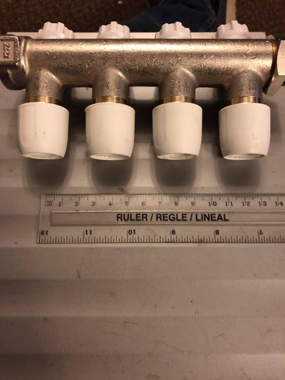

Does anyone know the spacing of the outlets on the brass manifolds?
