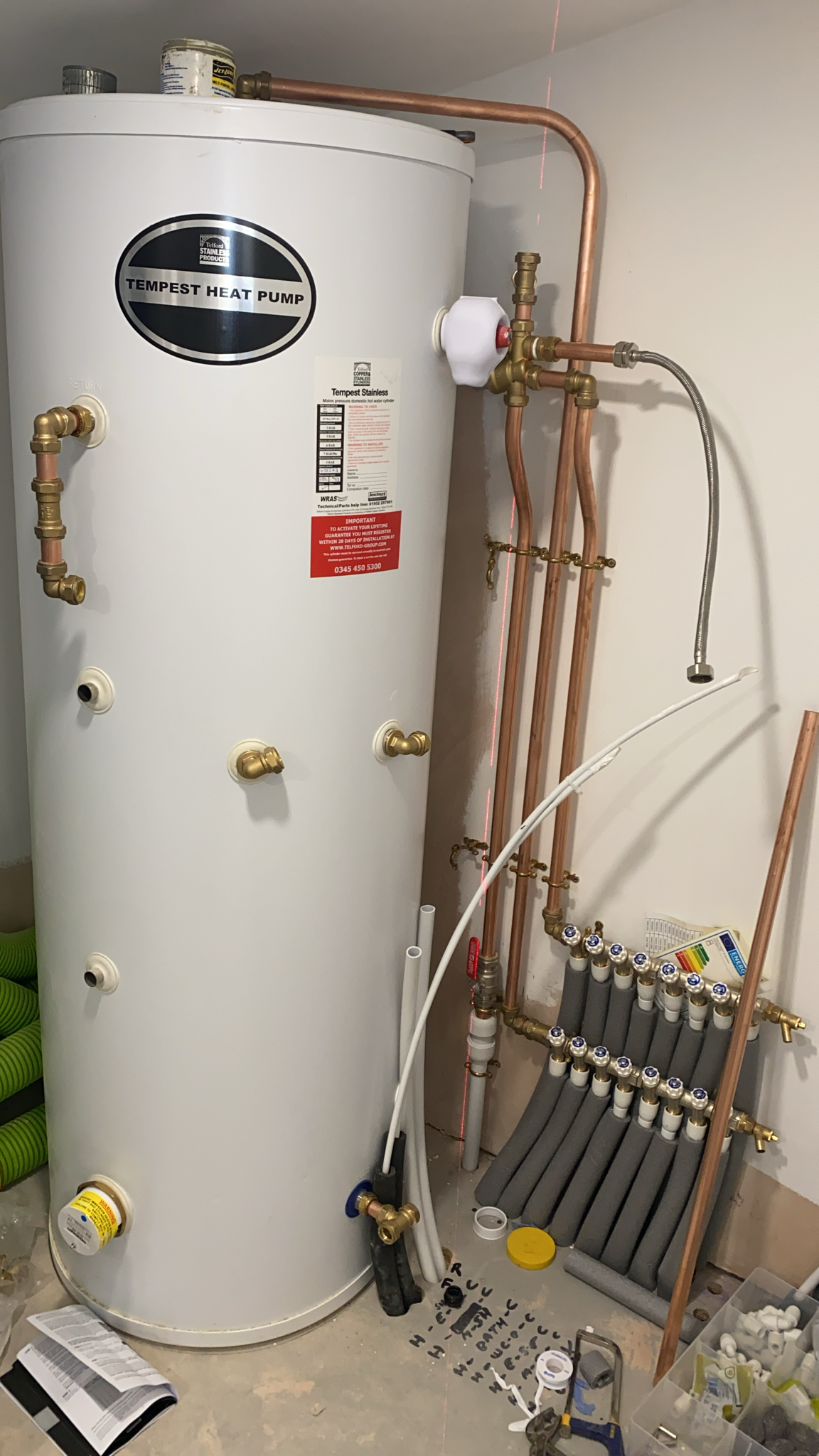

March 14, 20242 yr i can confirm both plastic and copper are fine, i have both. Its just a speedfit connection. Copper where i needed to add in compression checks (then converted to plastic underneath) and plastic where i just wanted to keep an unbroken run to point B. Dont have any great photos, but you can just see it here on the right hand side Edited March 14, 20242 yr by Super_Paulie

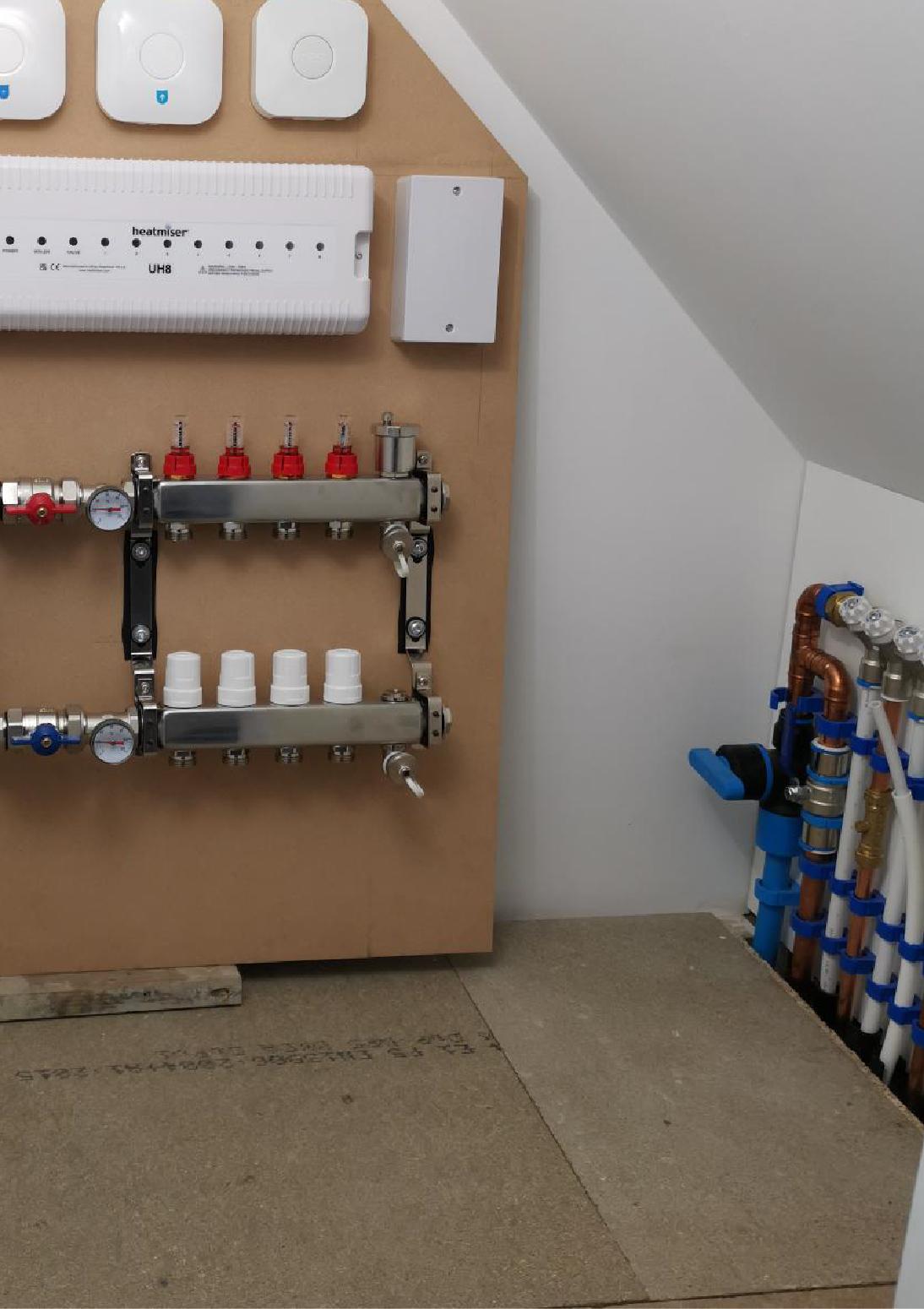

July 6, 20251 yr So... Inspired by this thread I bought the reliance manifolds from Screwfix. I just laid the 5 feeds to each bathroom. Tomorrow I'm going to connect them to manifold. I have 5 hot and 9 cold (including kitchen sink and kitchen appliances). The pipe I bought was the hep20, and to be honest I presumed the reliance manifolds would be fit for anything, but as per above when the box came it says John Guest on it. Which has made me nervous but 15mm barrier pipe is 15mm barrier right? @Nickfromwales kindly suggested 15mm copper tails to separate manufacturers, but I am minded to only do this where I'm stepping from 15-10mm. Has anyone above uses hep20 with it and it was ok? Next q. When mounting manifold I have a tall wall and I'm wondering if I can mount manifold ala ufh manifold ie the hot sits proud in front of the cold. It would save me some horizontal space and also save pipes crossing each other as they come up from the slab. Fingers crossed. Thanks! Will share photo when complete, I'm on it tomorrow!
July 7, 20251 yr I did Copper tails out of manifold to into hep couplers and 10mm sockets here. You can buy brackets like they use for UFH manifolds, cant see why this wouldn't work.
