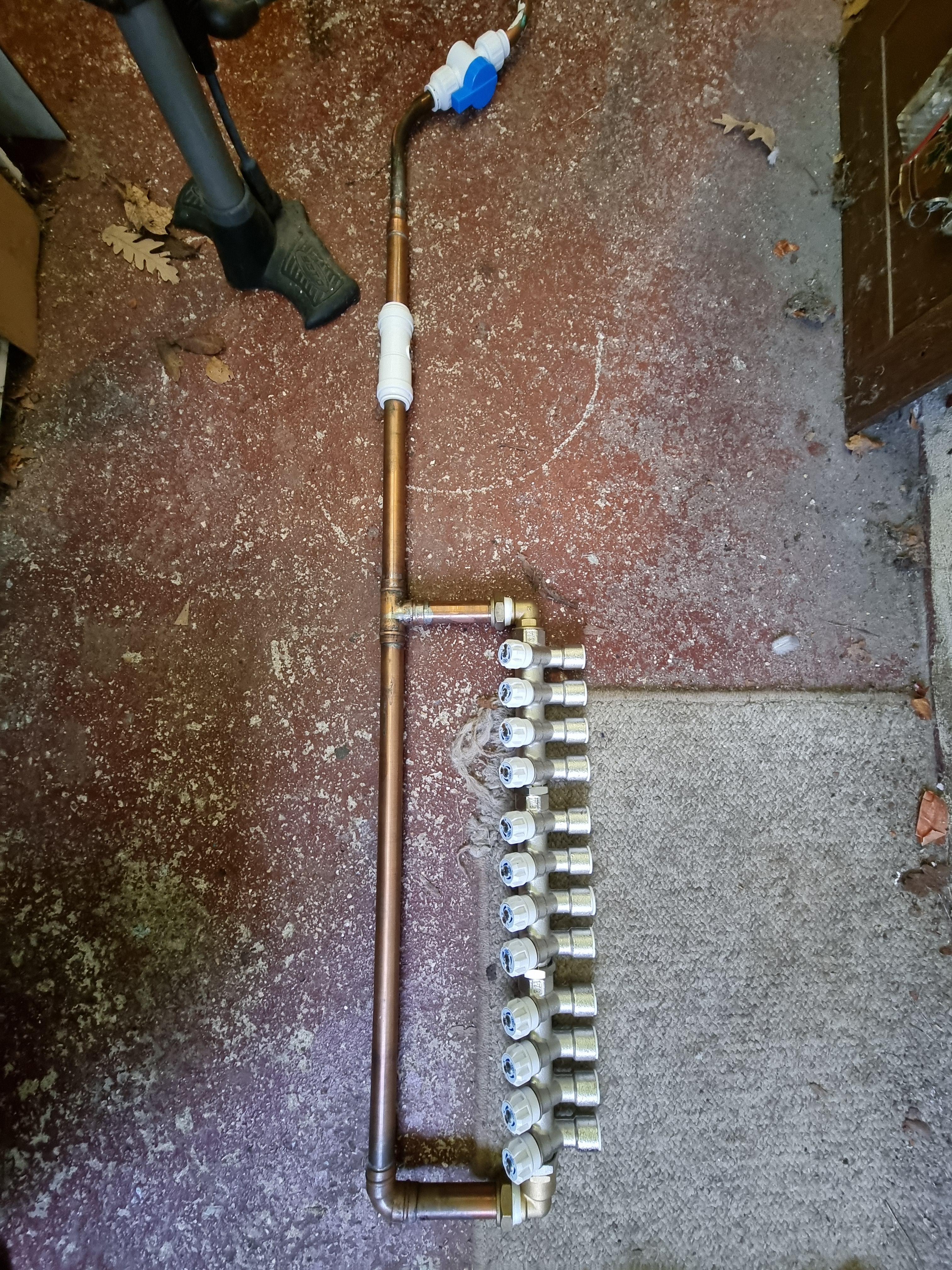

BotusBuild Posted February 18, 2024 Posted February 18, 2024 (edited) @Nickfromwales, would these be a suitable alternative to the manifolds used in your installation? https://www.screwfix.com/p/reliance-valves-4-port-potable-water-manifold-15mm-x-3-4-/248TY?tc=QT6&gad_source=1&gclid=CjwKCAiA8sauBhB3EiwAruTRJo5BJO5VKVRswgkQADFqoJxyFr2U9b6brJWLiAnkUGBAo8eJxS5YiBoCdckQAvD_BwE&gclsrc=aw.ds and here https://www.reliancevalves.com/gb/en/products/flow-control/plumbing-strainers-flow-regulators-manifolds/potable-water-manifolds Edited February 18, 2024 by BotusBuild
Thorfun Posted February 18, 2024 Posted February 18, 2024 46 minutes ago, BotusBuild said: @Nickfromwales, would these be a suitable alternative to the manifolds used in your installation? https://www.screwfix.com/p/reliance-valves-4-port-potable-water-manifold-15mm-x-3-4-/248TY?tc=QT6&gad_source=1&gclid=CjwKCAiA8sauBhB3EiwAruTRJo5BJO5VKVRswgkQADFqoJxyFr2U9b6brJWLiAnkUGBAo8eJxS5YiBoCdckQAvD_BwE&gclsrc=aw.ds and here https://www.reliancevalves.com/gb/en/products/flow-control/plumbing-strainers-flow-regulators-manifolds/potable-water-manifolds damn! they're so much cheaper than the hep2o ones. even if you have to buy hep2o couplers and run a bit of copper to the hep2o coupler and then plastic on from there it'll still be so much cheaper. it's too late for me but I'll be interested in Nick's response.

BotusBuild Posted February 19, 2024 Posted February 19, 2024 13 hours ago, Pocster said: Saving pennies ! Nope, saving pounds. Cheapest Hep20 4 port 3/4" I can find is currently £54.88 vs £35.59. I call that a good difference and one worth investigating.
Jenki Posted February 19, 2024 Posted February 19, 2024 5 minutes ago, BotusBuild said: Nope, saving pounds. Cheapest Hep20 4 port 3/4" I can find is currently £54.88 vs £35.59. I call that a good difference and one worth investigating. I've used the Screwfix ones they are excellent. Used John guest spigot reducers for the 10 mm runs. Well worth the saving.
jayc89 Posted February 19, 2024 Posted February 19, 2024 8 minutes ago, BotusBuild said: Nope, saving pounds. Cheapest Hep20 4 port 3/4" I can find is currently £54.88 vs £35.59. I call that a good difference and one worth investigating. I bought mine from Travis Perkins for 40.96 each

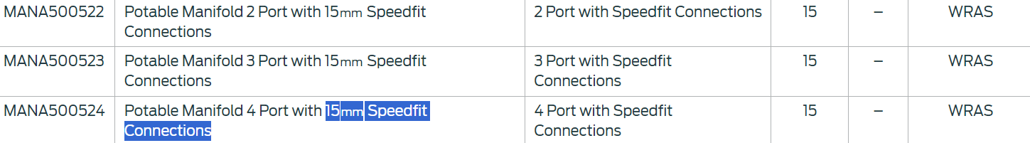

BotusBuild Posted February 19, 2024 Posted February 19, 2024 Just an FYI - took this screenshot from the Reliance Valves website: So it seems like they are compatible as per @Jenki's pictures
Russell griffiths Posted February 19, 2024 Posted February 19, 2024 Reliance is a very well known valve/pneumatic type company they where bought out by John guest. it’s good gear. 2 1

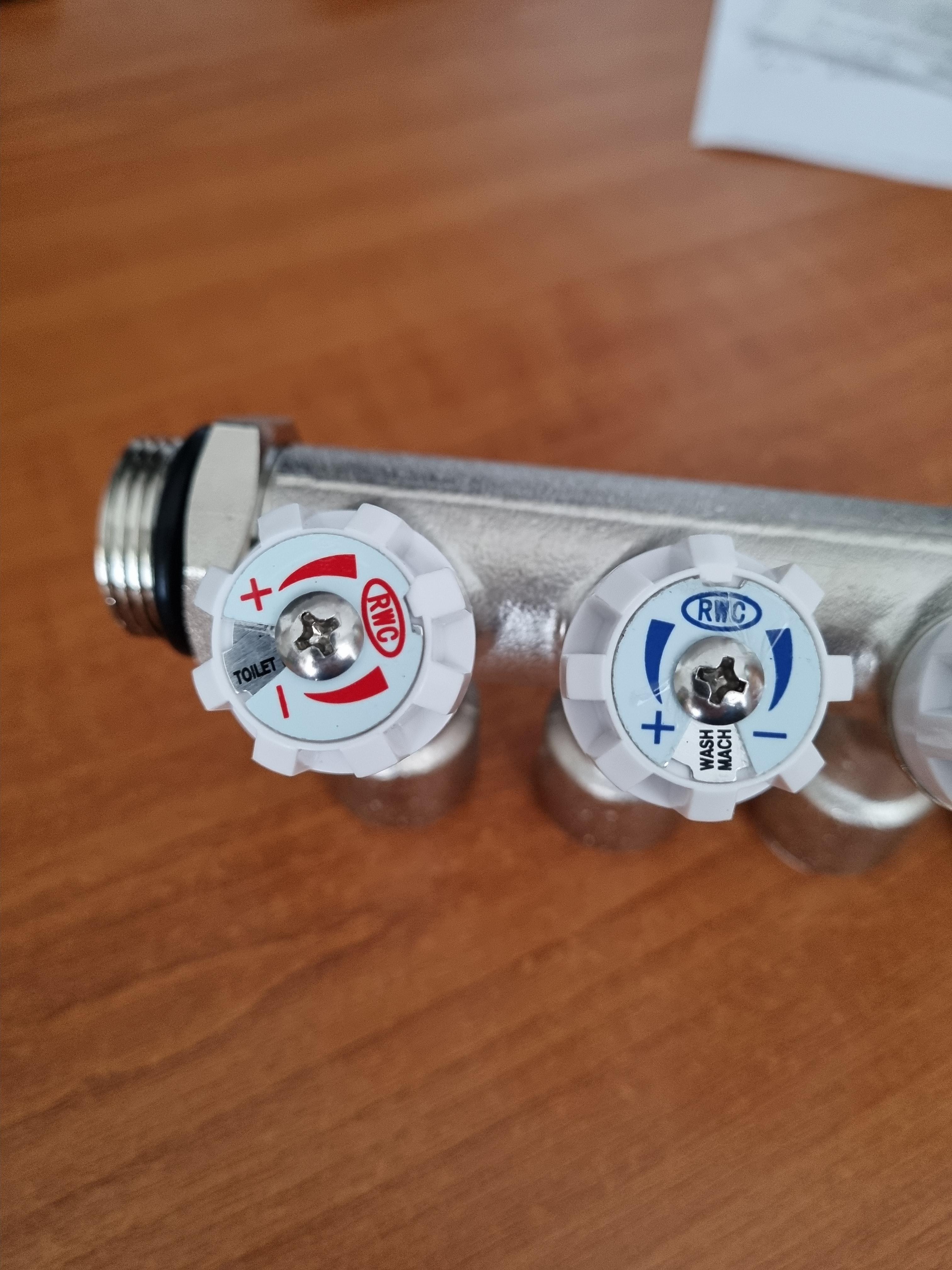

BotusBuild Posted February 28, 2024 Posted February 28, 2024 Got the Reliance valves yesterday, and found something not in the description - the indicator can be flipped over for hot outlets 😀. Obviously not on the same manifold. Picture for reference only 😉 3
Super_Paulie Posted February 28, 2024 Posted February 28, 2024 havent leaked yet, seems a decent bit of kit. 2
Jenki Posted February 28, 2024 Posted February 28, 2024 2 hours ago, BotusBuild said: Got the Reliance valves yesterday, and found something not in the description - the indicator can be flipped over for hot outlets 😀. Obviously not on the same manifold. Picture for reference only 😉 that's on my snag list ..... But never noticed the descriptions, need my readers on to actually see the letters 🤣.....

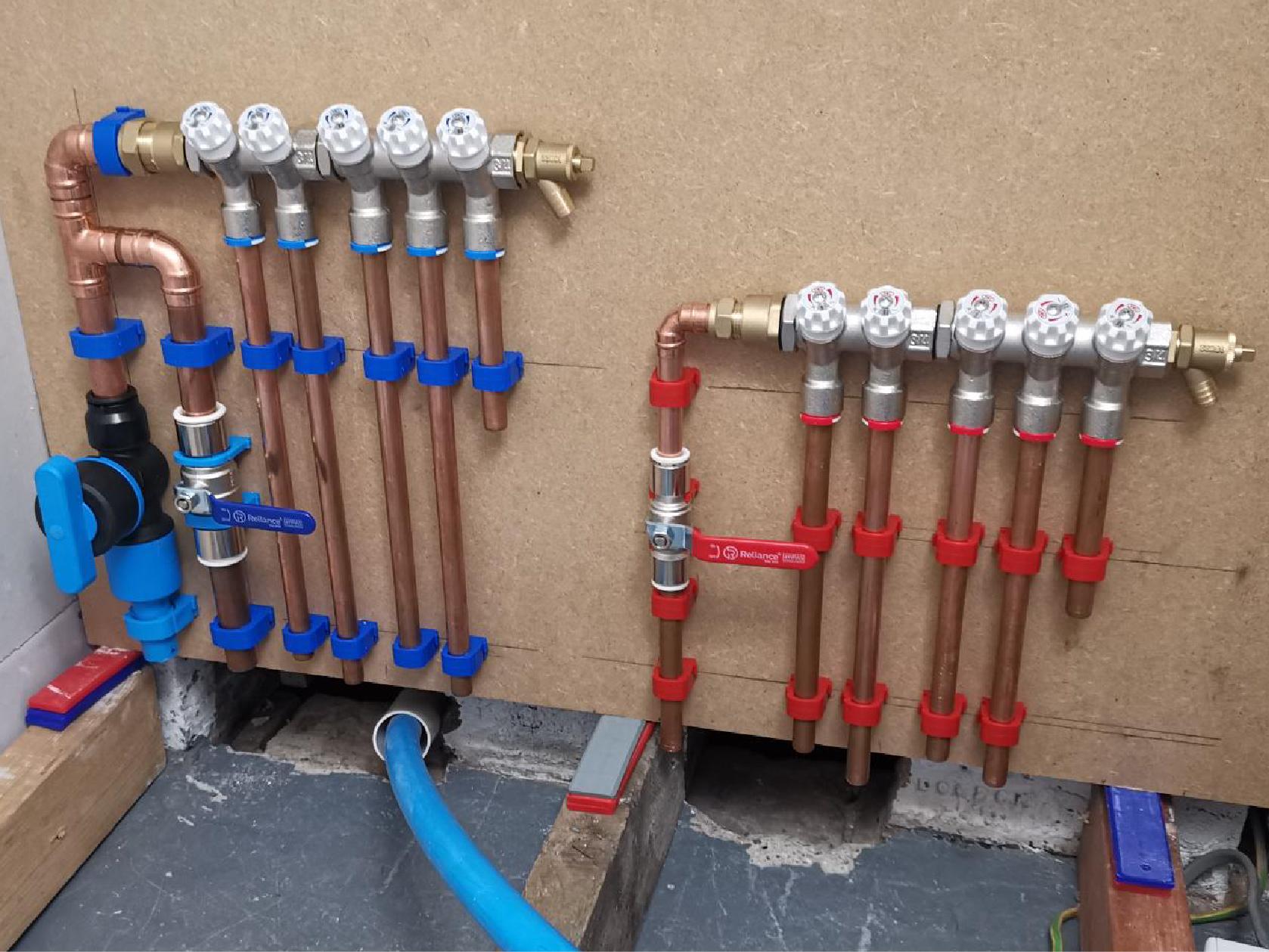

BotusBuild Posted March 11, 2024 Posted March 11, 2024 My DIY H or C manifold under test using my DIY tester at 2.5 bar 4
