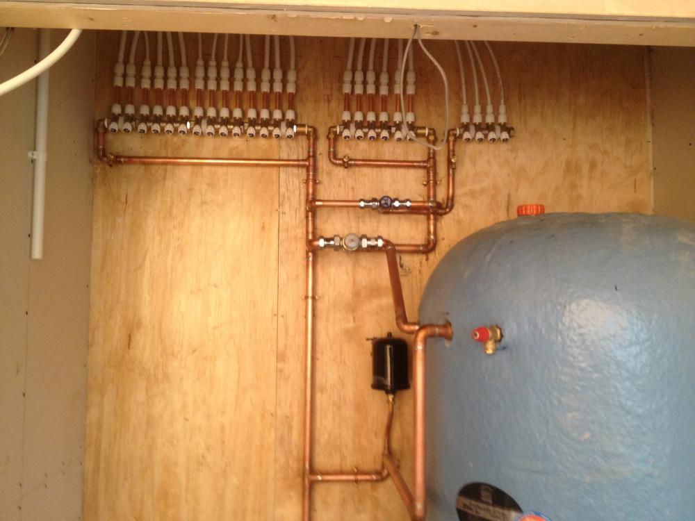

dogman Posted June 19, 2017 Posted June 19, 2017 @Nickfromwales Any chance you can measure the finished length of the cold manifold in your picture. i am trying to decide where best to put mine and the length will help
Nickfromwales Posted June 19, 2017 Posted June 19, 2017 1 hour ago, dogman said: @Nickfromwales Any chance you can measure the finished length of the cold manifold in your picture. i am trying to decide where best to put mine and the length will help A bit tricky mate, as I'm in Swansea and that manifold lives in oxford

Nickfromwales Posted June 19, 2017 Posted June 19, 2017 22 minutes ago, Nickfromwales said: A bit tricky mate, as I'm in Swansea and that manifold lives in oxford If you take each white knuckle of each manifold to be say 25mm and it looks like a 8-10mm gap between them you can just multiply that by the number of outlets you need.
Nickfromwales Posted June 19, 2017 Posted June 19, 2017 25 minutes ago, dpmiller said: I've never tried it, so what's the flow like at mains pressure down 10 or 15m of 10mm? Surprisingly adequate for a wash basin tap. More than adequate for a WC, and as the flow velocity is reduced it helps to quieten down the noise of the loo filling . I have both my basins off radial 10mm runs teed from a 15mm pipe coming out of my TMV and it's more than adequate. Any more and I'd not be able to flick the tap to the fully open position. 3m to first one and 6m to furthest away . As is I just flick the mixer tap fully open in the hot position and it comes out with good flow rates and the exact same comfortable temp every time without fannying around. Bingo bango. ?

MortarThePoint Posted May 20, 2022 Posted May 20, 2022 (edited) On 24/07/2016 at 11:47, Nickfromwales said: This is the best 'zoom-able' pic I can find. The rails are supported by the pipe work which is held in place with brass Munson rings. Copper to irons on each end, and as a belt n braces job I created a ring so the manifolds got fed from both ends. I did that as the cold manifold was very long and could have suffered loss of flow and I just then carried that across to the hot manifold to as it was easy enough to do. The remit on that job was to be able to use all the showers at the same time and still have some useable flow / pressure elsewhere so went to town on this one. If you zoom in you'll see opaque / white plastic spacers in between the manifolds ( 3 to the long run ). These iirc were 28mm Talon pipe clips which held the rails with near spot on results. Another way to do this, if only feeding from just one end, would be a clip on the input pipe work and then a stub of pipe made off and cap ended ( or a DOC ) the other side, with enough pipe to get a second clip on. An old thread, but a beautiful install and surely a standard to try to match with my own. Another benefit that comes to mind with using an isolating manifold is the possibility of adjusting flow rate to basins etc. What with the required water usage calculations etc, being able to set the flow could help reach a required total without putting restrictors in the pipes themselves or buying expensive taps. Did you add insulation to all the pipes after this photo was taken? Edited May 20, 2022 by MortarThePoint
Nickfromwales Posted May 20, 2022 Posted May 20, 2022 Yup. Insulate after a week of everything being pressurised, as a drip / dribble will not show so easily otherwise. You cannot use these isolators as attenuators, as I’ve found previously that they are quite noisy when the flow is ‘strangled’, plus the results were very unreliable in practice. Deffo use inline flow restrictors at the appliance. For the basins, 10mm pipe seems to give just the right amount of flow. Buy one and hook it up and see if that works for you, but I never use them for flow attenuation, personally, as clients like things to be as quiet as possible. 1 1

Nickfromwales Posted May 20, 2022 Posted May 20, 2022 Indeed. Especially on a new build where you may want to progressively make rooms live as the project moves forward. Saves filling up and draining down repeatedly, plus the radial arrangement gives very good flow to multiple outlets eg 2 showers running simultaneously.

Nickfromwales Posted May 21, 2022 Posted May 21, 2022 Just now, Chanmenie said: Ok thanks again @Nickfromwalesi’ll forget the softener then, so where does that leave me with the best place to bring the main in. is it better closer to the manifolds ? Yup. You can then simply feed the kitchen sink also from the manifolds. In this pic, the mains comes from an immediately adjacent airing cupboard in 28mm pipe, and I fed both sides of the manifolds ( like a plumbing version of a ring main ) as I then installed a 300L cold mains accumulator in the left hand side of that ‘airing cupboard’. For that particular job, the client stated he wanted to be able to use all 3 showers simultaneously, so I went to town on it.
