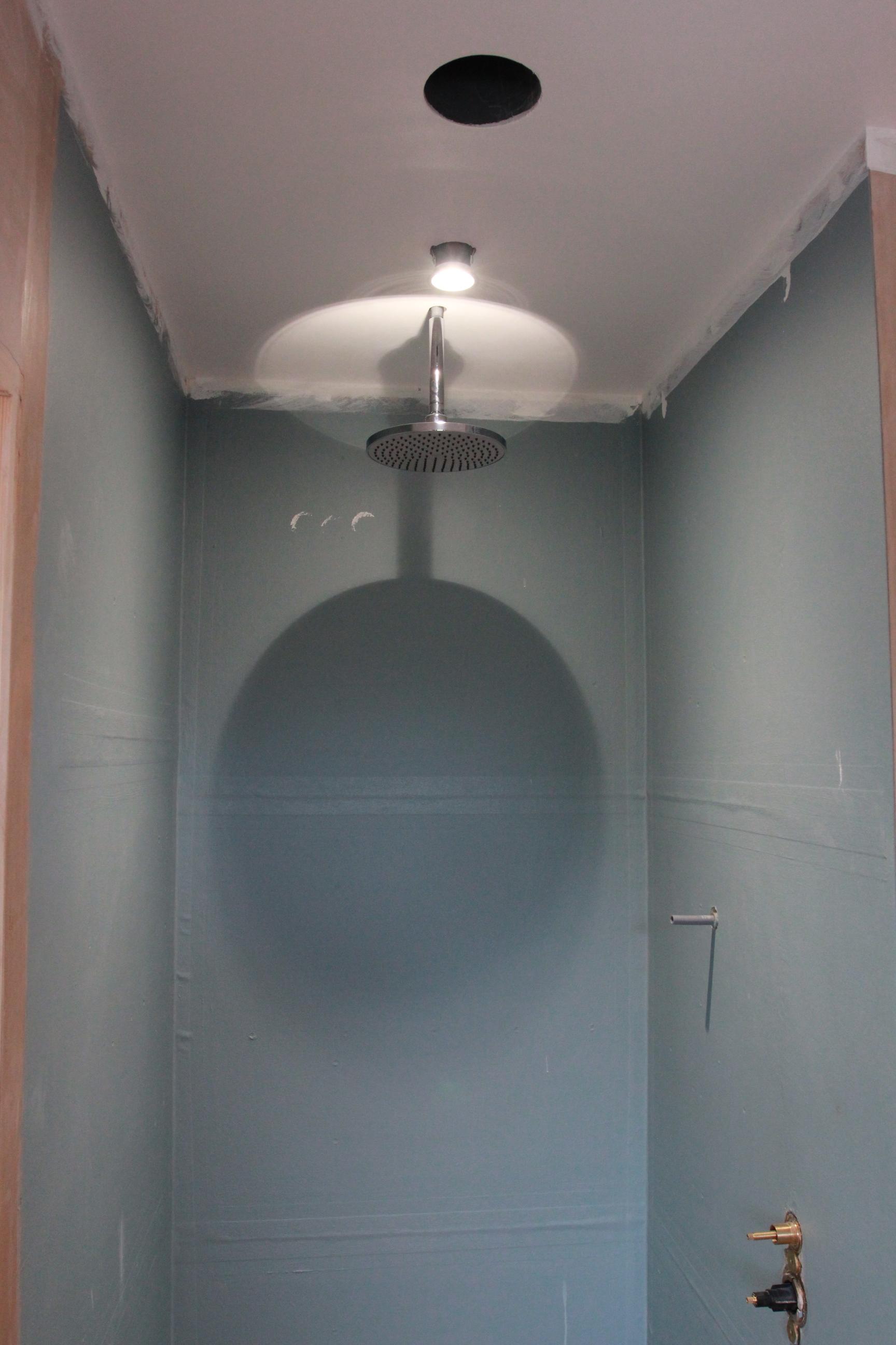

CC45 Posted September 16, 2018 Share Posted September 16, 2018 Dear reader, Spent the day putting spot lights in the bathrooms & ensuites. Turned the one below on and thought bugger. Not what I expected. The walls need tiling (smart white tiles) so that may reduce the shadow a bit and the reflection from the shower head I can reduce with some black material stuck to the top but I still think the shadow will be really noticeable SO does anyone have any ideas? The current lights (Enlite E5) have a 60deg spread - one with a narrower beam would help but I suspect it would be a marginal improvement. Help! Link to comment Share on other sites More sharing options...
Hecateh Posted September 16, 2018 Share Posted September 16, 2018 Doesn't really help but my set up was similar. My new plumber (half the price, twice the quality of my previous one) Pointed out that that would happen and suggest I reorganise with spark that the light is either moved or split so that there is a light either side rather than a single one above, Link to comment Share on other sites More sharing options...
Cpd Posted September 16, 2018 Share Posted September 16, 2018 I used one of these, admittedly it was not in the splash zone.... I am very happy with its somewhat diffused light. My shower light is built into the extractor fan. Not sure if it would fully stop the shadow but something along these lines might work. Link to comment Share on other sites More sharing options...
Russell griffiths Posted September 16, 2018 Share Posted September 16, 2018 I think you may be overthinking a bit soon get it all tiled and have another look. You can change the bulbs to one with a different spread pattern so may change it i wouldn’t panic yet 1 Link to comment Share on other sites More sharing options...
Ferdinand Posted September 16, 2018 Share Posted September 16, 2018 36 minutes ago, CC45 said: Dear reader, Spent the day putting spot lights in the bathrooms & ensuites. Turned the one below on and thought bugger. Not what I expected. The walls need tiling (smart white tiles) so that may reduce the shadow a bit and the reflection from the shower head I can reduce with some black material stuck to the top but I still think the shadow will be really noticeable SO does anyone have any ideas? The current lights (Enlite E5) have a 60deg spread - one with a narrower beam would help but I suspect it would be a marginal improvement. Help! You could find an ip45 or ip65 spot fitting on a mount rather than flush. Or tile the back in a dark colour? Link to comment Share on other sites More sharing options...
Nickfromwales Posted September 16, 2018 Share Posted September 16, 2018 Storm in a teacup. Tile it and stop worrying about trivia You won’t ever notice it unless you stand there staring. Had the chat a thousand times as showers are often small rooms and it’s unavoidable. All agreed to fit as is and move onto something of greater significance Link to comment Share on other sites More sharing options...

wozza Posted September 16, 2018 Share Posted September 16, 2018 Enlite do a E5 that can angled I believe - you could try it and angle it away from the shower head. Link to comment Share on other sites More sharing options...
CC45 Posted September 16, 2018 Author Share Posted September 16, 2018 Did notice that, not 100% sure it will do the job. Should have used it & mounted lamp further out. Link to comment Share on other sites More sharing options...

AliG Posted September 17, 2018 Share Posted September 17, 2018 I have one shower that does that, but I decided it wasn't worth worrying about. If you want to fix it, why not just move the light further from the shower head so that the beam doesn't hit the top of it. Not a big job, just fill in the hole. 1 Link to comment Share on other sites More sharing options...
