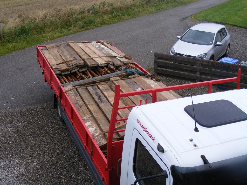

I bought mine from a private seller on ebay, just finishing a self build.  I could not find any for sale locally at the time so ended up hiring a 7.5 ton flat bed and doing a 700 mile round trip in 23 hours including a few hours kip in the cab.
10 minutes ago, ProDave said:
Hiring  a 7.5 ton flat bed and doing a 700 mile round trip in 23 hours including a few hours kip in the cab.
Wow, that’s self Build dedication at its best.
