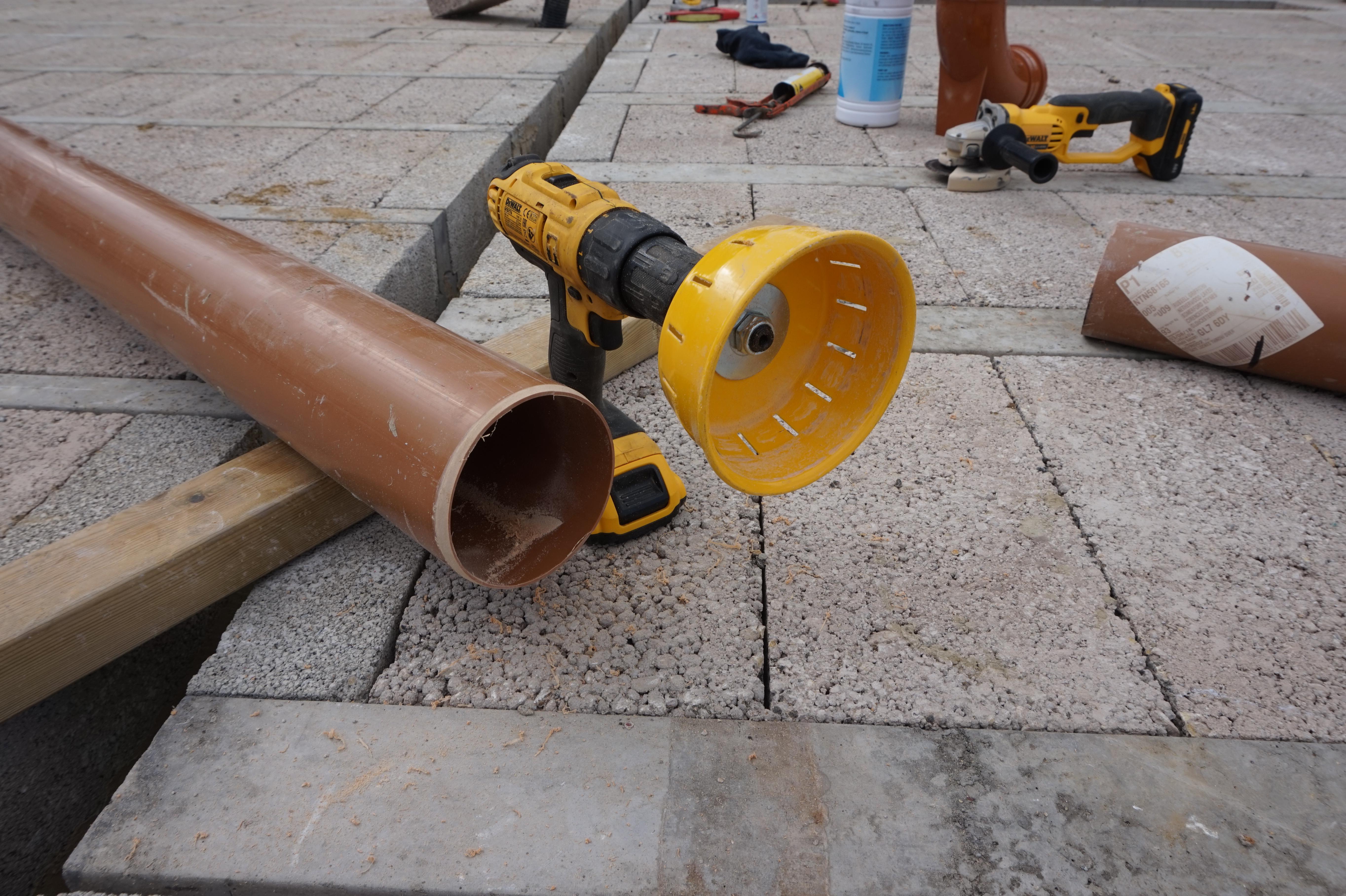

Russell griffiths Posted August 25, 2018 Posted August 25, 2018 Morning I’ve been using this tool to put the taper back on the ends of any cut drainage pipe, works a treat. Little bit costly but has been used in anger all week and paid for itself already. 3 1
Gone West Posted August 25, 2018 Posted August 25, 2018 A lot quicker than doing it by hand using a rasp which is how I did all mine. Wish I'd known they existed a few years ago.
Mr Punter Posted August 25, 2018 Posted August 25, 2018 Never seen these before. Does it do 160mm as well as 110mm?
Russell griffiths Posted August 25, 2018 Author Posted August 25, 2018 I believe they make a 160 version
Onoff Posted August 25, 2018 Posted August 25, 2018 I do mine with the cordless angle grinder,. That's a prettier result though! 1
joe90 Posted August 25, 2018 Posted August 25, 2018 Yes I used an angle grinder with a flap wheel but that’s a lot neater, what’s the cost and where did you source it!
nod Posted August 25, 2018 Posted August 25, 2018 49 minutes ago, Russell griffiths said: Morning I’ve been using this tool to put the taper back on the ends of any cut drainage pipe, works a treat. Little bit costly but has been used in anger all week and paid for itself already. What a great idea
Russell griffiths Posted August 25, 2018 Author Posted August 25, 2018 12 minutes ago, joe90 said: Yes I used an angle grinder with a flap wheel but that’s a lot neater, what’s the cost and where did you source it! £24 e bay. 1
Cpd Posted August 25, 2018 Posted August 25, 2018 Top bit of kit, one day in the future I will need such as this..... one day.
Vijay Posted August 25, 2018 Posted August 25, 2018 I wish I'd bought one before I started doing my pipework - found it a horrible job with a rasp. No point now as I've only got the rainwater pipes to do (although there's quite a bit). The guys doing the access drive used their petrol cutter, left it on the floor and turned the pipe against the blade - not the safest move I guess and stupid not to have a proper tool for the job when you do it all the time.......................... 1

Russell griffiths Posted August 25, 2018 Author Posted August 25, 2018 5 hours ago, Onoff said: I do mine with the cordless angle grinder,. That's a prettier result though! To be honest I think you could probably make one in a couple of hours. I was a bit underwhelmed with the design but it works very well.
Onoff Posted August 25, 2018 Posted August 25, 2018 I wonder if you could incorporate a couple of Stanley blades into a precise "chamferer"...

PeterW Posted August 25, 2018 Posted August 25, 2018 25 minutes ago, Onoff said: I wonder if you could incorporate a couple of Stanley blades into a precise "chamferer"... Thats how the cheap Chinese ones work - two Stanley blades in a pudding basin and a mandrel stuck on. They seem to have holes in the back to break your fingers too ...

Triassic Posted August 25, 2018 Posted August 25, 2018 I’m trying to build my house using the minimum number of tools. I used an old wood saw to cut the pipe and a Stanley knife to chamfer the pipe (hold it at 90 degrees to the pipe and pull the knife towards you).
