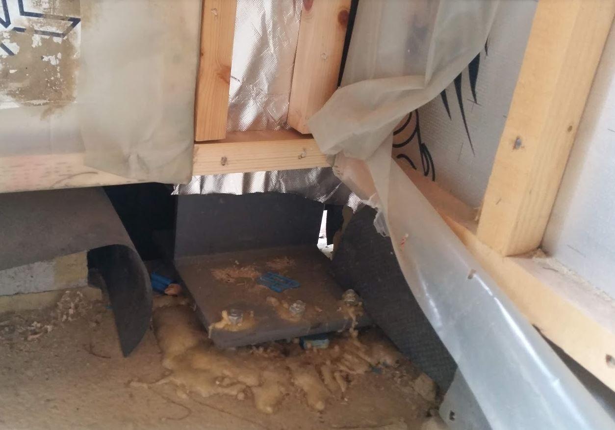

Ed_MK Posted August 11, 2018 Author Posted August 11, 2018 Its time for me to get the Beams and Block cleaned and get the vapour barrier and Cellotex down (in prep for screed and some plumbing pipes first) ...but i am puzzled what to do at all the "holes" ?!? Around the perimeter wherever there is one of those metal feet bolted to the slab to take the frame thee are Gaps ...between the kicker bricks and the foot itself, some are inches ...but most are several inches like below and you can see daylight inside ... How do i deal with these ...should they be filled as best i can, concrete ? or would that be bad against the metal ..puzzled (as usual)
epsilonGreedy Posted August 19, 2018 Posted August 19, 2018 On 11/08/2018 at 04:42, Ed_MK said: Its time for me to get the Beams and Block cleaned and get the vapour barrier and Cellotex down (in prep for screed and some plumbing pipes first) ...but i am puzzled what to do at all the "holes" ?!? I watched 50mm of flowscreed being applied to my neighbour's plot this week. The installers spent time plugging such gaps in the perimeter as flow screed would escape round the frame brackets shown in your photo. No expert here but surely the solution is small insulation upstands around those frame foots if only to prevent cold bridges. The cost of the job was £4000 for 90 sqm including UHF components and pipe installation.
Ed_MK Posted August 22, 2018 Author Posted August 22, 2018 Thanks! I have already cleared them out and filled with Expanding filler. so there is no path to outside now Lots of the frame panels have DPC and polythene hanging off the bottom etc ....This will get int he way when I am trying to lay the Cellotax and the 1200 heavy membrane up the wall ...do you just cut it flush ? ...as the 1200 dpm is already going to be fixed 150mm up the panel
