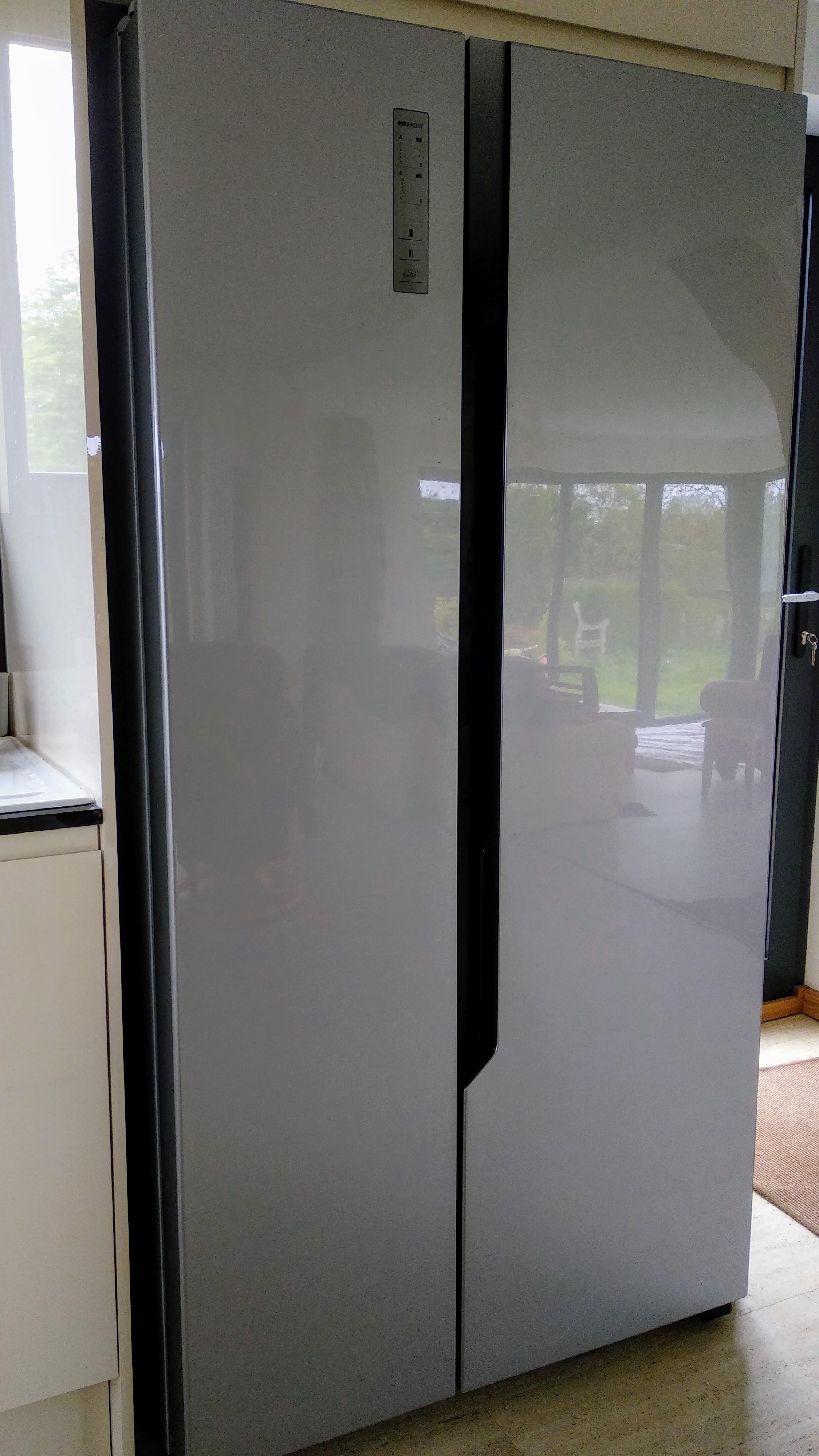

richi Posted April 30, 2018 Posted April 30, 2018 (edited) 3 hours ago, ProDave said: The mechanism for that takes up about the top third of the freezer. It was also not the most reliable thing Your experience seems typical. Which was why I bought one without. Pretty happy with my £370 Fridgemaster MS91518FFS from AO [as always, any piddling kickback goes to @Coopers' dog-rescue charity] Edited April 30, 2018 by richi @ & photo
Ferdinand Posted April 30, 2018 Posted April 30, 2018 7 minutes ago, richi said: Your experience seems typical. Which was why I bought one without. Pretty happy with my £370 Fridgemaster MS91518FFS from AO [as always, any piddling kickback goes to @Coopers' dog-rescue charity] Family friend has A Fridgemaster. Also likes it. 1
