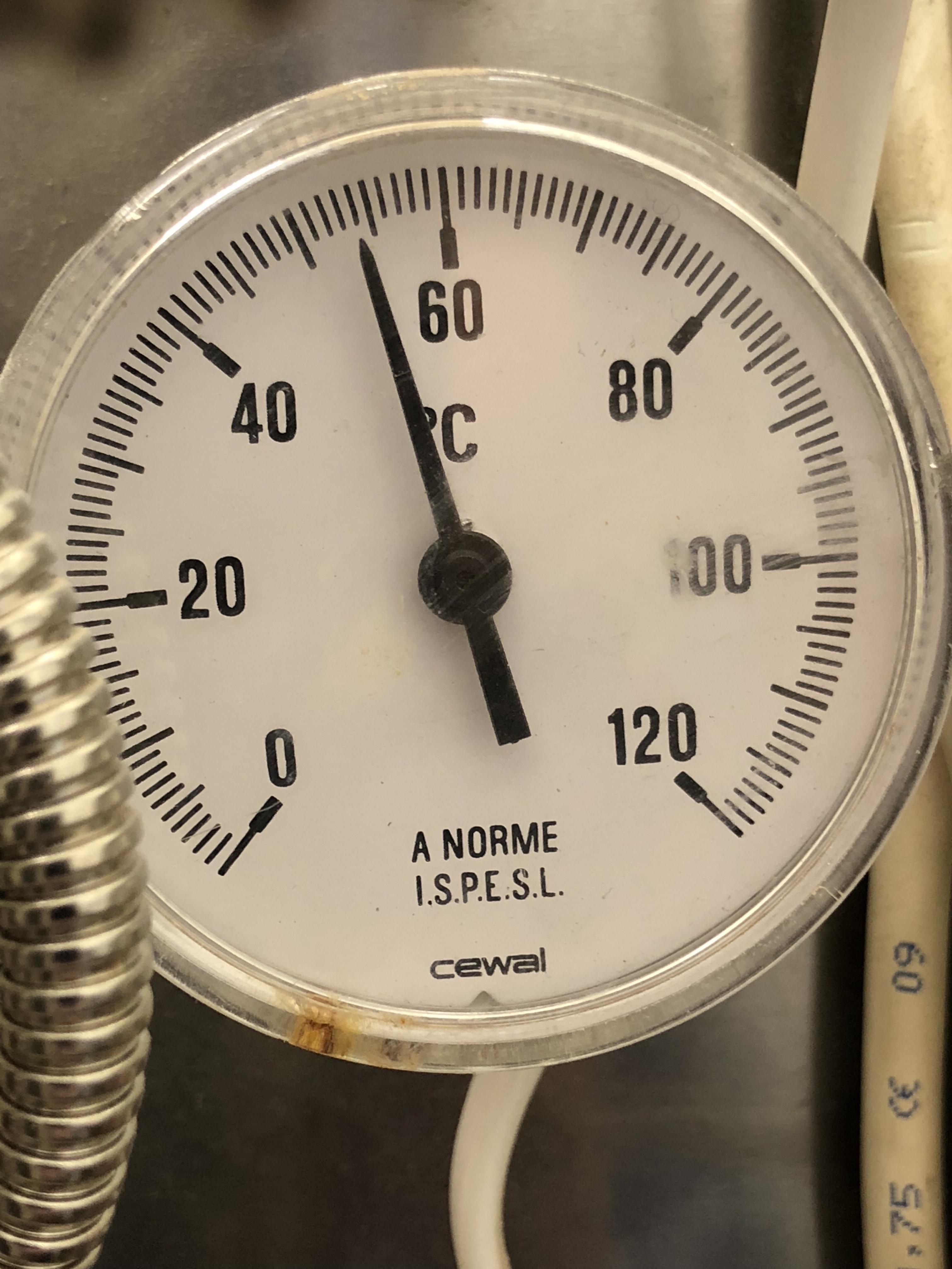

newhome Posted February 25, 2018 Author Posted February 25, 2018 On 2/22/2018 at 22:40, MikeSharp01 said: Do we know the fluid temperature circulating round the boiler / plate heat exchanger circuit is that at 70ish? Just pointed the thermometer at the PHE. Reads 55 which is about the same temp as the TS which is 54, and a lot less than the boiler setting which is 75. Not sure if any of that is relevant
SteamyTea Posted February 25, 2018 Posted February 25, 2018 When you take the TS temperature, are you finding a bit that is exposed i.e. no insulation covering it?
newhome Posted February 25, 2018 Author Posted February 25, 2018 1 minute ago, SteamyTea said: When you take the TS temperature, are you finding a bit that is exposed i.e. no insulation covering it? I'm not taking it at all - I'm reading it off the temp gauge
SteamyTea Posted February 25, 2018 Posted February 25, 2018 Right, well assuming the gauge is good, that should be OK 1
newhome Posted February 25, 2018 Author Posted February 25, 2018 Just now, SteamyTea said: Right, well assuming the gauge is good, that should be OK Given the rest of this system who bloody knows!! 1
PeterW Posted February 25, 2018 Posted February 25, 2018 10 minutes ago, newhome said: Just pointed the thermometer at the PHE. Reads 55 which is about the same temp as the TS which is 54, and a lot less than the boiler setting which is 75. Not sure if any of that is relevant Can you point it at the pipe coming out of the boiler ..?? I have a suspicion ....
dpmiller Posted February 25, 2018 Posted February 25, 2018 apply some black magic marker or the like to the pipe (or the shiny PHE) first, as clean copper doesn't give a good reading. 1
newhome Posted February 25, 2018 Author Posted February 25, 2018 5 minutes ago, PeterW said: Can you point it at the pipe coming out of the boiler ..?? I have a suspicion .... I'm not sure this thing works properly on pipes as my hand says its reading is shite (says it's only 30 something and no way is that right). The pipe going into the boiler (well there are 2 pipes from the boiler joining the PHE) are hotter than putting my hand on the PHE. Quite a bit hotter but not as hot as the green pump marked 'up'. Maybe slightly hotter than the silver upside down pump which shows 64. I can leave my hand on the PHE with a reading of 55 but no way can I leave my hand on those pipes. So at a guess I'd say 70 ish.
newhome Posted February 25, 2018 Author Posted February 25, 2018 (edited) 2 minutes ago, dpmiller said: apply some black magic marker or the like to the pipe (or the shiny PHE) first, as clean copper doesn't give a good reading. Ha ha - I should have read this first. Thank you! What's a black magic marker - sounds like some spell Edited February 25, 2018 by newhome
SteamyTea Posted February 25, 2018 Posted February 25, 2018 10 minutes ago, newhome said: What's a black magic marker A felt tip pen that you can sniff when there is nothing else. 70°C is about as hot as a dry hand can stand.
newhome Posted February 25, 2018 Author Posted February 25, 2018 7 minutes ago, SteamyTea said: A felt tip pen that you can sniff when there is nothing else. 70°C is about as hot as a dry hand can stand. Thanks! I will go in search of the markers with the nice smell. I know the ones you mean - a bit addictive . 98 was way too hot for my hand! That pump is reading over 100 today and I just burnt myself on it again. You know how you have to touch something 'just to check' 1
newhome Posted February 25, 2018 Author Posted February 25, 2018 Permanent markers I have here have made no difference. Anything else I can put on the pipe?
