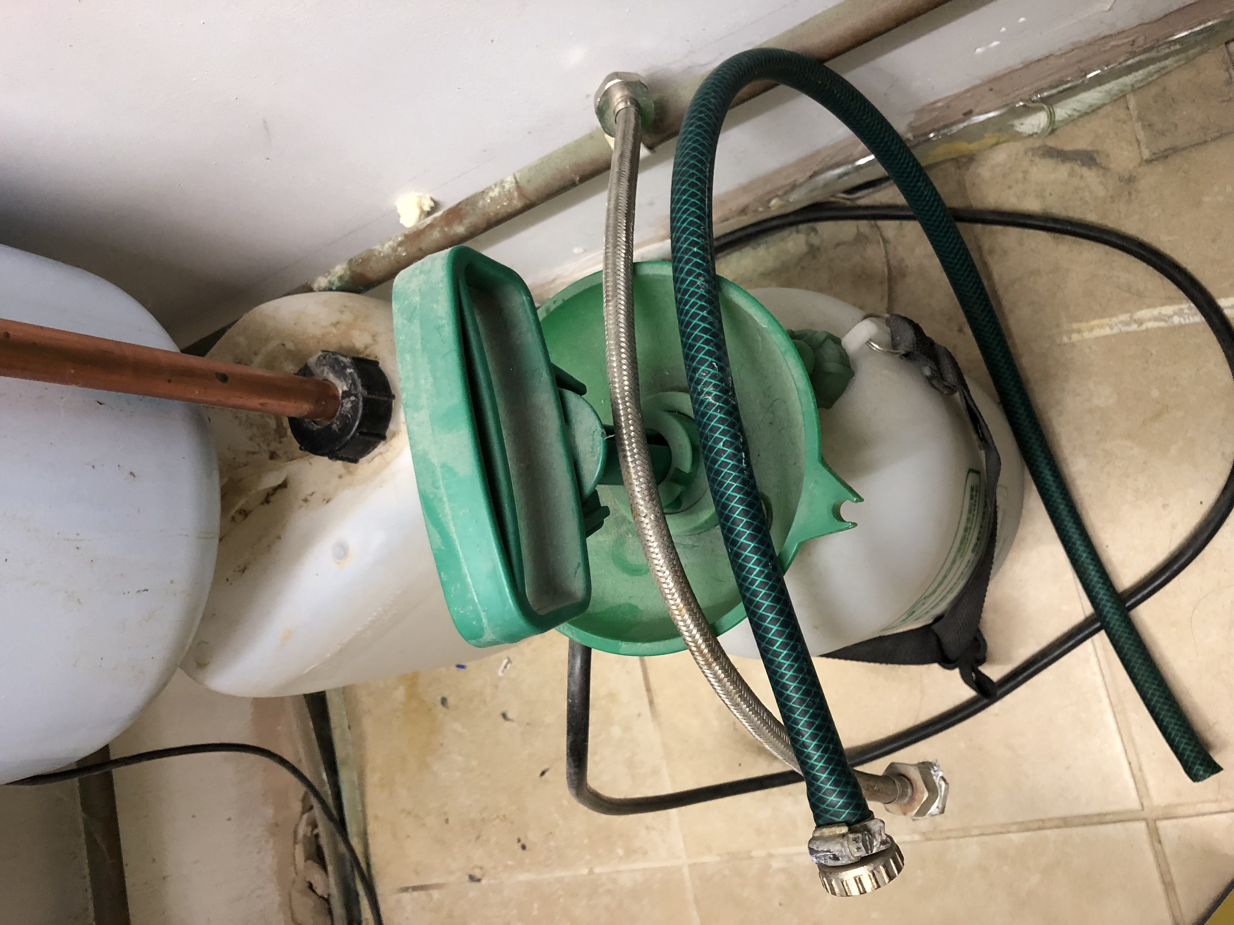

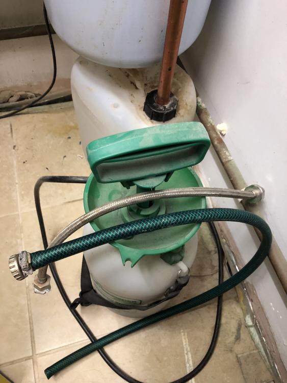

@JSHarris. Would the glycol / other turn to jelly? I've not seen that before. There is a top up point which shows the ST system can be repressuirsied with ease, just needs the hozelock pressured pump up bottle and some more so,union made up and it may come back to life by itself.
I can't remember how these panels get bled of air. Do they usually have automatic air vents at the top of the solar collectors or is it a manual job?
Shouldn't do, unless the system has been boiling for a long time and has vented off all the steam.  Even then it should flush clean OK.  AAVs are normal, as is a PRV to allow steam to blow off if they boil.  Shouldn't happen normally, as they reach stagnation temperature and just sit there, assuming the controller is working.
If you look at the pic of the panels on the roof there is a solar rated (silver) bottle air vent there to help bleed the system. IMO these are a failure point (even the solar rated ones) as during stagnation the temps can exceed what they are rated to anyway. It's usual to bleed the air during commissioning using a pump to push the fluid into and around the circuit and back out again into a vessel like a bucket to get the air out. Some dissolved air can appear but over time but its not usually enough to bother about.
I’ve got this I think. It’s sitting next to the solar bottles.
