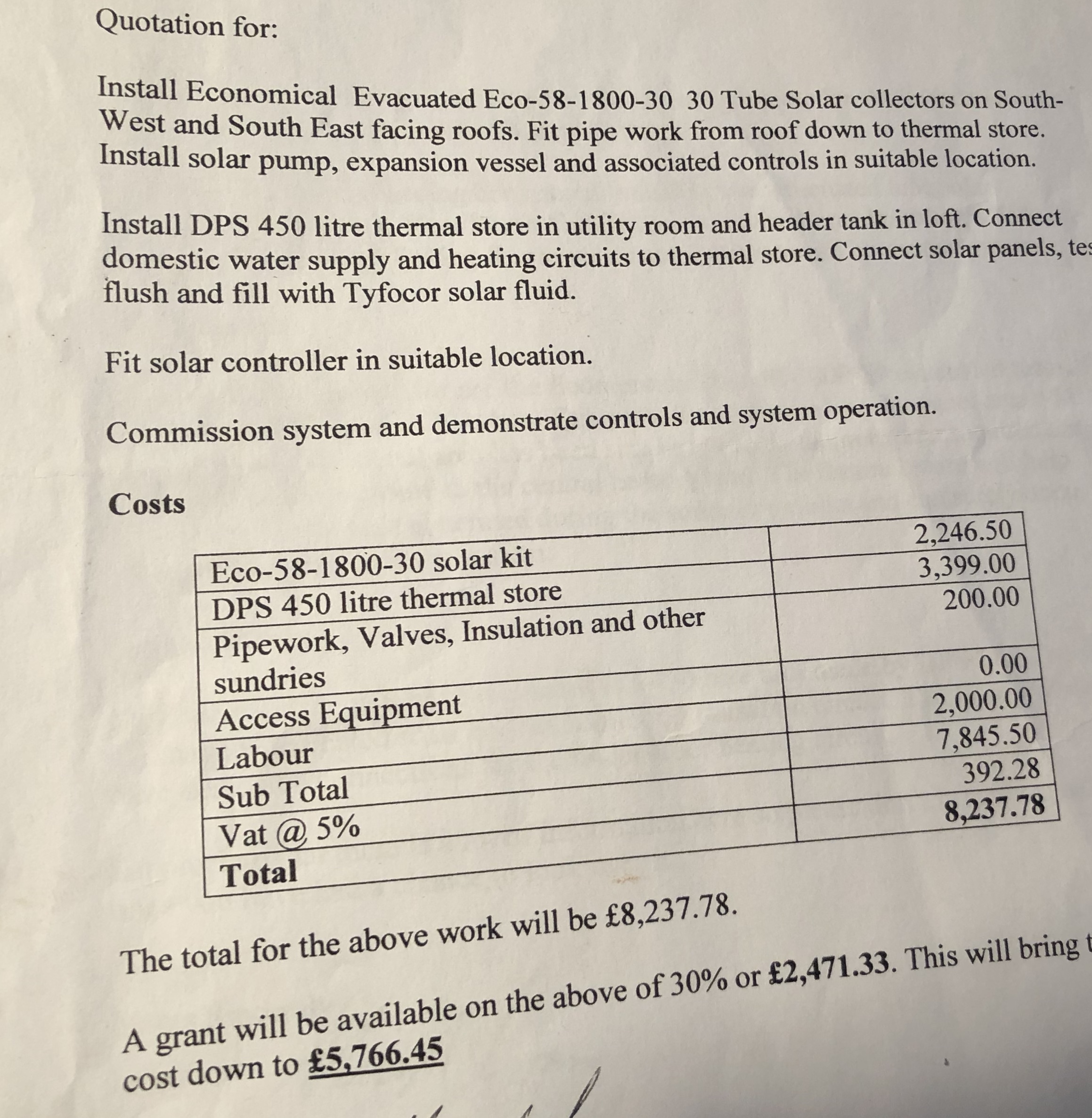

I found the original quote from solar guy. I didn’t know he’d quoted for the TS too originally. Terry sourced it from DPS direct in the end by the looks of things. The installation quote was interesting as it was 2k for installing the TS too whereas he took the entire grant money just for installing the solar kit later on. Assume the solar fluid is what he used when he did install it though and that it’s the ‘normal’ stuff used?
