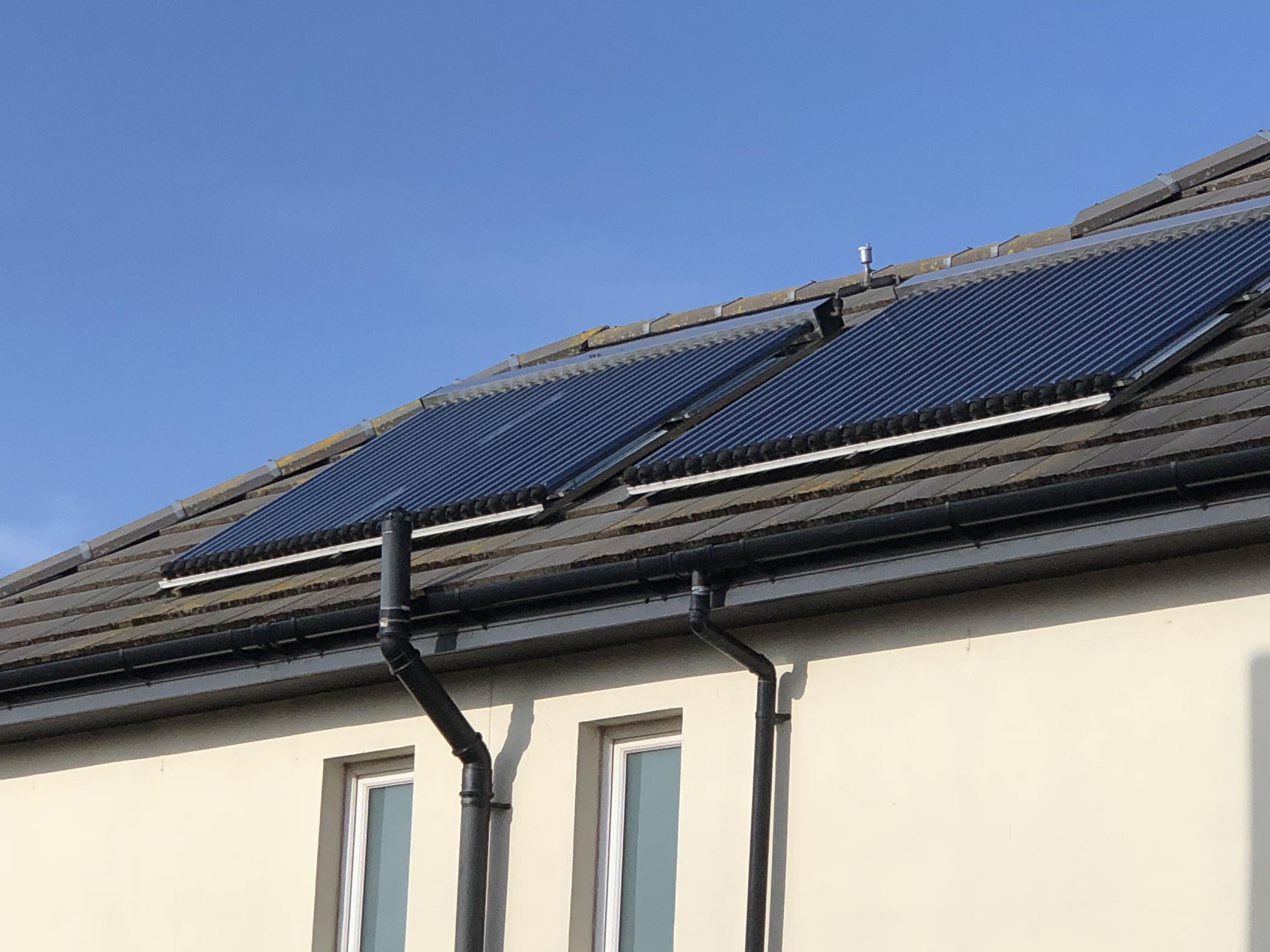

There's a picture of the first panel frame in situ on the blog, probably doesn't help much, but tells you it's a roof mounted system. The collectors are 30 x 58mm evacuated tube types.

More info on the solar. Photo of panels and details of current settings on the solar controller (except the time, which is wrong. It thinks it’s the middle of the night)
Column 117.3
TST 22.3
S3 52.5
n % 100
hP 7422

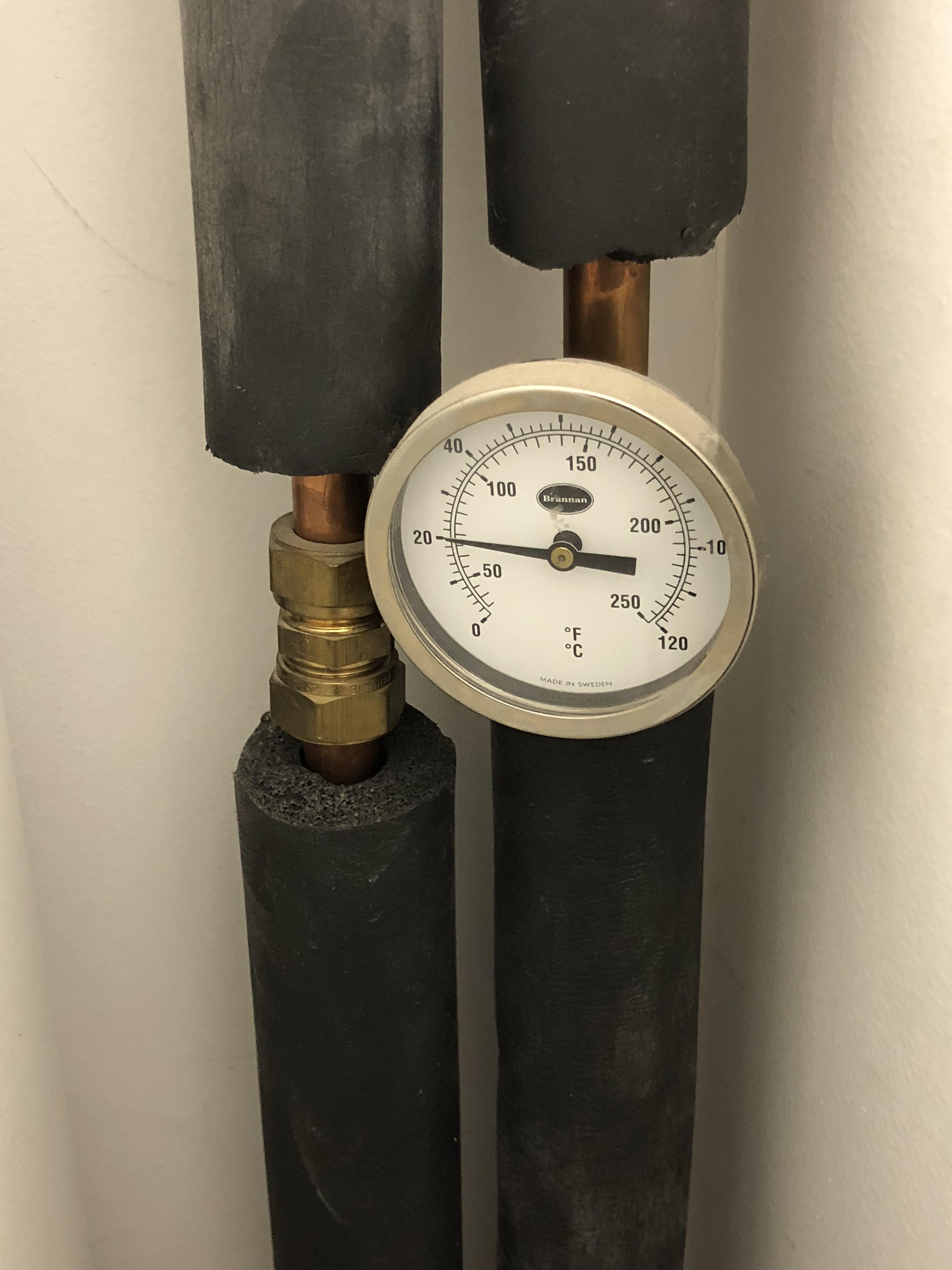

And I checked the temperature of the pipes in the location in the photo as I could get to the pipes there. I’m sceptical tho as one felt a bit warmer than the other, and not just a tiny little bit. 27.6 and 24.4. The temp gauge shows lower.
And the pump shows 55.
I think Column 117.3 is the panel temp. Could easily be so if it's sunny and not circulating fluid. I would just turn it off. It needs fixing with tools now :)

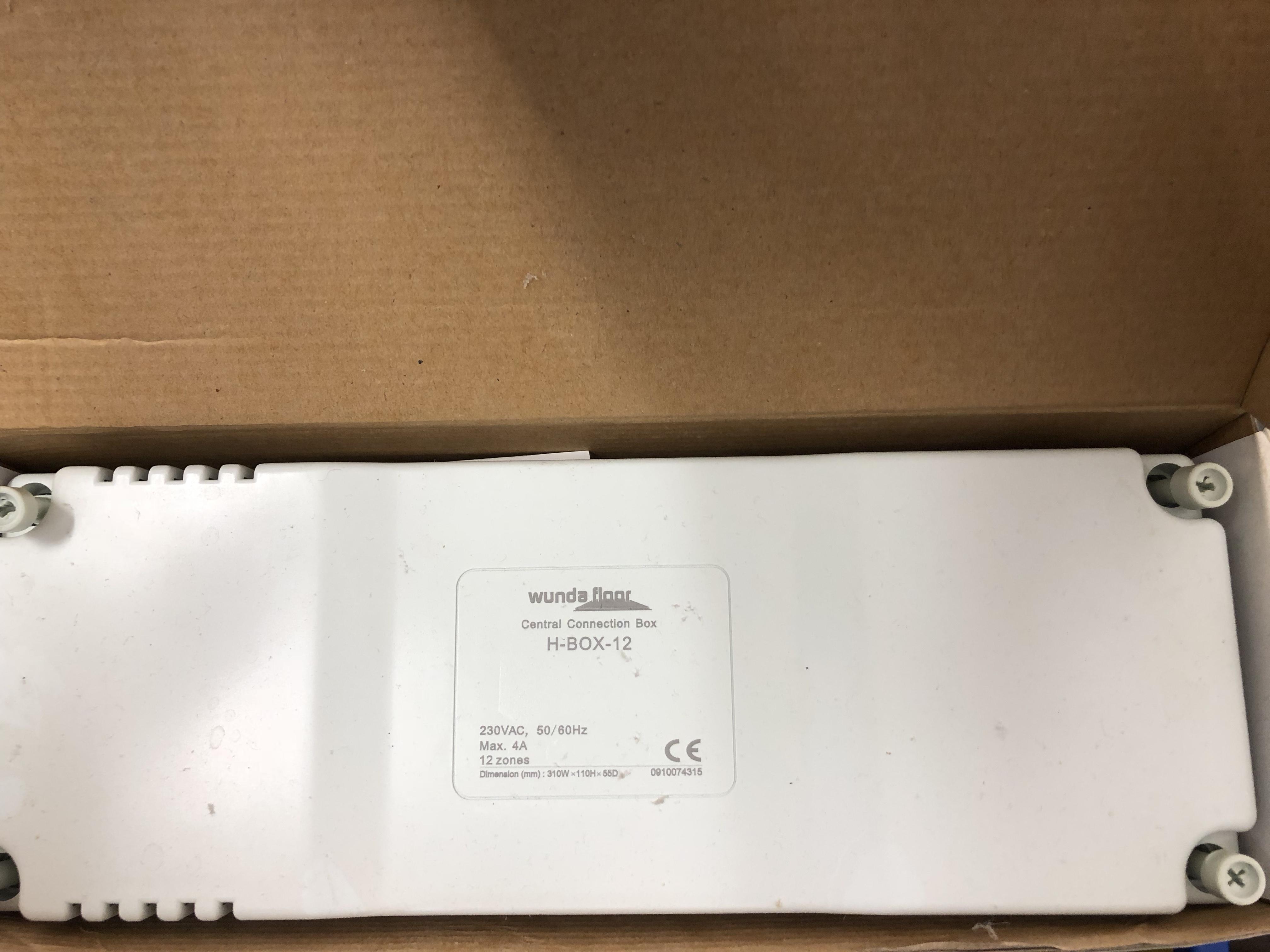

I also found the following on the top of the TS! The thing in the photo still in its box, 2 manuals, and a plastic thing that says Resol SP 10!  O.o  Oh and shit loads of dust! :$

That's a wiring centre for the UFH:
E07-Generic-H-Box-12V1.2-wiring-centre-09-10-2017.pdf

One thing I noticed in the picture of the HM box is the "boiler demand" is not connected.  The boiler demand would in this case normally turn on a circulating pump and possibly open a motorised valve to allow heat to go from the tank tot he UFH.

Thanks. One hopes it was redundant rather than 'missed'!! :S
