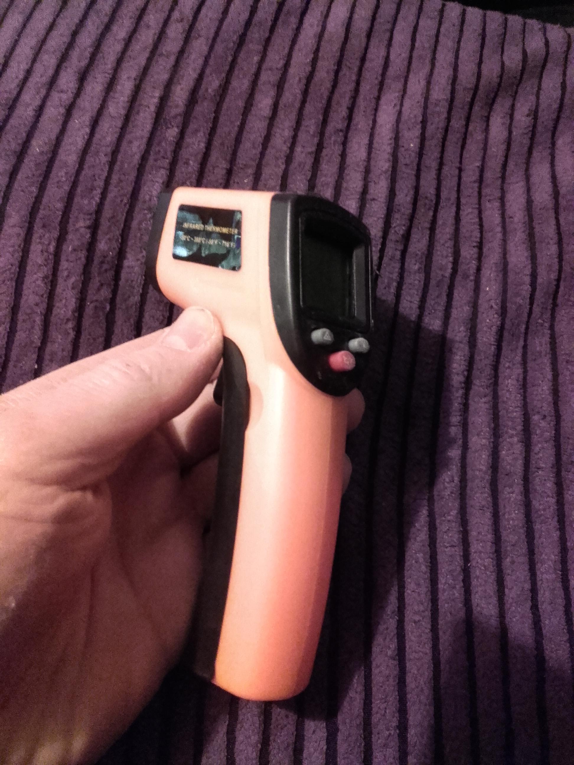

Hmmm...accuracy on those cheap laser IR thermometers. I think mine was a fiver off eBay.
An inch from the radiator, 37deg. Stand back 10' and point at the same spot and it's reading 30deg.
It is at least useful if measuring components for comparitive purposes as long as you do it from the same distance.
Edited by Onoff
Mine was a tenner from Amazon (Prime so delivered next day). It doesn't seem that sensitive to distance as long as I'm in reasonable striking distance, but it won't read those copper pipes with any accuracy.

The black marker pen or dab of black high temp paint should help. With the pen a couple of goings over might be needed. The problem is the laser reflecting off the shiny surface.

laser's nothing to do with it, it's only a sight.

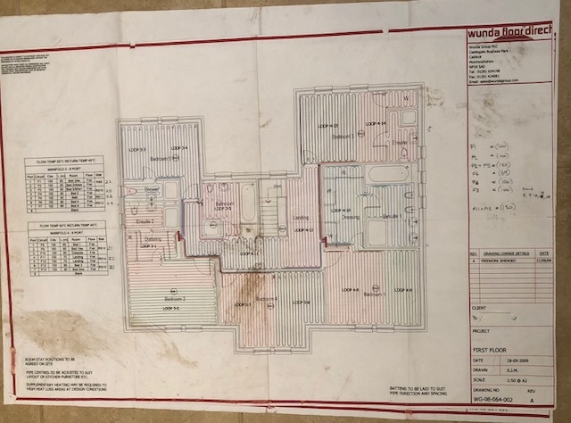

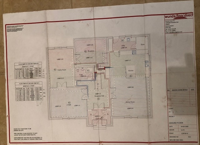

@PeterW and @Nickfromwales must be making progress as they've asked me for the UFH plan. That's a big step on from the shite that is my TS / boiler / solar set up!
Here are the plans (assuming readable - they are old and grubby)
Now unless I am going blind ... where is the TS and Boiler on that plan ..??!

Whilst a powerful enough laser might well burst a balloon, my point was that the laser aint part of the IR measuring system...
When using an IR thermometer (strictly speaking it's a bolometer) then there are a few things worth noting down.
Firstly, as already mentioned, the laser pointer has nothing to do with the measurement, it's just a guide as to roughly where to point the thing, and is extremely inaccurate when used close to the thing you're trying to measure.  If you look at the business end (with the laser OFF) then you will see that the laser is offset from the conical black hole that has the bolometer sensor at the bottom of it.   When using it close to a pipe, then line up this hole with the pipe, don't use the laser guide.
Secondly, the bolometer is calibrated for a specific surface IR emissivity, usually around 0.9.  Shiny surfaces may be as low as 0.1 or less, so will very seriously under-read.  Ideally, paint the surface to be measured with something like a thin coat of white or grey matt paint, as that will have a surface IR emissivity that's pretty close to 0.9.
Finally, the further away you are from the thing you are trying to measure, the larger the area that the sensor will "see".  It will effectively average the temperature over the whole area it "sees" which may well also make it under-read when measuring small, hot objects.
Try and place the measurement aperture as close as possible to the object you want to measure and try to make sure that object has an emissivity as close to 0.9 as possible and you should get a reasonably accurate measurement.  As  guide, here is a link to the surface emissivity of some materials: https://en.wikipedia.org/wiki/Emissivity#Emissivities_of_common_surfaces
My bollockometer came with a little chart that showed the accuracy at different distances and how large the sample area is.
