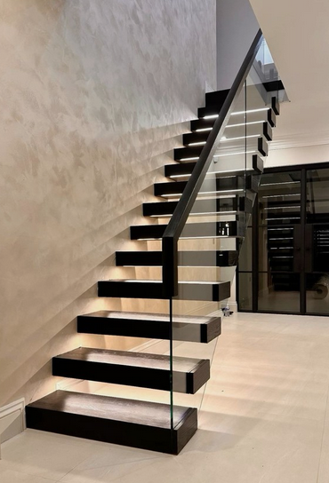

Gus Potter Posted September 7, 2025 Posted September 7, 2025 10 hours ago, flanagaj said: In fact, given we want an industrial look to the entrance hall, it might actually be a better option. Does this sort of thing float your boat, it's stand alone, you can make it as industrial as you like. I made a post earlier about your cantilever stair but what about this.. it can be free standing? The great thing about these is that the steelwork is not too expensive, they get churned out by fabricators day in and day out and depending on your budget you can pick and choose the treads depending on how much money you have left as you near the end of the build. @markc earlier knows a lot about this kind of stuff and how you fabricate them so have read back on his posts. He has talkedf about in past about how these type of stairs twist a bit due to welding heat an so on.. but that comes with the "industrial look" BIG point.. these types of stairs need a strong support at the top and bottom (to stop twisting) so you need to plan for that early on. Good thing is that you install near the end of the works to mitigate damage risk. SE wise they are easy to design but the connections at particularly the top need some thought as you need to get the stairwell trimming sorted out so it take the twisting (stair torsion). The bottom conection is often easy as you have a base plate that can take some twisting. There are lots of posts on BH where folk have discovered late in the day that their stair top trimming is lacking strength and robustness and that causes lots of grief. These stairs can look great! You have the tread detail, then how you do the steel paint finish, how much you want the welds finished, the balluster / glass detail. You have many options from high end to totally industrial look.. rough as.. The best advise I can give you as a past self builder and designer is make your mind up now about the way the stair is going to work structurally. Build the support structure in and then as you near the end of the job see how how much you want to spend on the stair finishes (glass, quality of the treads etc) and how that fits with the other budget constraints you discover as you have gone along. It's a hard decision as the stair is a main feature of the house.. the first thing folk see when they come in, been there and worn the tee shirt.
Gus Potter Posted September 7, 2025 Posted September 7, 2025 To add a bit. How industrial do you want say the welding to look if going for the stair in my last post? @ETC here we are considering the important detailing and finish. How that interacts with the tread appearance, the balluster and so on, even the pitch and tread length of the stair is important to get an appealing looking stair which is often a main feature of the house. @flanagaj as an SE so long as the welds have an adequate strength then all is good. But the ripple weld is more industrail.. good steel fabricators can do both and all you need to do is tell them, please do this type of weld. Next is paint finishes (if any, could be a clear varnish but we need to check the fire protection) and what goes well with timber treads and balustrades. All this does not need to cost the earth but to get best value it takes thought time. You have enough on your plate to get your self build underway but the KEY is pick the structural design of your stair in the context of what you need to build now and then have fun later on the detailing and choice of glass or what ever handrail / glass and so on you want. Don't forget that your design may evolve and what you are thinking now may change.. keep your options open, appreciate that this is one of the benefits of self building. What I can tell you from my own experience is that the design will evolve so try not to tie your own hands too much at the moment. Last thing is don't forget the building regs.. any gap roughly needs to be less than 100mm! So a lot of these stairs you see are non compliant including the one I posted above!
flanagaj Posted September 7, 2025 Author Posted September 7, 2025 44 minutes ago, Gus Potter said: Does this sort of thing float your boat, it's stand alone, you can make it as industrial as you like. Unfortunately, they are not my thing. I don't like the central spine. I am now contemplating cast concrete stairs, but if that comes with it's own requirement regarding having to have a special concrete floor as opposed to sitting on the 150mm slab we have proposed, then it might be back to the drawing board.

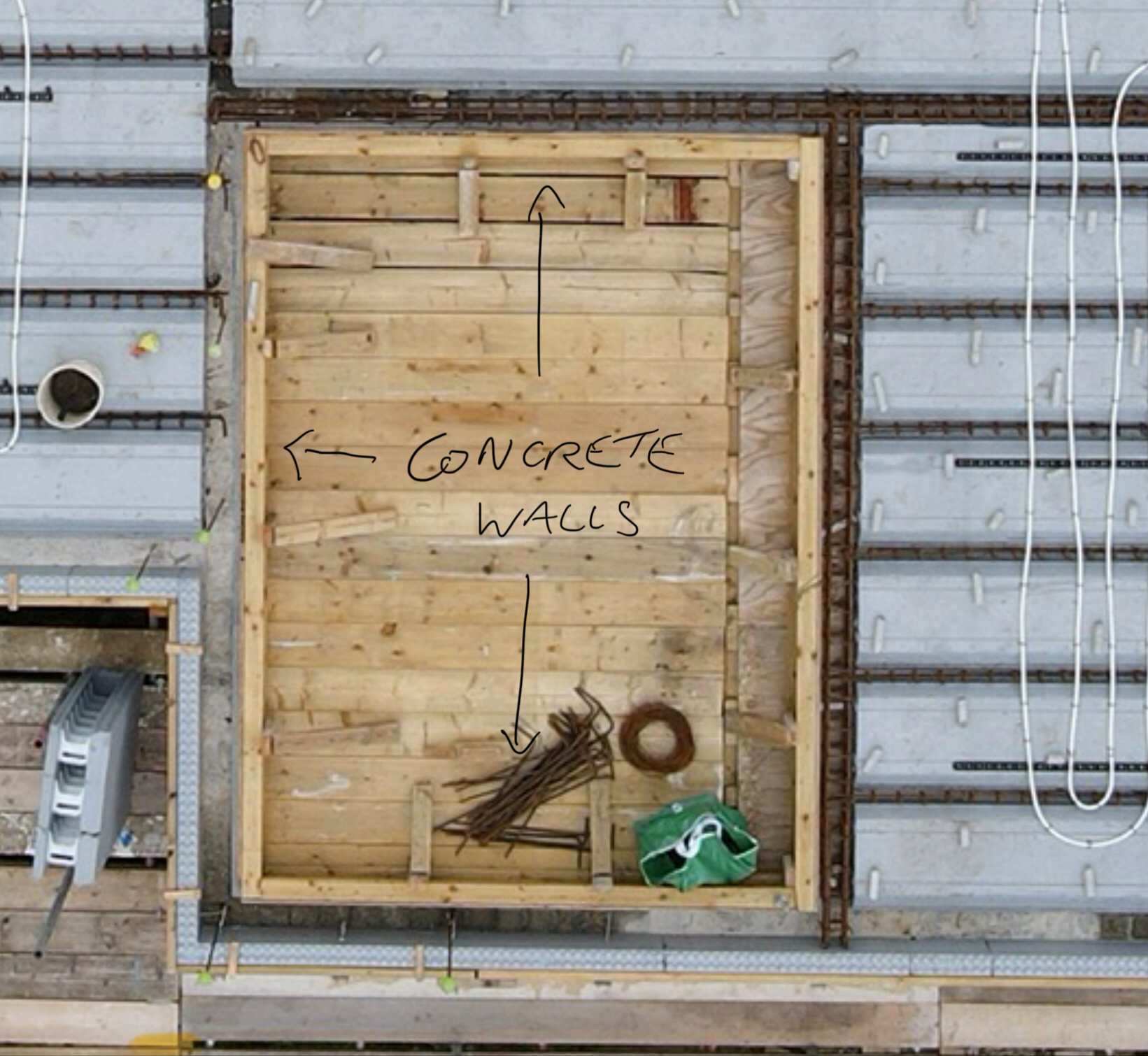

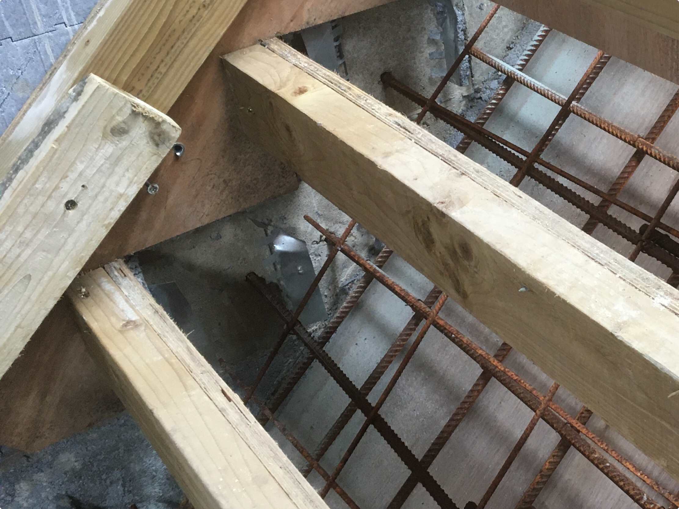

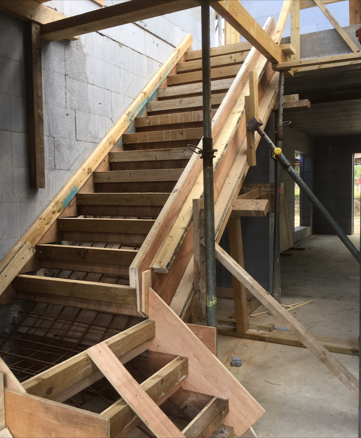

ETC Posted September 7, 2025 Posted September 7, 2025 2 hours ago, Nick Laslett said: I have concrete stairs and a concrete first floor. The foundation design will need to accommodate a concrete stairs. My structural engineer needed to know the stairs design, before he finalised the foundation design. We needed an additional concrete pad under the insulated raft at the bottom of the stairs. I did investigate Millbank for pre-fabricated stairs, but the ICF guys built the form work for the stairs in-situ, and poured the concrete the same time as the first floor walls. https://www.milbank.co.uk/products/stairs/stairs-and-landings/ For me, concrete first floor and stairs were an integral part of my design requirements from the beginning, even before deciding to go with ICF, which actually made it much easier. The ICF guys did my stairs at no additional cost, which was very generous of them. Here are some other links I have from my early research. https://www.ejbformwork.co.uk/in-situ-concrete-stairs/ https://midwest-stairs.co.uk Picture of the form work for our stairs. That looks like an awful lot of work. 1

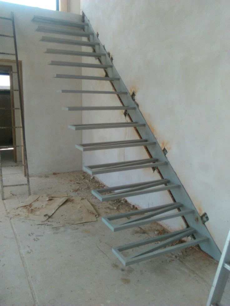

flanagaj Posted September 7, 2025 Author Posted September 7, 2025 2 minutes ago, Gus Potter said: So you have precast treads... do you envisage these being cantilevered? Cantilevered would be the ultimate aim. But it's achieving that without breaking the bank. My plan was something like the following. Ideally, getting the metal structure to counter the forces being applied as opposed to the wall having to do it. 1
Gus Potter Posted September 7, 2025 Posted September 7, 2025 As a cursory inspection that won't get past a UK SE. The wall fixings into your proposed blockwork will fail drastically and the wall stringer is too flexible. The diagonal tread bracing is a straw man. Keep up with the ideas, something that suits your budget will come to light. How much have you allocated in your budget for the stair? 1
flanagaj Posted September 8, 2025 Author Posted September 8, 2025 9 hours ago, Gus Potter said: How much have you allocated in your budget for the stair? Ideally, no more than 7K
Russell griffiths Posted September 8, 2025 Posted September 8, 2025 That picture is only showing half the story, the flex in those hollow steel sections will be immense. that staircase will have a glass balustrade to take the flex out at the far end. im obviously not a structural engineer, but just look at that picture, there is not a hope in hell of those steel outriggers holding a man’s weight if he was to stand on a single tread at the furthest point from the wall. be carful of pictures taken halfway through a job. 1
saveasteading Posted September 8, 2025 Posted September 8, 2025 Precast stairs are great for car parks and heavy industrial use and for fire resistance. Esp if integrated with a precast structure. Last time I used them, the geometry was set so there were limitations on dimensions and the rake. They need wall or beam support at the top. If I wanted concrete stairs in a house they would be in-situ as the photo above. They will still need support at the top. 1
Nick Laslett Posted September 8, 2025 Posted September 8, 2025 (edited) 6 hours ago, saveasteading said: Precast stairs are great for car parks and heavy industrial use and for fire resistance. Esp if integrated with a precast structure. Last time I used them, the geometry was set so there were limitations on dimensions and the rake. They need wall or beam support at the top. If I wanted concrete stairs in a house they would be in-situ as the photo above. They will still need support at the top. As @saveasteading says, you need some specific preparations for concrete stairs. We have 150mm thick concrete ICF walls on three sides of our stairs. The distance between the walls sets the rake. Rebar goes into the side of the wall as the stairs go up. Edited September 8, 2025 by Nick Laslett

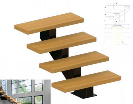

Gus Potter Posted September 10, 2025 Posted September 10, 2025 (edited) For a bit of fun and some sums. The above won't fly as others have pointed out, but let's see if a floating stair like below might work conceptually in a 100mm thick concrete block wall 2.4m high with no significant compressive load from above. Say the wall has a door opening and thus the wall is only able to span vertically top to bottom. Before we do any detailed design we want to look to see if is it in anyway possible. Say the stair is 0.9m wide and its a domestic stair. The imposed (live load) is 1.5 kN/m squared, from the design codes. That roughly covers you say taking a big family photo when everyone gathers on the stair. Now this is an area load so let's convert that to a line load applied up the centreline of the treads. 1.5 kN/m^2 * 0.9m = 1.35 kN/m per metre run horizontally. The line load acts at a distance of 0.9m / 2 from the wall = 0.45m. Now we can calculate the bending force that is applied to the wall, say half way up the stair by going 1.35 x 0.45 = 0.61 kNm per metre run of wall. And now lets apply the Eurocode factor of safety to that of 1.5. The design moment is 1.5 x 0.61 = 0.915 kNm which is the factored bending force applied to the wall. Now say the wall is built from 100mm dense 7.0 N/mm sq blocks in an M4 mortar. Once you do a few calculations you see the bending strength of the wall is about 0.175 kNm per metre run which is a lot less than 0.915kNm . We stop there as there is no point in calculating the self weight of the stair and glass balustrade as this just adds to the bending force. What happens if we make the wall out of block on the flat so the wall is 215mm thick? Well the resistance of the wall jumps to about 0.6 kNm still short of our 0.915 kNm, no self weight etc has yet been included. Now if we add another story of wall above this increases the compressive load in the wall which stops tension developing at the mortar beds which increases the bending strength of the wall (up to a point). Let's add another 2.4m of 215mm thick wall above. So that's a line load on the top of the wall = wall density x thickness x height = ~20 * 0.215 * 2.4 = 10.3 kN per metre run of wall. If we recalculate the bending strength of the wall we get about 0.95 kNm which is more than our 0.915kNm. Ok we are closer but once we take the detailing into account, self weight of the stair, balustrade etc we are on the wrong side of the equation again. In summary, you can see if we do a qualitative analysis like this we are going to have to do a lot of work to get a blockwork wall even in a two story dwelling to work and then we have to detail for not least shrinkage, build, course and bond it all properly. Even if we change the tread material is still does not get rid of the bending force in the wall. Now what happens if we change from 7.0 N concrete block to Engineering brick 215 mm thick 2.4m high with no wall above. Well, now things look more promising. A wall like this has a bending strength of around 1.45 kNm per metre run > our 0.915 kNm so now we maybe want to look to see if we want to do a bit more work by calculating the self weights , stair tread deflection and so on. It's going to be close and and may not work, but even if it does then you still have to build it and bond in the treads somehow. All this kind of leads you towards not using masonryin this kind of construction and to consider a steel based option for the wall as @Nickfromwales suggested. Edited September 10, 2025 by Gus Potter 2
flanagaj Posted September 10, 2025 Author Posted September 10, 2025 11 minutes ago, Gus Potter said: For a bit of fun and some sums. The above won't fly as others have pointed out, but let's see if a floating stair like below might work conceptually in a 100mm thick concrete block wall 2.4m high with no significant compressive load from above. Say the wall has a door opening and thus the wall is only able to span vertically top to bottom. Before we do any detailed design we want to look to see if is it in anyway possible. Say the stair is 0.9m wide and its a domestic stair. The imposed (live load) is 1.5 kN/m squared, from the design codes. That roughly covers you say taking a big family photo when everyone gathers on the stair. Now this is an area load so let's convert that to a line load applied up the centreline of the treads. 1.5 kN/m^2 * 0.9m = 1.35 kN/m per metre run horizontally. The line load acts at a distance of 0.9m / 2 from the wall = 0.45m. Now we can calculate the bending force that is applied to the wall, say half way up the stair by going 1.35 x 0.45 = 0.61 kNm per metre run of wall. And now lets apply the Eurocode factor of safety to that of 1.5. The design moment is 1.5 x 0.61 = 0.915 kNm which is the factored bending force applied to the wall. Now say the wall is built from 100mm dense 7.0 N/mm sq blocks in an M4 mortar. Once you do a few calculations you see the bending strength of the wall is about 0.175 kNm per metre run which is a lot less than 0.915kNm . We stop there as there is no point in calculating the self weight of the stair and glass balustrade as this just adds to the bending force. What happens if we make the wall out of block on the flat so the wall is 215mm thick? Well the resistance of the wall jumps to about 0.6 kNm still short of our 0.915 kNm, no self weight etc has yet been included. Now if we add another story of wall above this increases the compressive load in the wall which stops tension developing at the mortar beds which increases the bending strength of the wall (up to a point). Let's add another 2.4m of 215mm thick wall above. So that's a line load on the top of the wall = wall density x thickness x height = ~20 * 0.215 * 2.4 = 10.3 kN per metre run of wall. If we recalculate the bending strength of the wall we get about 0.95 kNm which is more than our 0.915kNm. Ok we are closer but once we take the detailing into account, self weight of the stair, balustrade etc we are on the wrong side of the equation again. In summary, you can see if we do a qualitative analysis like this we are going to have to do a lot of work to get a blockwork wall even in a two story dwelling to work and then we have to detail for not least shrinkage, build, course and bond it all properly. Even if we change the tread material is still does not get rid of the bending force in the wall. Now what happens if we change from 7.0 N concrete block to Engineering brick 215 mm thick 2.4m high with no wall above. Well, now things look more promising. A wall like this has a bending strength of around 1.45 kNm per metre run > our 0.915 kNm so now we maybe want to look to see if we want to do a bit more work by calculating the self weights , stair tread deflection and so on. It's going to be close and and may not work, but even if it does then you still have to build it and bond in the treads somehow. All this kind of leads you towards not using masonryin this kind of construction and to consider a steel based option for the wall as @Nickfromwales suggested. Thanks @Gus Potter for taking the time to respond with such a detailed insight regarding the bending characteristics of masonry walls and whether they provide the required structural characteristics for a cantilevered staircase. Given a steel structure appears to be the best option, I'm keen to understand more.
Gus Potter Posted September 10, 2025 Posted September 10, 2025 6 minutes ago, flanagaj said: for taking the time to respond My sums are just qualitative and intended to give hubbers an insight into how we quickly determine if something has got a chance of working. There are so many things to think about and ideas you have when self building that often, just seeing how folk like me take a view on things can prevent a lot of runs down blind alleys. The steel option is the next port of call. My approach is to say.. lets see if we can design and fabricate the stair and the wall as one steel assembly, bring it to site and fit it in. Then later, once the dirty work is done,fit the treads. 16 minutes ago, flanagaj said: I'm keen to understand more. Ok allow me to digress. An SE and sometimes CE's are descibed as people who practice the art and craft of Engineering design. Part of the craft (the really fun part for me) of design is often to be able to design within a budget and still make it look Actitecturally appealing and intelligent. But of course appearance is all in the eye of the beholder. Now if (and it's a big if) you have bought into that then next time you are in B & Q in one of their portal frame buildings then look at the rafter to column connection. The tapered haunch is usually fabricated often from a steel I beam cut diagonally.. so you get two tapered bits out of one cut. If you could live with this then what you would see on the underside of your floating tread is a tapered steel section. What you are doing here is marrying up the industrial look with a cantilevered tread. Now here is the clever bit! If you sit the trapered section closer to the front of the tread and detail it you make any gap less than 100mm so it is now BC compliant. Many of the stairs you see on the web are non BC compliant. But if you do it this way then you do get some twisting (torsion) in the treads so you also use the tapered section and fixings to resist that small amount of twisting. My guess is that you can cut diagonally a 152 x 89 UB steel which would give you less than the BC 100 gap. It depends on your choice of tread and material as any fixings need an edge and end distance from the tread. Using a tapered section means that it has greater depth at the wall end and thus the connection here is simplified. So now the idea of fabricating the wall and stair as one work package becomes easier to get your head round. This may not be for you but often design is saying.. hey we looked at that and ruled out. There is no getting away from the fact that if you want any kind of cantilever stair like this it comes at a premium and you have to decide "is this right for us or should we just introduce a stringer to the stair and go for a better quality glass and tread? As someone who does this as a day job then I would, if my own house, on the budget you have, go for a stringer and better quality treads and glass fixings. If you have kids / a dog now or in the furture then go for the most durable tread you can afford as in a few years time, if the treads suffer and start to look bad then any cantilever becomes a moot point. 1
