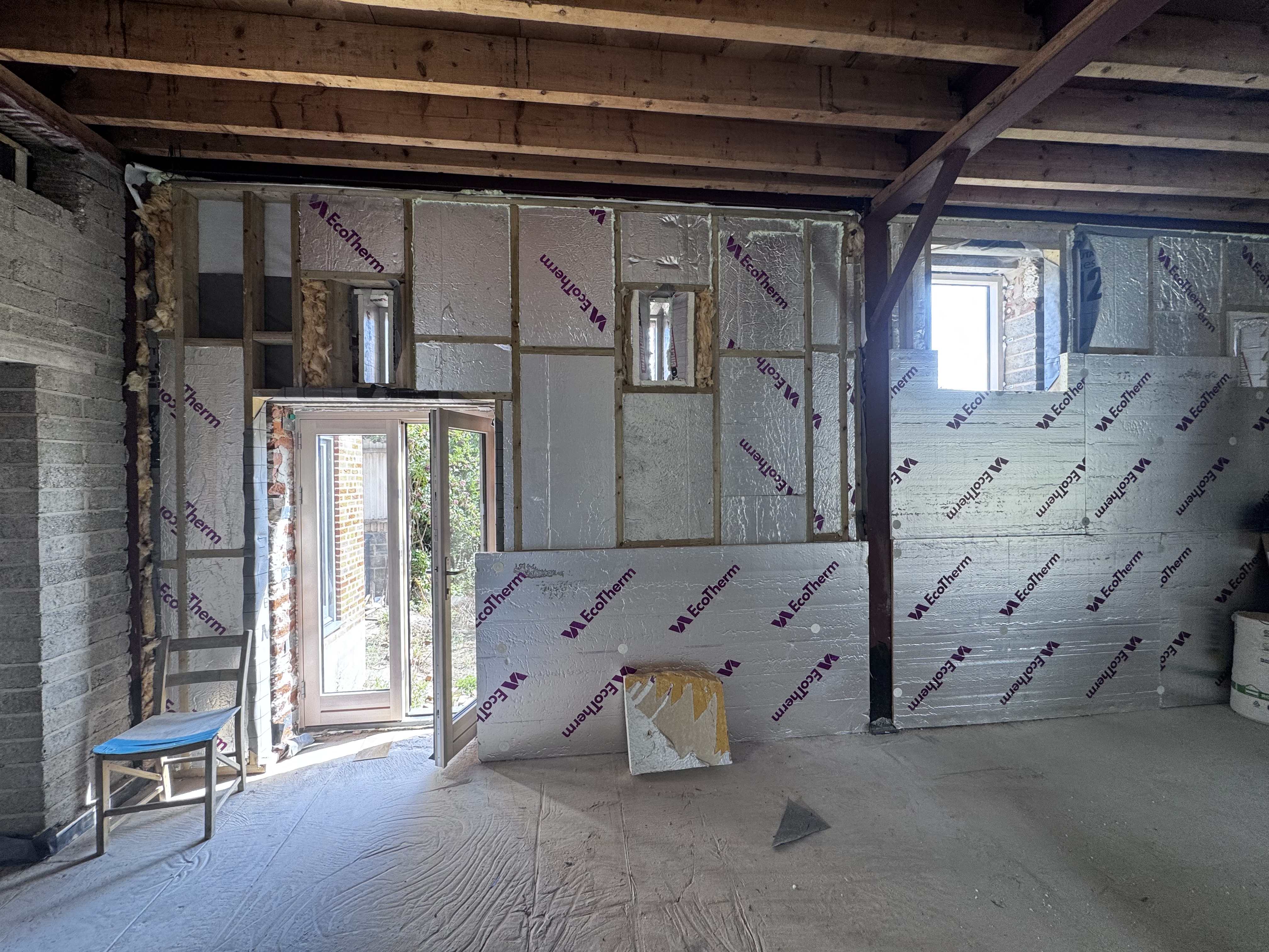

Sounds it. My windows were on time but whilst I had the concept in mind I under thought the solutions for airtight/thermal bridge (or at least didn’t anticipate them to be so fiddly). Such is life. -

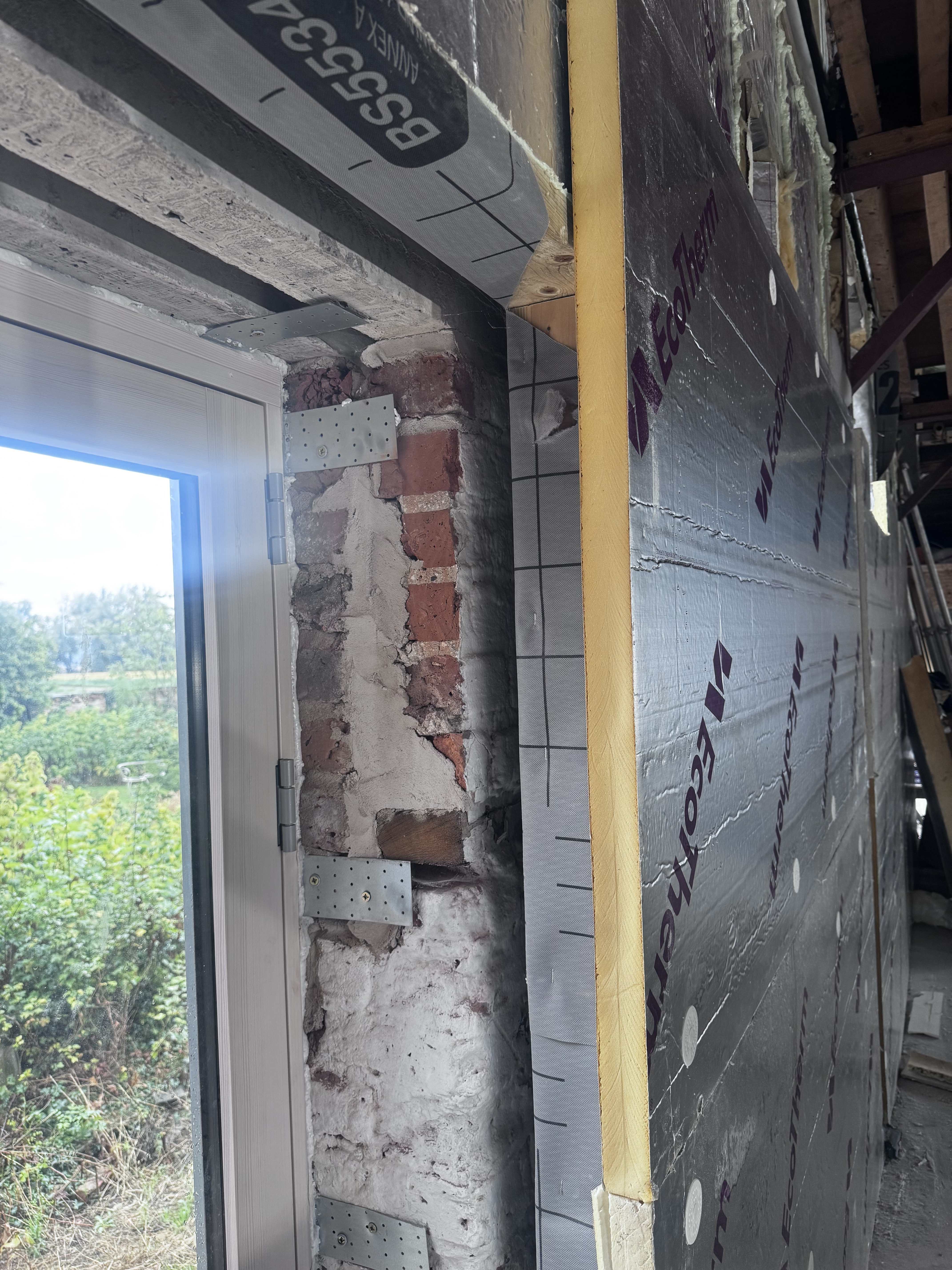

Nice. Looks like different scenarios will likely call for different solutions. They all vary slightly. Very few will I be luck enough to get tucked behind the frame. Most will be abutting. I’ll give feedback in due course -

I see. I have both these products already. Just have a habit of still calling them “silicone”. Thanks for clarity. And bonding compound for drywall not suitable? Tile adhesives is preferred? -

Yes, this is the way. And airtight with silicone/sealant? -

Nice. Looks like I was half way there. Yeah, it’s deceptive but could be at little as 15mm so I was thinking 12 mm marmox and skim. Was hoping to avoid shimming though 🤣 -
Thoughts on a postcard… I have a number of concepts which I’m sure will work but looking for fresh takes on how to take airtight AVCL line from door frame to Iinternal insulation (inner face) - gap circa 415 to traverse but only 20mm or so to work with…. Current lines of thought are to AVCL to frame behind build-up and use jacko/marmox board to form reveal with stop end bead to frame to restrain the board. Seems like a lot of work though. So if anyone has a cleaner solution from experience it’s welcome. Maybe the more slight frames were a bad choice. doesn’t leave much to work with. Problem occurs 13x to varying degrees albeit this is one of the tighter ones
