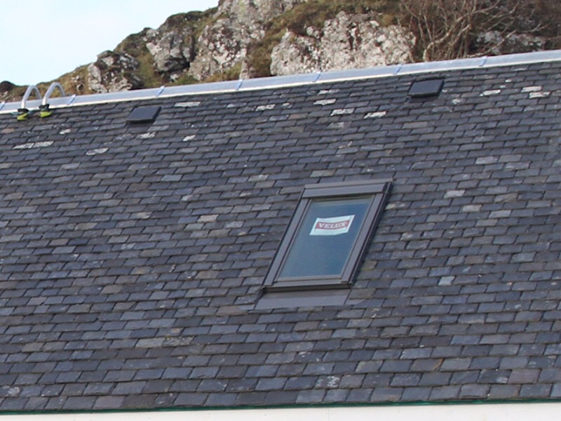

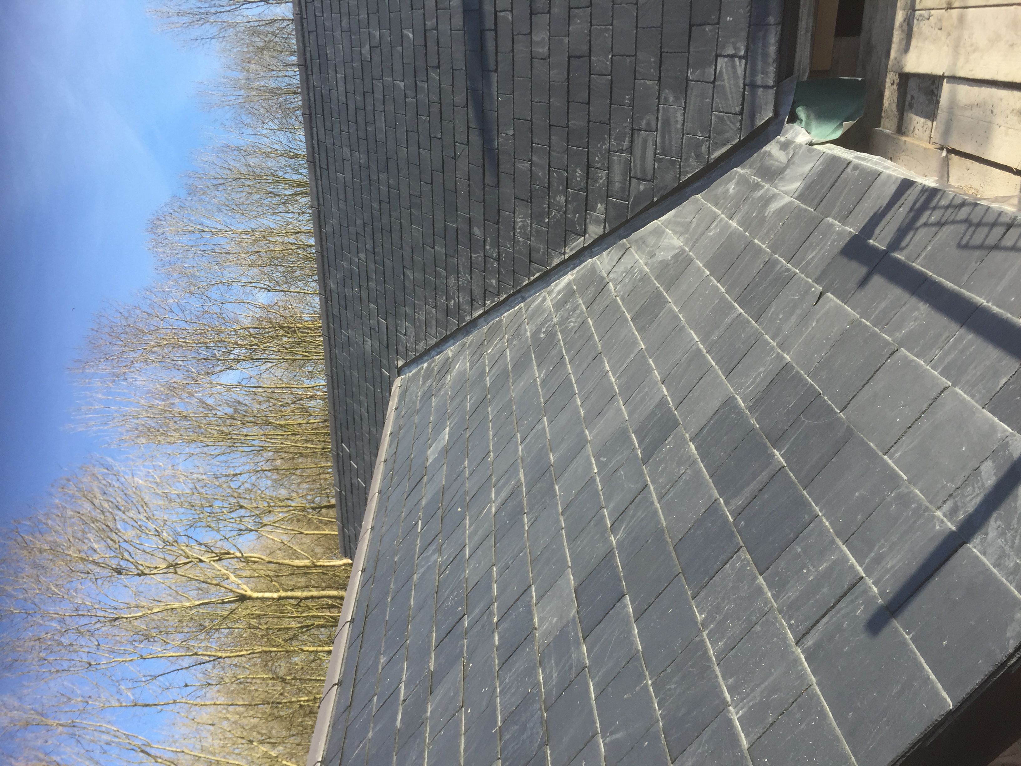

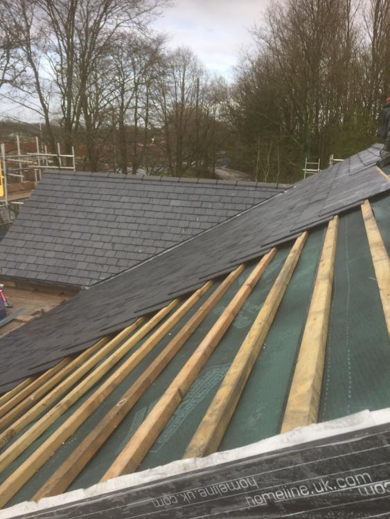

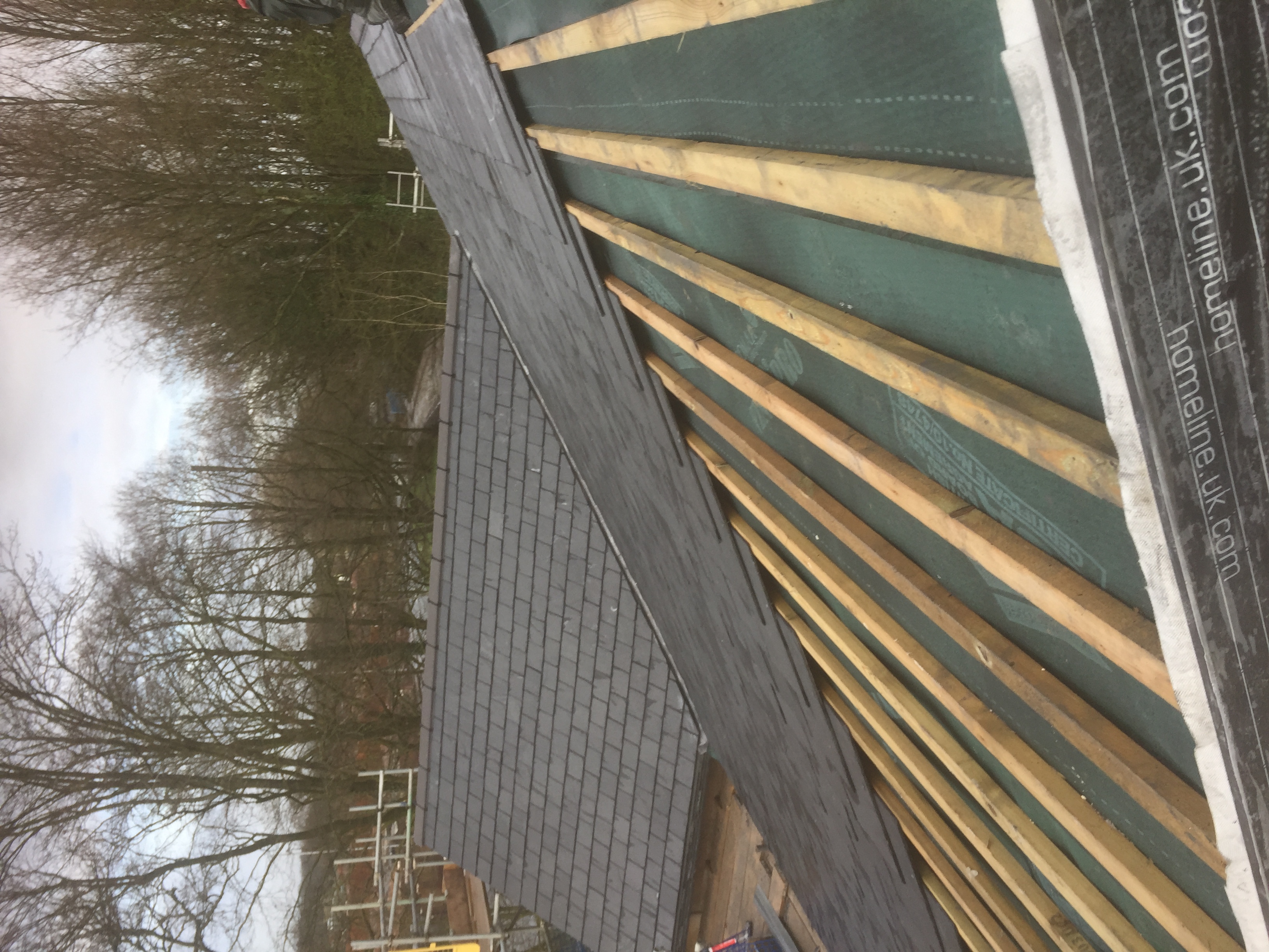

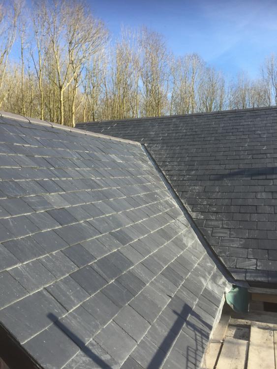

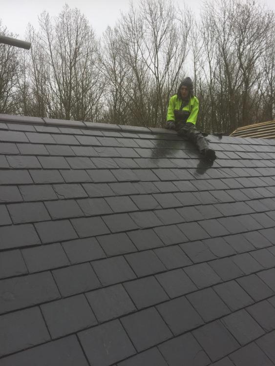

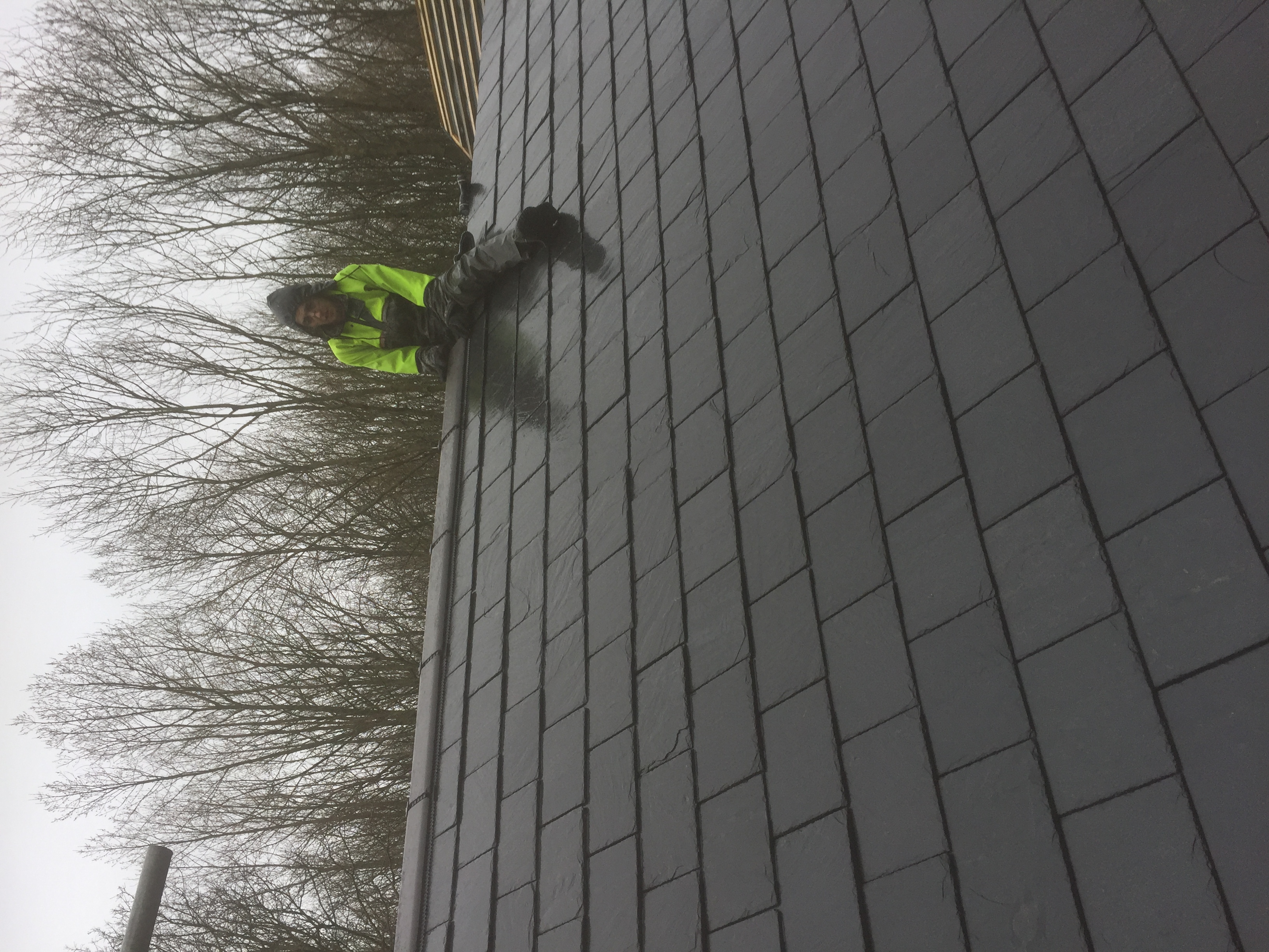

Barney12 Posted December 4, 2017 Posted December 4, 2017 36 minutes ago, Construction Channel said: no reason why you couldnt, Just ask @Barney12 how are you with heights? Yep. You can do it. Here’s my thread: It’s bloody hard work though!
