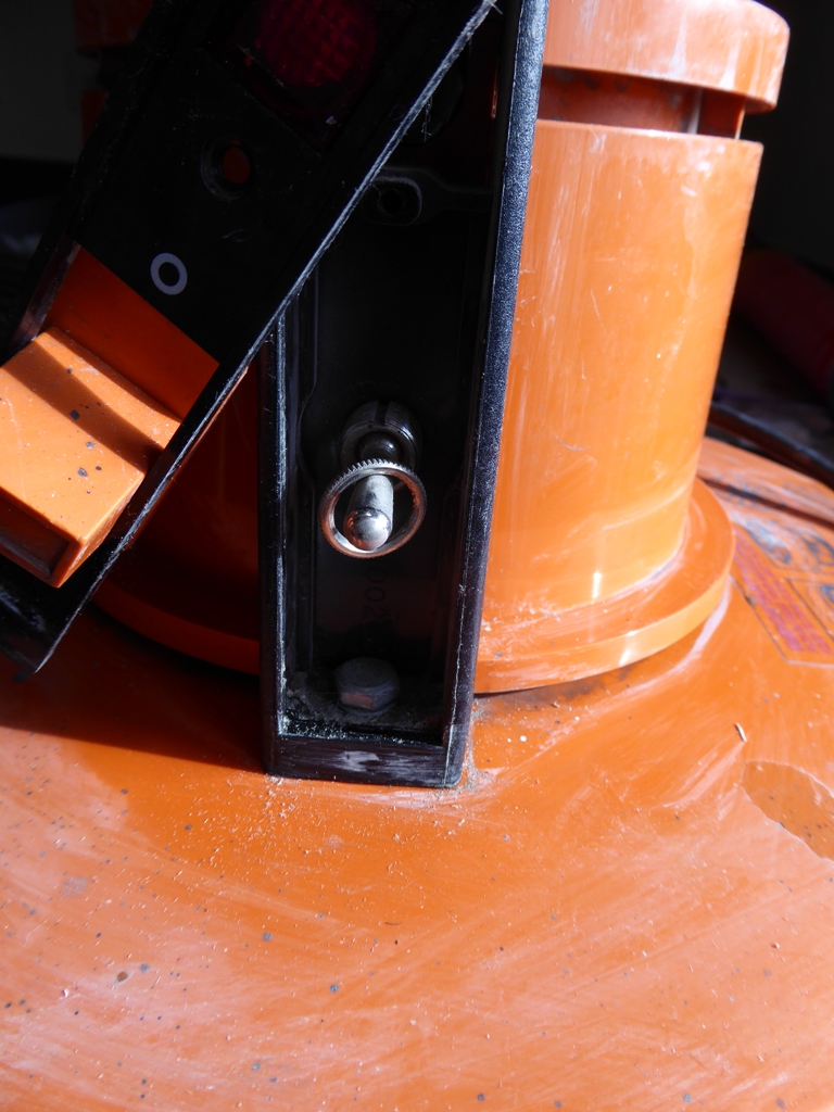

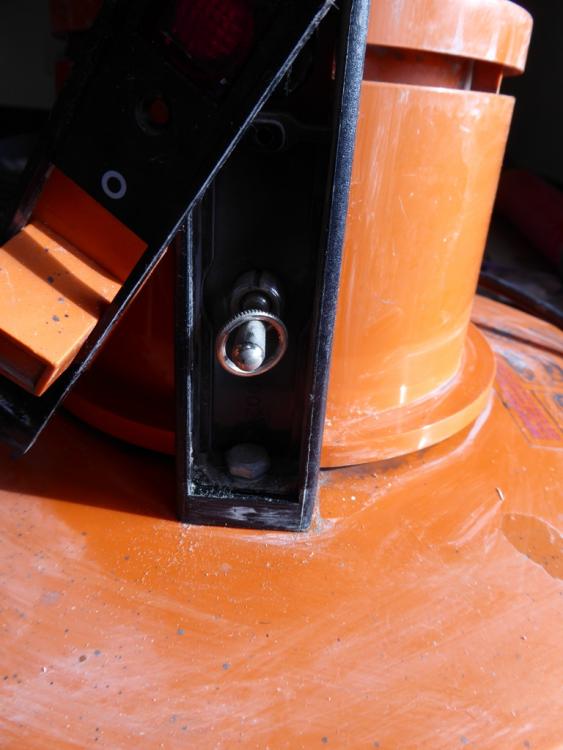

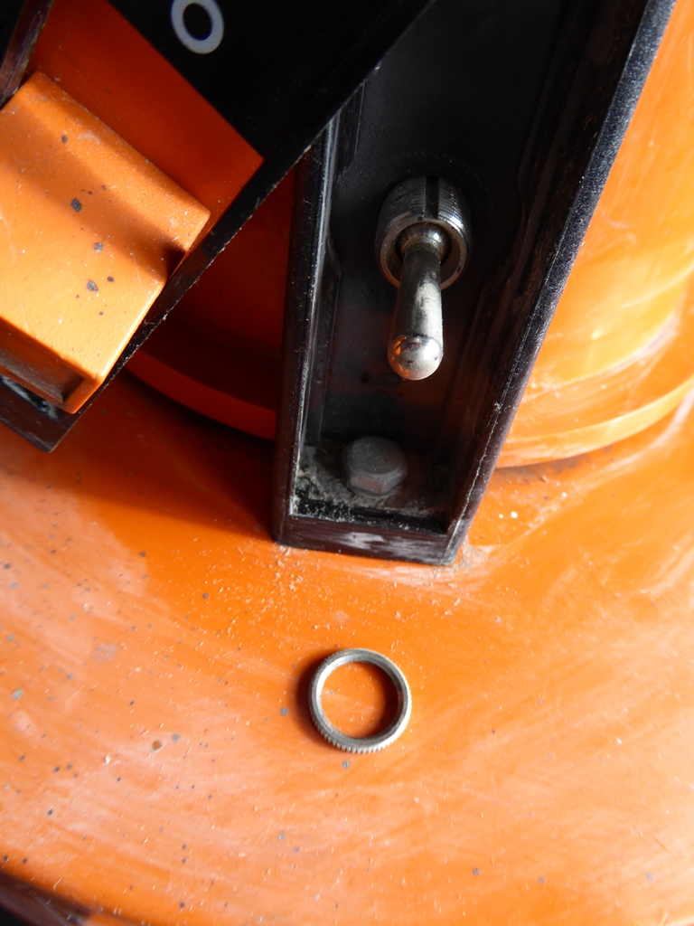

Jeremy Harris Posted October 10, 2017 Author Share Posted October 10, 2017 Guess what? You know I wrote in this post: 3 hours ago, JSHarris said: Out of curiosity, I'm going to completely strip down our 30 year old Vax 121, to see just what state it's in. It's a bit battered and bruised externally, as it got relegated to being my workshop vacuum around 20 years ago, then got moved to the new house as the site vacuum, where it's been seriously abused. The new one should arrive tomorrow, so there's nothing to be lost by stripping down the old one to see what's making the odd noise. that I was going to strip the ancient Vax to find out where the ominous noise was coming from? Well, I started by removing the switch cover, to gain access to one of the bolts that holds the motor cover and handle on, as the noise seemed to be coming from the motor. This is what I found as I removed the cover: Yes, that's right, the nut that holds the switch in place had completely unscrewed itself. The odd noise was the nut vibrating inside the housing. I've screwed the nut back on and the thing is working fine, no funny noises or whatever and loads of suction. I'll just give it a good clean, treat it to a new set of filters and with luck it'll see me out..................... Link to comment Share on other sites More sharing options...
