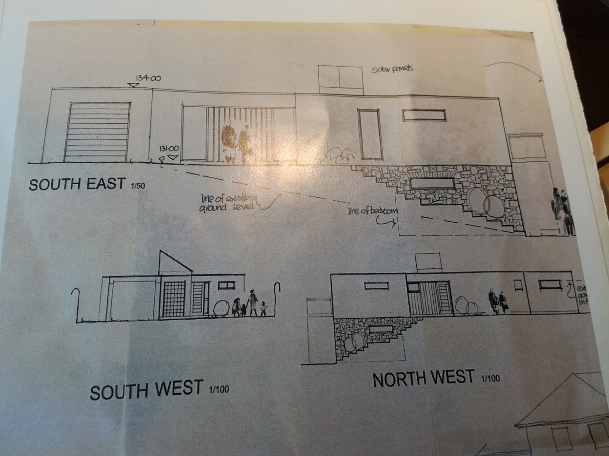

Dee J Posted October 4, 2017 Share Posted October 4, 2017 Still negotiating on a plot... but I'd like to get my head around current construction methods and detailing. So in it's most basic form the plan is for a single story flat roofed bungalow, but where the land slopes away having an undercoft (ie partially dug into the hillside) with two bedrooms and a bathroom. What I'm looking for is some useful, guide/website/book that shows the foundation/slab/retaining wall/insulation/damp proofing interconnections including those tricky transitions at the sides between the buried structure and the visible outer skin. At the moment, for the main portion of the house I'm looking at passive slab, structural block walls with external insulation and rainscreen cladding and a beam/block or cast in situ inverted warm roof. Height is key aspect of the planning - so minimising structure and maximising internal height is key. Suggestions, guidance, criticisms, examples please. Thanks Dee Link to comment Share on other sites More sharing options...

Dee J Posted October 4, 2017 Author Share Posted October 4, 2017 Thanks for the quick replies. The plot is accessed from the top, and most of the build area is fairly flat, but then drops steeply enough to allow the pair of rooms to be set under the end of the main build... about 2.5m drop in 6m. So the bedrooms will have level access into the garden. - so the undercroft/basement construction is under about 1/3 of the main house. Retaining wall will have to be about 8m run of 2.5m high. Link to comment Share on other sites More sharing options...

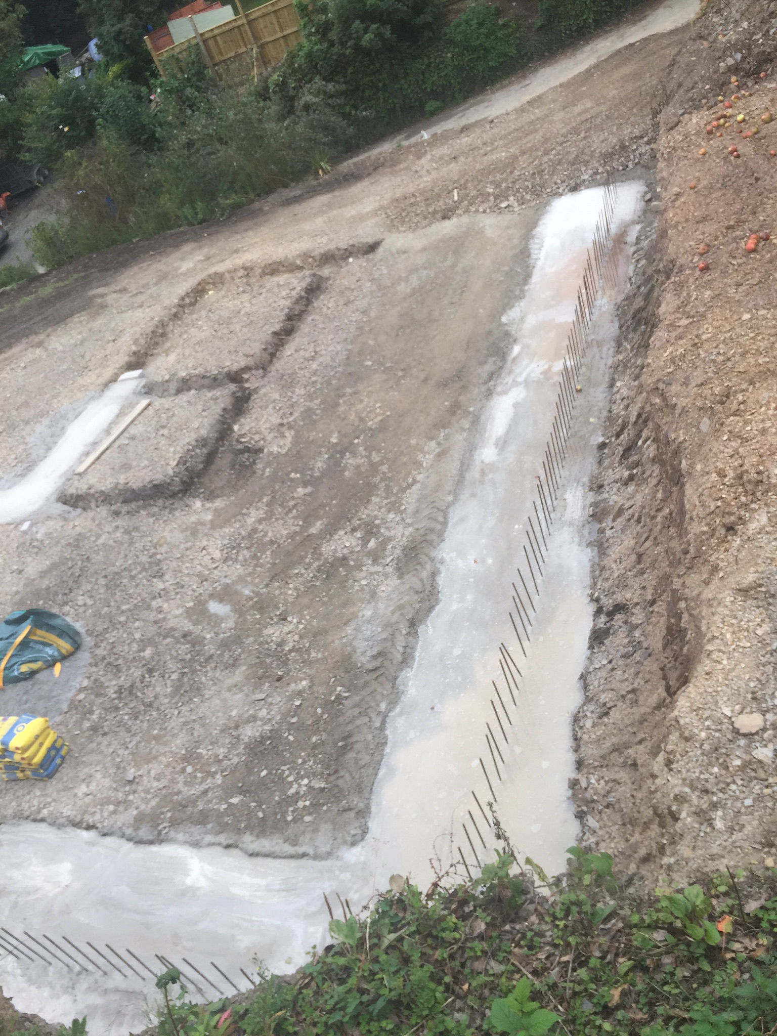

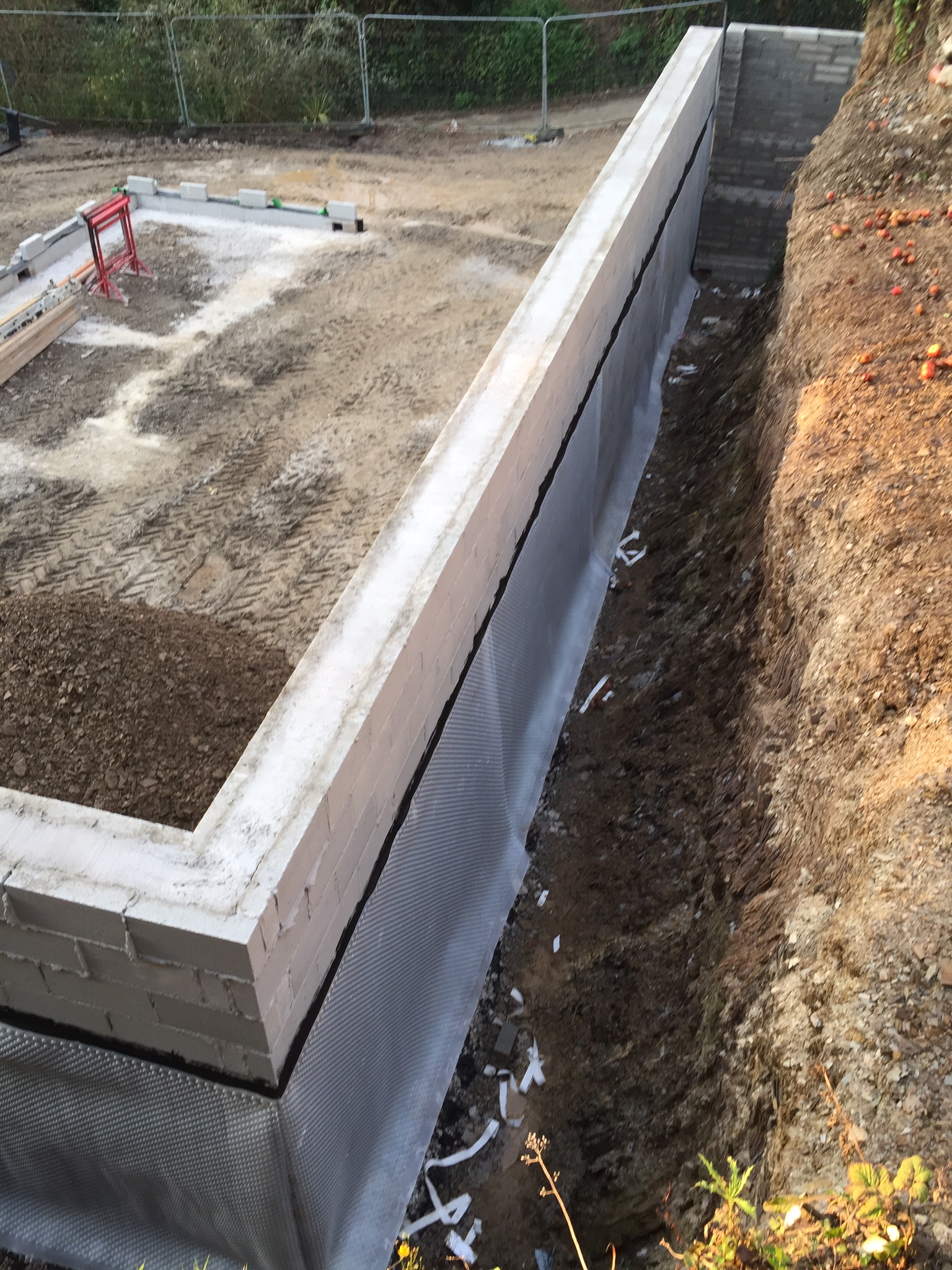

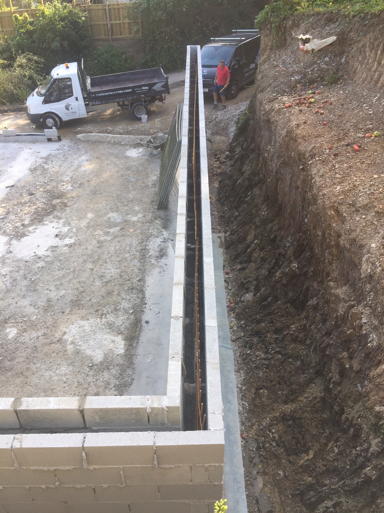

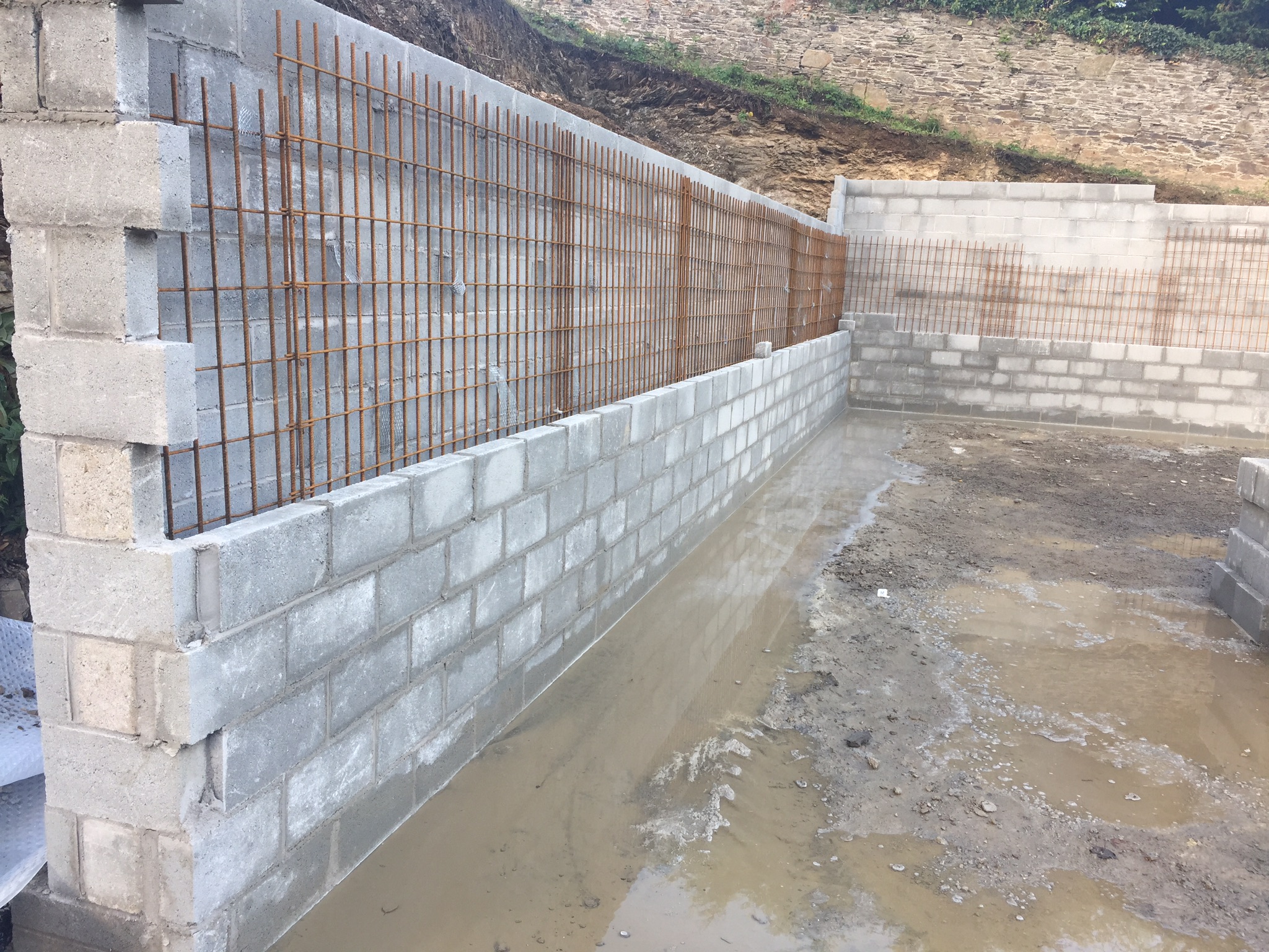

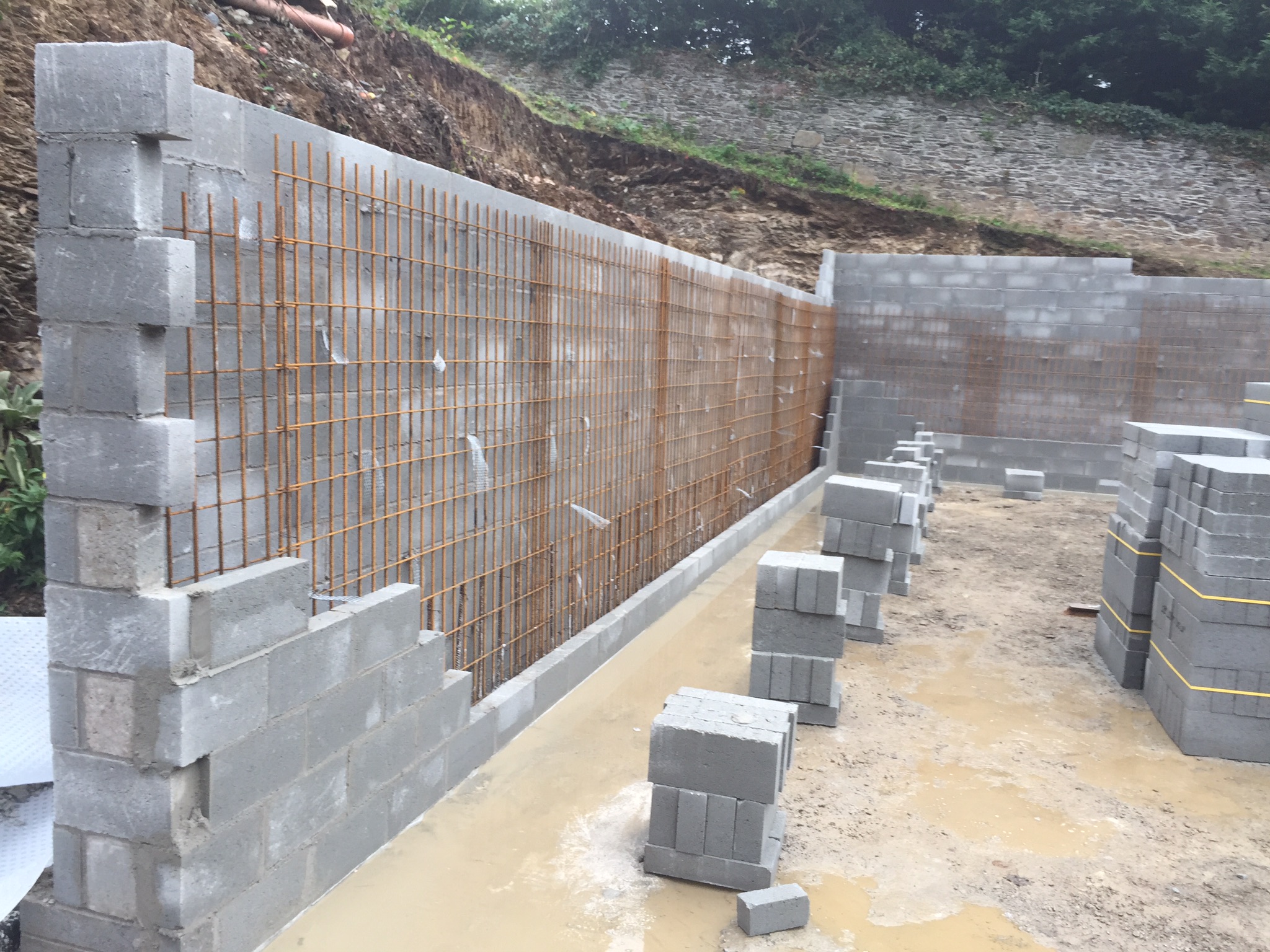

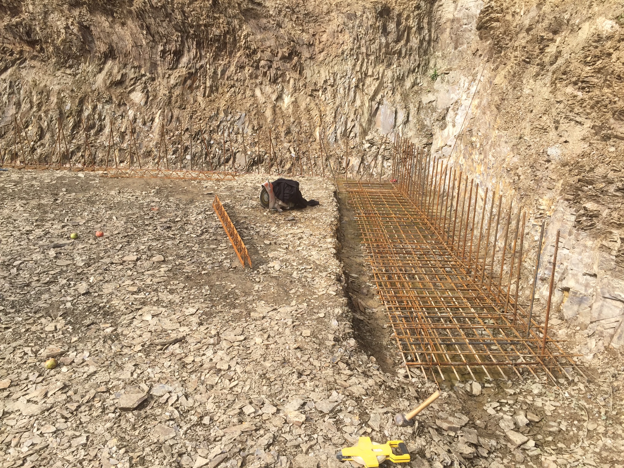

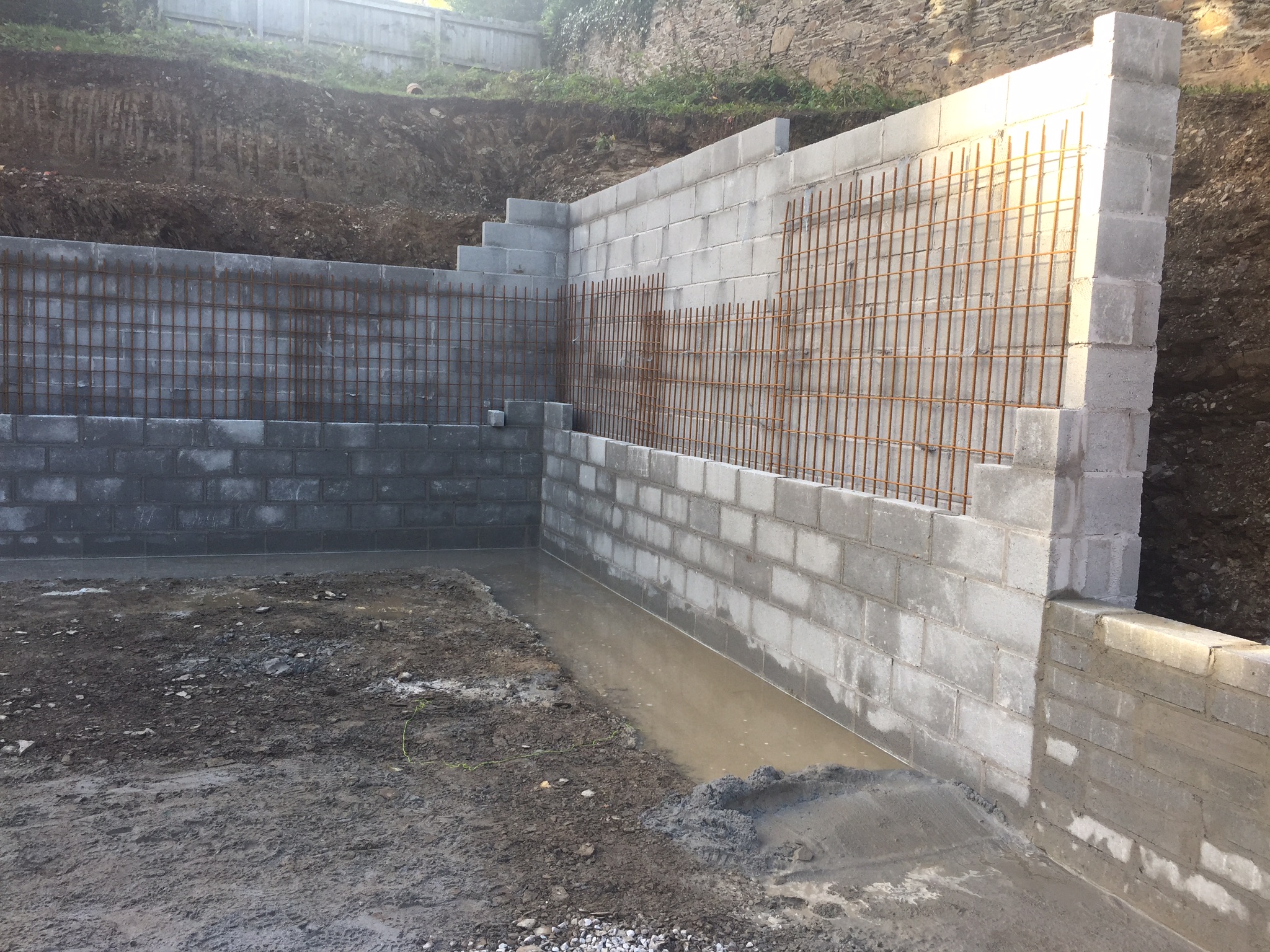

Grosey Posted October 5, 2017 Share Posted October 5, 2017 (edited) Not sure if this is any assistance but I’ve attached a few photos of my retaining wall. May help you visualise things as you enter discussions with SE’s and architects etc. Edited October 5, 2017 by Grosey Link to comment Share on other sites More sharing options...
