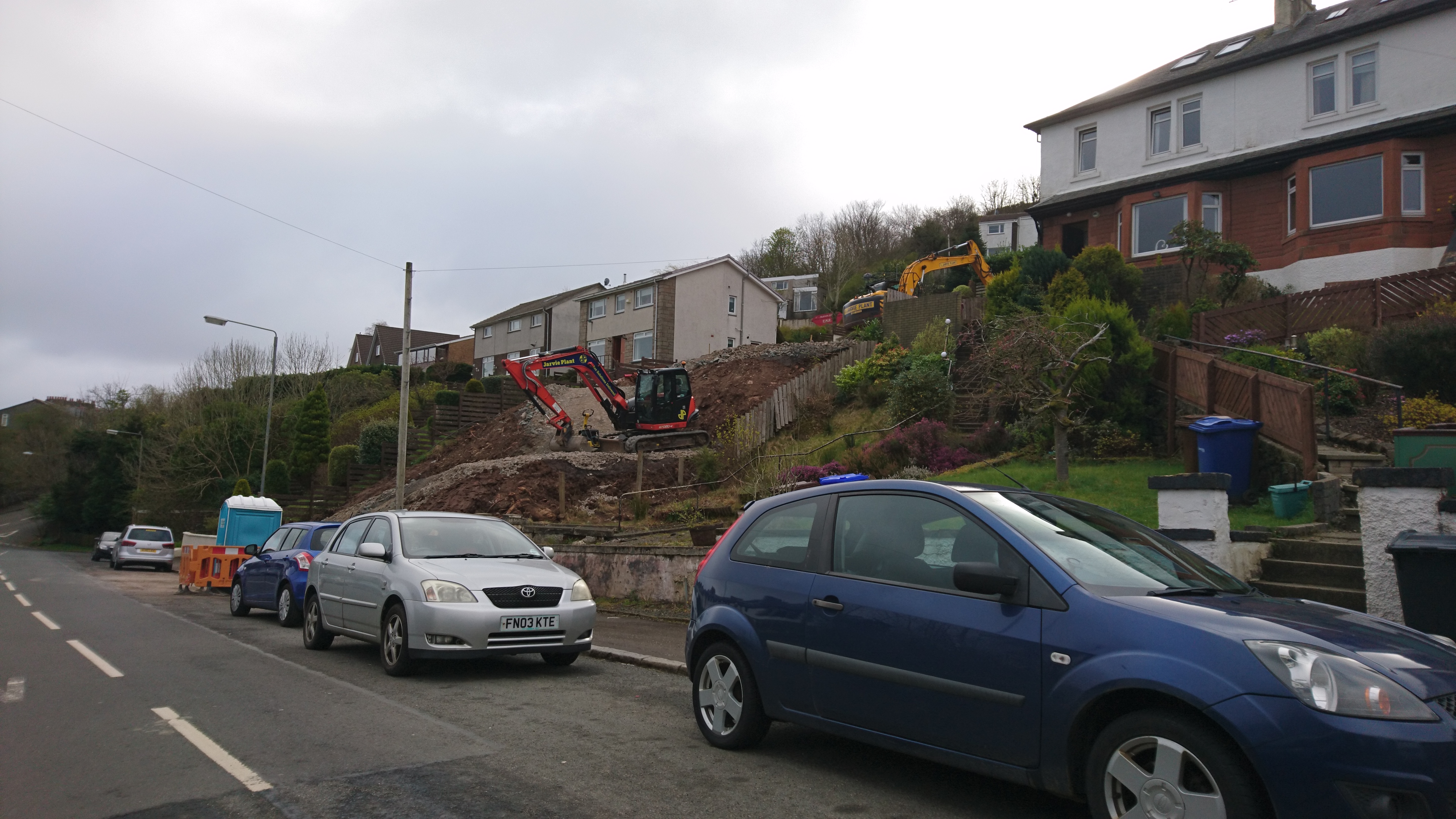

It may well have been more cost effective to fit a lift at the front, rather than create a path up a series of hairpin bends.
Here in England that access wouldn't appear to comply with Part M, as the gradient exceeds the max allowable for wheelchair/disabled access, unless there is access from the rear that is on less of a gradient.
Link to comment
Share on other sites

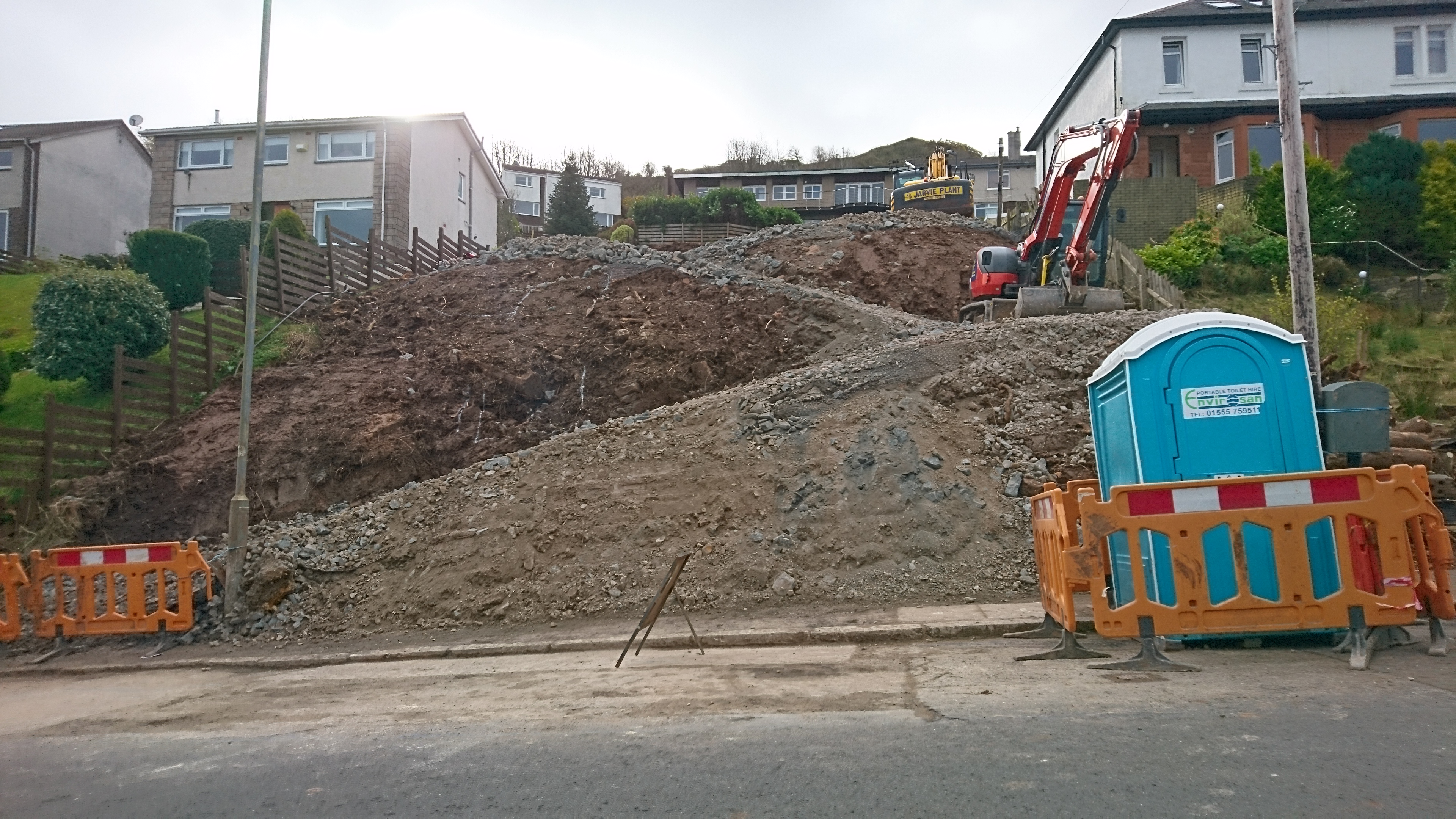

On my site the removal of earth to equalise a 1m rise across the depth of the house was a surprisingly high cost.
They are going to be paying a lot for simply dumping the earth they remove.
As @JSHarris asked is there access at the rear? There are certainly houses further up the hill.
There are quite a few houses in Edinburgh built on hillsides like this. There were no access rules when they were built, but I for one would hate having a house where there was a large number of steps up from the street or the garage which is often built at the bottom of the slope. It is just too awkward.
My in-laws have a site that slopes by around 3m from the road to the back of the house. This works OK as they simply added an extra storey underneath with the garage in it.
This looks like around 10m judging by the fence panels. That is some slope.

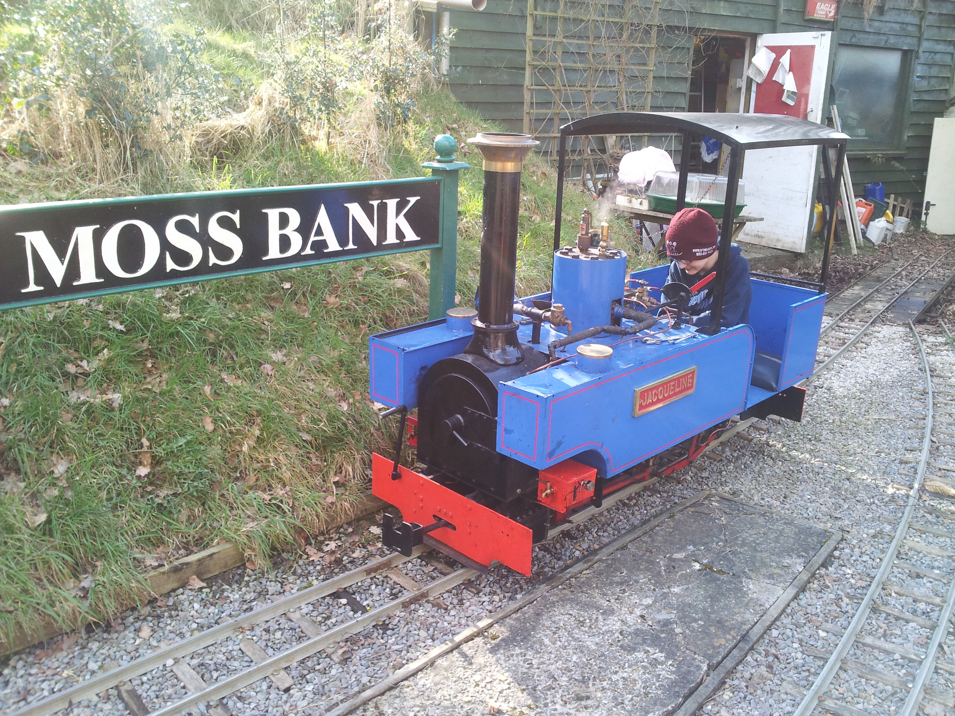

This is the loco on the railway here at millstone manor. This loco can handle the 1:30 slope with around 1T on a truck from the drive up to the log store, workshop and top station (Moss bank) it takes a bit of time to steam up but the battery electric loco is ready to go as required to transport things up the garden. Fortunately, or unfortunately depending on your view, the drive goes to the front door so the front of the house can be fed without the railway.

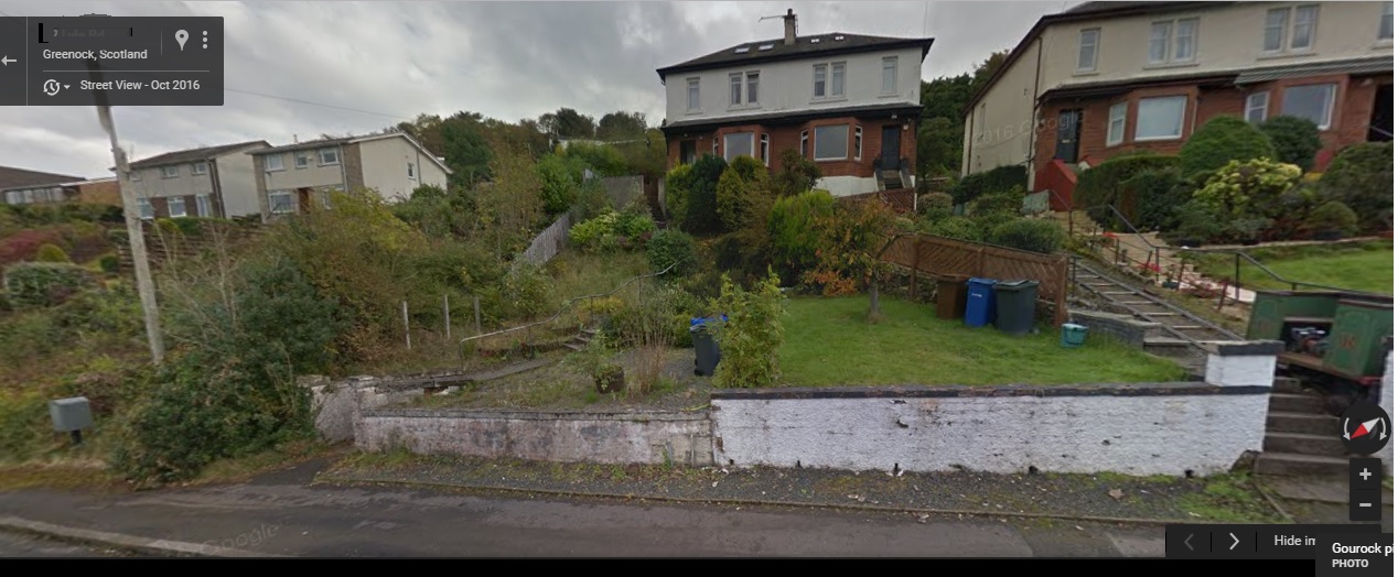

I found the planning application. I don't feel I should post someone's application without them knowing about it.
They are putting a parking area with retaining walls right next to the road and then building the house on a flatter area further up the site. The main issues seems to be grading the site for access to the area where they are building, they won't be removing much earth. The path from the parking to the house will be pretty steep.
Due to the layout of the street it looks like the house faces a gap between houses further down the hill so should have a nice view of the river Clyde. Indeed it looks like the plot that hasn't been built on may have one of the best views in the street.

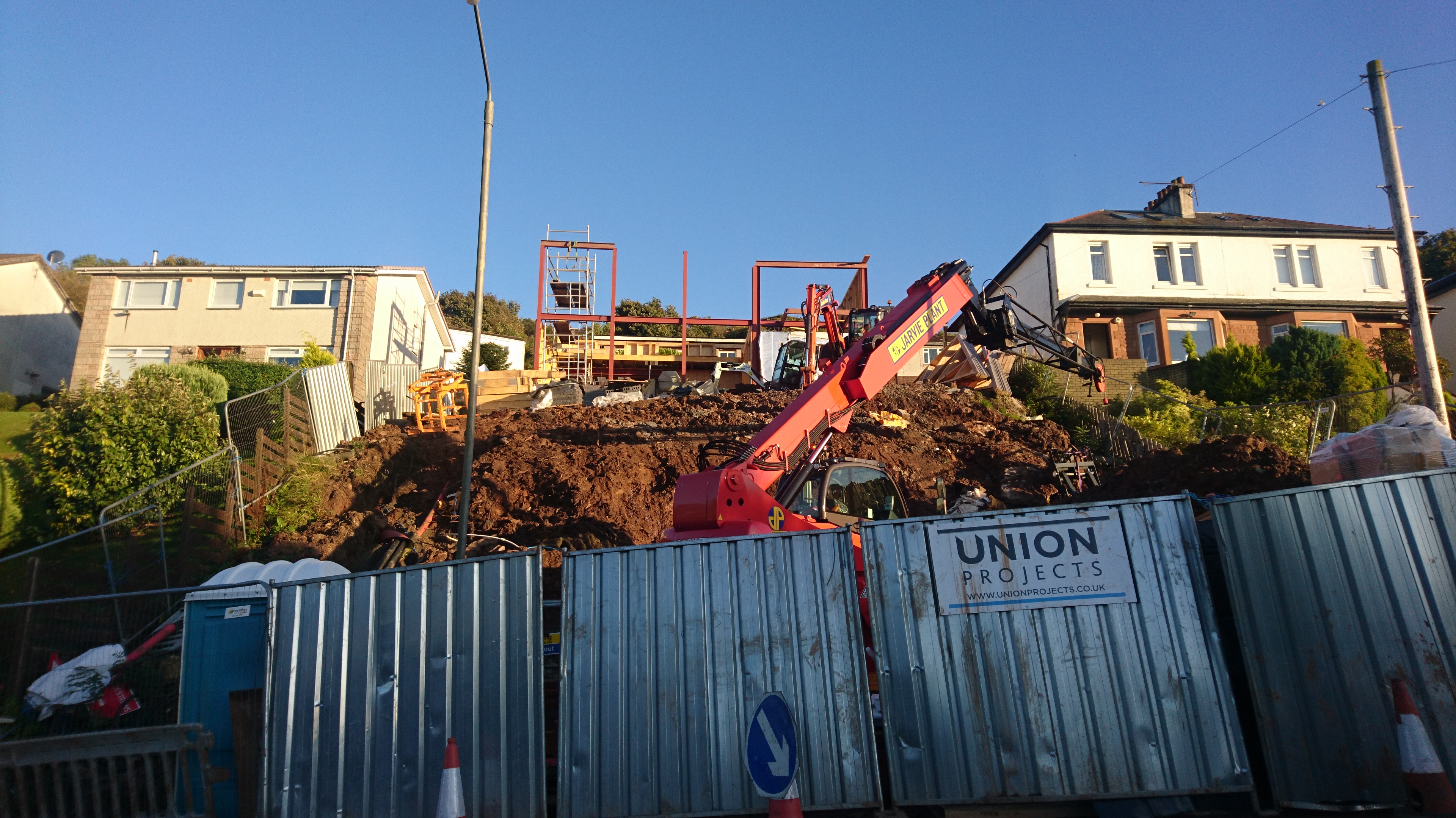

I would have thought progress would have been more given that they started in April - but it's a pretty tough site. Looks like they came up with the same solution as us - the 360degree telehandler with crane jib - a very versatile piece of kit.
