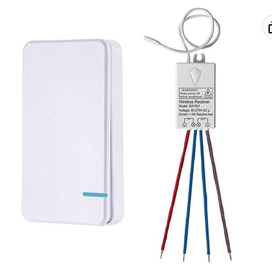

The Reverend Posted May 13, 2023 Posted May 13, 2023 Cats & pigeons get ready! We are a long way off planning the wiring runs for our new build but a recent conversation with our electrician neighbour got me thinking about 2 way and 3 way switches for bottom/top and exit out of rooms. The details aren't important unless we have to squeeze 9 cables into a switch box but remote controlled (not smart) light switches have been around for many years so is it time to do away with the wired light switch. I'm sure purists would say no and youngsters (under 50) would get with the times but I don't know if it would be allowed under building regs. What do you think (he says lighting blue touch paper and retiring to safe distance😁) Thinkbee MINI Wireless Light Switch Kit, Quick Create or Relocate On/Off Switch for In-/Outdoor Lamp up to 1000W, No Wiring/Easy-installing/Portable/Waterproof Switch Remote Control Up to 1300ft, 1

JohnMo Posted May 13, 2023 Posted May 13, 2023 Not sure building control care as long as you have a sign off cert from the electrician. Just seems more stuff to go wrong and scratch your head over in 10 years time when it's all old hat, the company no longer supplies the replacement parts. 1
Mike Posted May 13, 2023 Posted May 13, 2023 I'm renting a place during my renovation where one room has Legrand wireless switches (think they use Zigbee) and I'm told that they've been temperamental for a few years. Two days ago they tripped the circuit breaker when I tried to switch them on, and they're now not working at all. I'll be sticking to wired switches.
Thorfun Posted May 13, 2023 Posted May 13, 2023 the beauty of self-building is you can do whatever you want (within regulations of course). we're using Loxone to control our lights but will have physical switches in all rooms wired back to a central location. the idea is to not actually ever use them though as the HA should cater for most situations. 🤞 but I wouldn't use wireless switches in a new build when it's easy and quick to run cable. in a refurb though I can definitely see the benefit.

joth Posted May 13, 2023 Posted May 13, 2023 5 hours ago, The Reverend said: . The details aren't important unless we have to squeeze 9 cables into a switch box but remote controlled (not smart) light switches have been around for many years so is it time to do away with the wired light switch. In my book (white male, <50 years old), you have this the wrong way around. Wired switches are always going to be more reliable and long lasting than wireless, however something digital ("smart") will allow a pair of wires to each switch to have infinite uses, and be software reprogrammable if needs change, without need for a wire per light Like others here I use Loxone, but other options like Rako exist. All that said Lutron have gone wireless only and it is the trend with other tech (ZigBee Zwave Bluetooth and Matter) so maybe I'm the luddite. I just hate wireless tech when a wired option is possible 5
elite Posted May 13, 2023 Posted May 13, 2023 Wired for me, if at all possible - the quinetic stuff looks to be decent and is clever, might be useful for stair / landing and outside lights if you forgot a cable, but a step too far for me to go wireless for everything 2

Onoff Posted September 6, 2023 Posted September 6, 2023 Another Quinetic switch failure here. One half of a two gang switch thus meaning the whole switch has to be replaced. I'm thinking that tbh they're like LED lights, a con.
FuerteStu Posted September 6, 2023 Posted September 6, 2023 My current favoured method is twin and earth in and out of each switch plate, with 3 core and earth up to the lights. Logic being... - There's a neutral at the switch for smart switches - You can take a permanent live up to lights for smart lights. - The potential for two switched lives and a neutral to the lights for two banks of lights without additional cables. - Future fault finding isnt working at height or taking down light fittings. 2
Onoff Posted January 2, 2024 Posted January 2, 2024 On 06/09/2023 at 21:28, Onoff said: Another Quinetic switch failure here. One half of a two gang switch thus meaning the whole switch has to be replaced. I'm thinking that tbh they're like LED lights, a con. Now the other gang of the switch has failed. I pity anyone who's done away with hard wiring and just used Quinetic stuff. 1
Mattg4321 Posted January 2, 2024 Posted January 2, 2024 Hard wired is always better for everything if possible. More reliable No battery changes Easier/cheaper to fix or replace for someone unfamiliar with the property More reliable! The amount of times I have to troubleshoot wireless heating controls that plumbers have supplied. Drives me mad.
JohnMo Posted January 2, 2024 Posted January 2, 2024 My view, Would or did I bother - no Is my life richer or poorer with or without smart switches - no, make little or difference either way. Not difficult to flick a switch as I enter or leave a room. Future proof - no Could company remove functionality of the switch - yes if a cloud based system Short life when installed - possibly, see examples above Will I be able to get spares easily - who knows, will company or the same part exist in 5 years time? Will it cost more to install your lights - yes Will you use all its functions after 5 days - most possibly no Would your other half or a new owner of the property or an electrician fix easily if you are not around - maybe, most likely not. Can you or the electrician get spares today - most likely not. Can you switch your lights on if there is a hardware or software issue - maybe not. Have I got home assistant - yes Do I have smart relays - yes Are they the best thing ever - no, great sometimes. Are smart things a good thing, not really keep it simple - KISS 1
