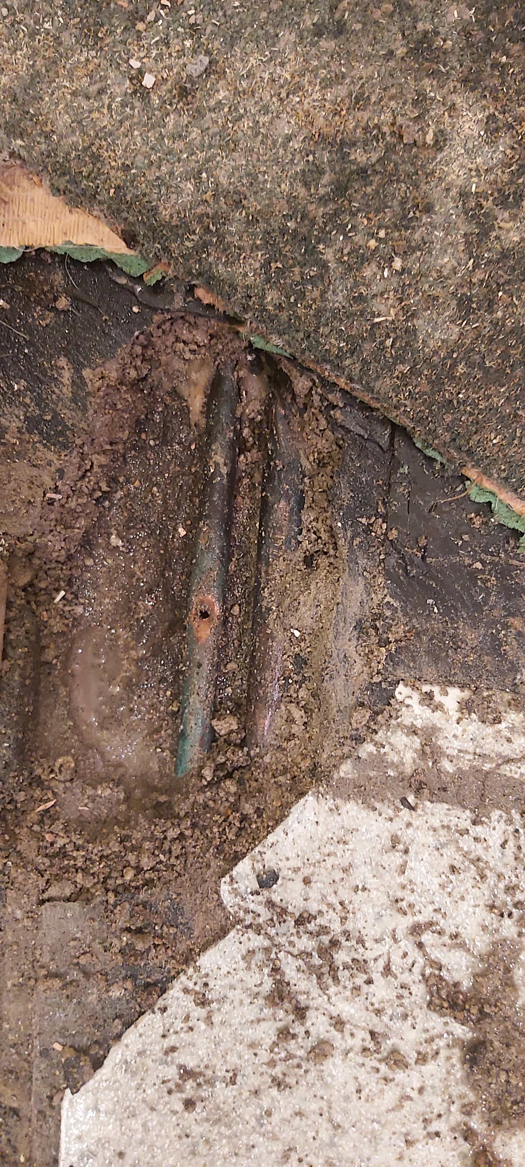

I bullseyed a copper pipe that was less that 5mm deep in the floor screed while fixing a footplate to close up a doorway after joining up shower/toilet separates. Managed to do it at 9pm one night, all hell broke loose, including the stopcock handle breaking off when I tried to isolate. One thing with renovations, if it can go wrong, it usually will at the worst time possible! -
