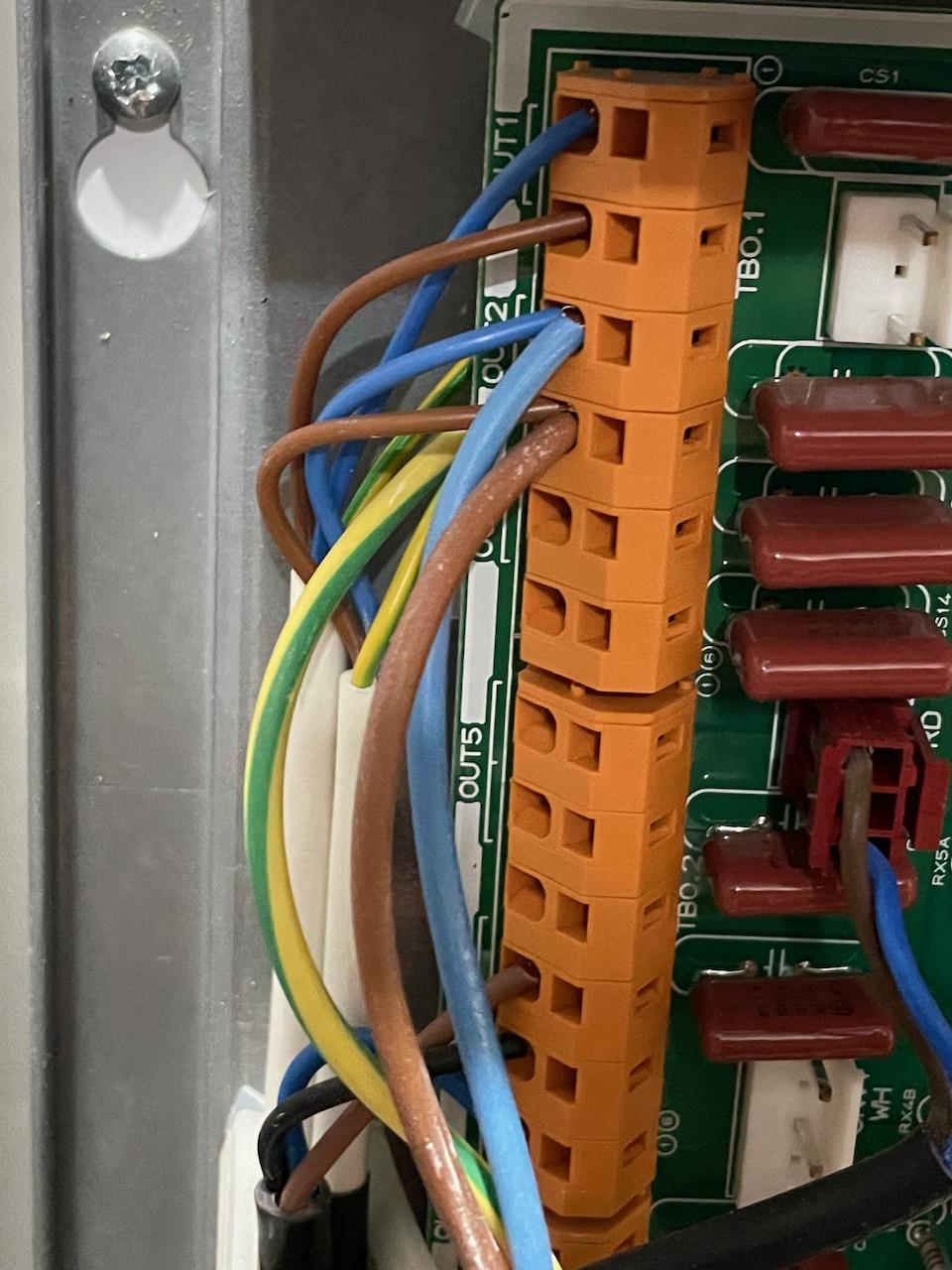

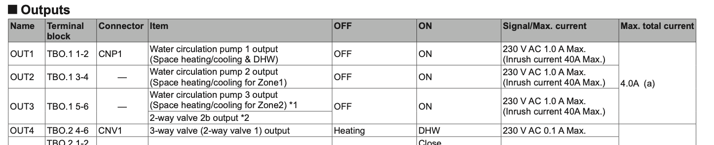

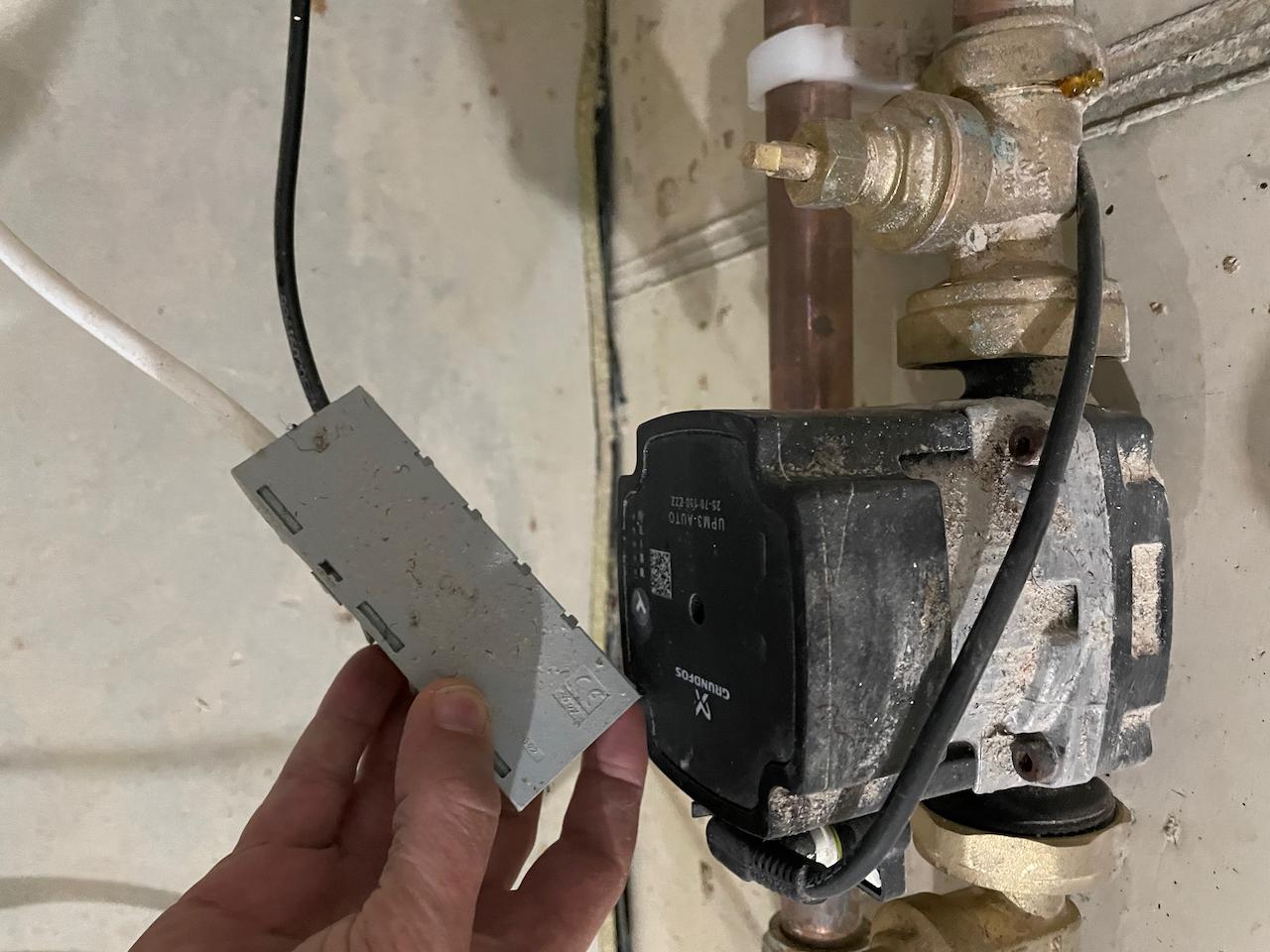

Thorfun Posted November 12, 2023 Author Share Posted November 12, 2023 4 minutes ago, ProDave said: So you have one motorised valve per manifold but only ONE pump that serves both manifolds. That complicates the issue. yes. this is exactly what I have. 4 minutes ago, ProDave said: What is the call for heat input on the FTC6? Does it have to be a volt free contact or will it accept a switched 240v ac input? I'm not actually sure! our heating engineers have wired it up but I'm not sure what is making the call for heat. it might be the inbuilt thermostat within the FTC6 controller unit. Link to comment Share on other sites More sharing options...
Thorfun Posted November 12, 2023 Author Share Posted November 12, 2023 6 minutes ago, ProDave said: The logic is: Basement thermostat energises basement motorised valve when it wants heat. Ground floor thermostat energised ground floor motorised valve when it wants heat. The feedback contacts (orange and grey wires) from both motorised valves connect in parallel and will turn on the pump when either floor is calling for heat. yes. this is what I need I think! but what do I need to make it work and wire it all up? 7 minutes ago, ProDave said: Where it will get complicated if the FTC6 insists on a volt free contact you will have to use a relay. I will have to Google this and/or look at the manual. Link to comment Share on other sites More sharing options...
ProDave Posted November 12, 2023 Share Posted November 12, 2023 26 minutes ago, Thorfun said: yes. this is what I need I think! but what do I need to make it work and wire it all up? I will have to Google this and/or look at the manual. To make it work you need a junction box to connect it all together, I would start with a standard central heating "wiring centre" which is usually just a plastic box with a 12 way terminal block inside and lots of cable entries. I am hoping that one of the many forum members familliar with the FTC6 will answer what it's call for heat input is. 1 Link to comment Share on other sites More sharing options...

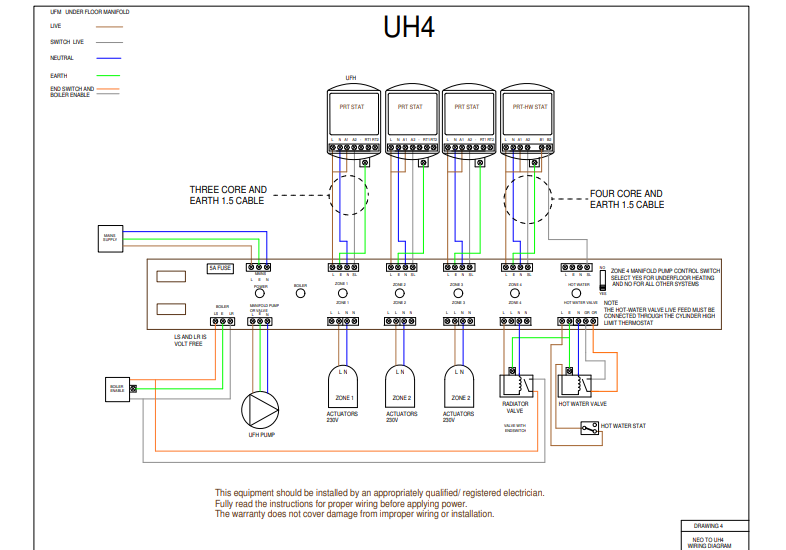

ProDave Posted November 12, 2023 Share Posted November 12, 2023 7 minutes ago, Thorfun said: like one of these? https://www.theunderfloorheatingstore.com/products/salus-5-zone-wiring-centre?view=compare&compare=heatmiser-uh4-4-zone-wiring-center,polypipe-ufh4zw-4-zone-wiring-centre No, that is what you would use if you were having lots of individual zones and individual actuators for each pipe loop. You just want to join together the two motorised valve cables, 2 thermostat cables, a cable to the pump, a flex in providing power and (still to be determined) how to connect to the RTC6. Something like this https://www.toolstation.com/drayton-wiring-centre/p56309 1 Link to comment Share on other sites More sharing options...

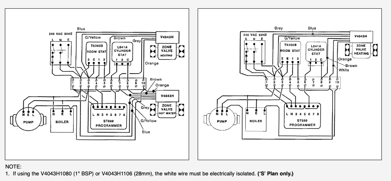

crispy_wafer Posted November 12, 2023 Share Posted November 12, 2023 There's your diagram for the UH4, substitute the word actuator for valve on zones 1 and 2 & Jobs a Goodun. Probably need someone who's done this before to confirm though! 1 Link to comment Share on other sites More sharing options...
Pocster Posted November 12, 2023 Share Posted November 12, 2023 3 minutes ago, crispy_wafer said: There's your diagram for the UH4, substitute the word actuator for valve on zones 1 and 2 & Jobs a Goodun. Probably need someone who's done this before to confirm though! Very similar to my heat miser wiring - not tricky Link to comment Share on other sites More sharing options...
Thorfun Posted November 12, 2023 Author Share Posted November 12, 2023 1 hour ago, ProDave said: No, that is what you would use if you were having lots of individual zones and individual actuators for each pipe loop. You just want to join together the two motorised valve cables, 2 thermostat cables, a cable to the pump, a flex in providing power and (still to be determined) how to connect to the RTC6. Something like this https://www.toolstation.com/drayton-wiring-centre/p56309 so I found this about wiring the Honeywell motorised valve my valves have 6 wires so will be the diagram on the right. that block in the middle looks like the Drayton wiring centre you linked to, right? so if I wire it all up like that then things should work? out of interest, what is the 'Programmer'? is that the timer? also, my pump is wired in to the FTC6 via a wago connector block and connects to the FTC6 as shown below so is wired to Out2 which according to this manual is so would I get rid of the wago block and put the pump and the cable to OUT2 of the FTC6 and join them to the Drayton wiring centre 1, 2 and 3 as per the above diagram? Link to comment Share on other sites More sharing options...

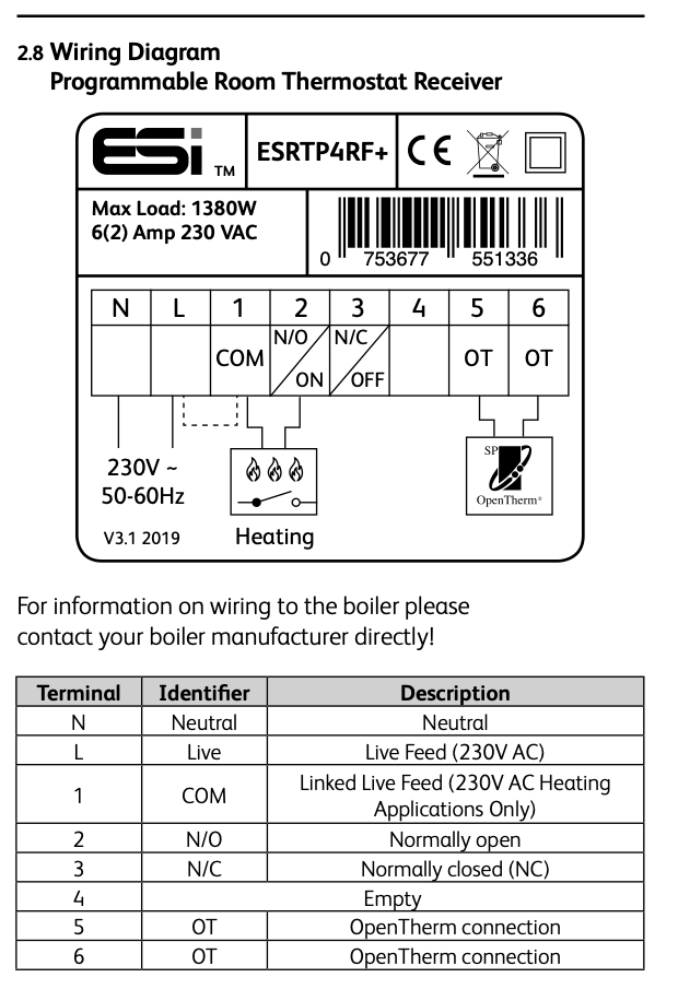

Thorfun Posted November 12, 2023 Author Share Posted November 12, 2023 looking at a few wireless thermostats. are they all compatible with ASHPs? this one https://www.cityplumbing.co.uk/p/esi-wireless-programmable-room-thermostat-white-esrtp4rf/p/455329 has instructions https://support.esicontrols.co.uk/wp-content/uploads/2022/05/esrtp4rf-_installation-instructions_web.pdf that says Quote For information on wiring to the boiler please contact your boiler manufacturer directly! I don't have a boiler! are there specific wireless thermostats for ASHPs? I don't want anything too flashy or expensive as it's a temporary measure. Link to comment Share on other sites More sharing options...

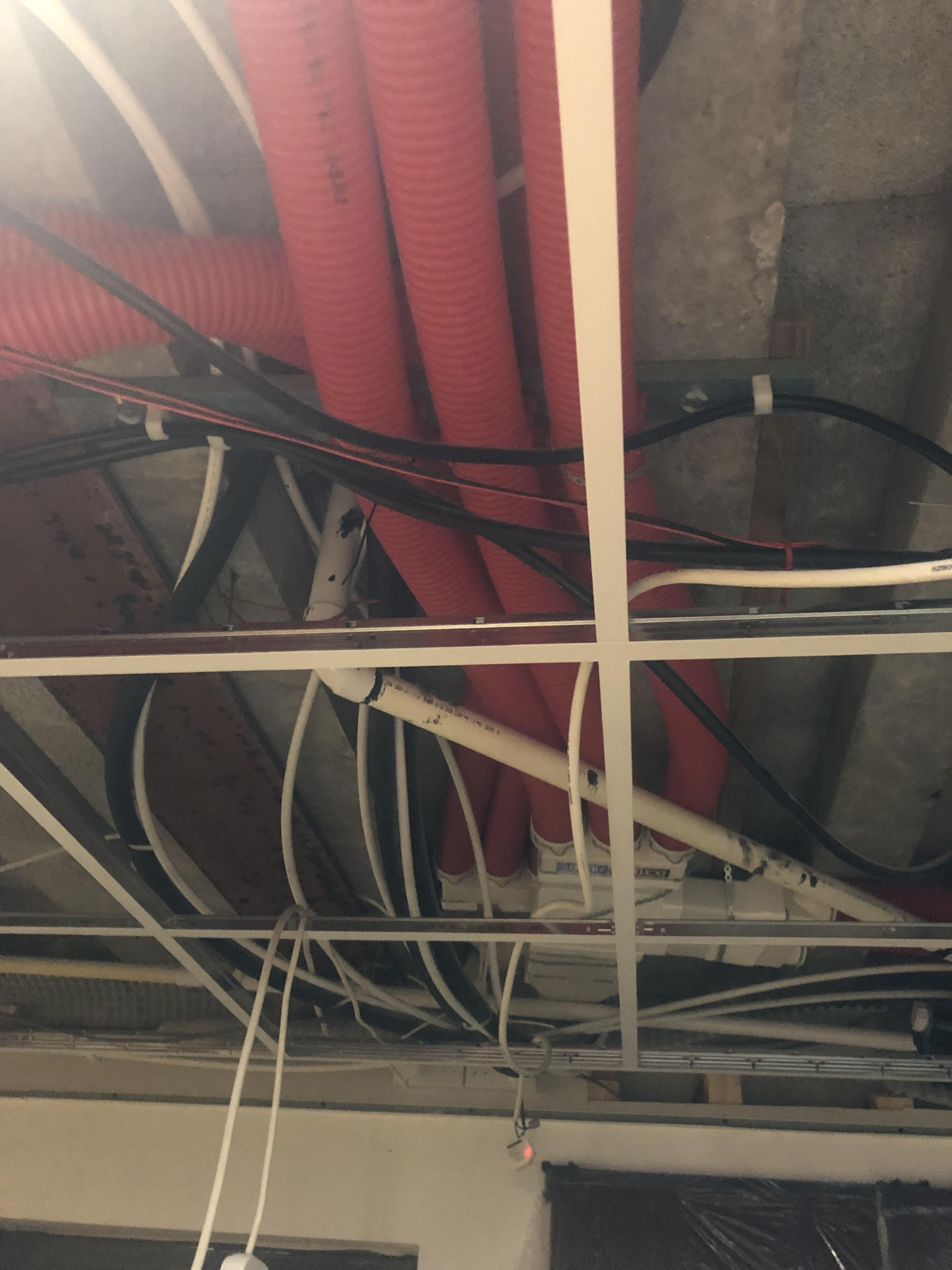

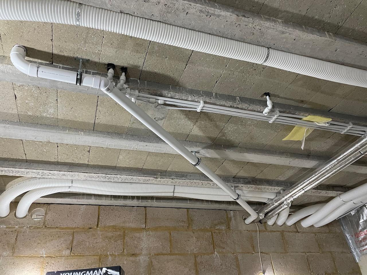

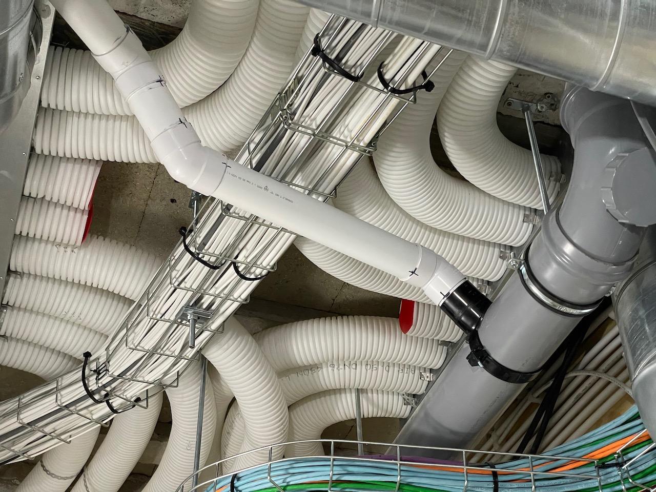

Thorfun Posted November 19, 2023 Author Share Posted November 19, 2023 On 08/11/2023 at 13:31, Pocster said: Well young Neo … you listen to Morpheus …. I listened master. 40mm coming through the block and beam straight in to a 50mm bend and then 50mm all the way to the soil pipe. 6 Link to comment Share on other sites More sharing options...
Roger440 Posted November 19, 2023 Share Posted November 19, 2023 9 hours ago, Thorfun said: I listened master. 40mm coming through the block and beam straight in to a 50mm bend and then 50mm all the way to the soil pipe. Jeeeez, what is all that for!!!!?!! Link to comment Share on other sites More sharing options...
JohnMo Posted November 19, 2023 Share Posted November 19, 2023 19 minutes ago, Roger440 said: Jeeeez, what is all that for!!!!?!! My thoughts also, no wonder this thread is 40 pages long 2 Link to comment Share on other sites More sharing options...
dpmiller Posted November 19, 2023 Share Posted November 19, 2023 are the red caps on the MVHR ducts airtight? Link to comment Share on other sites More sharing options...
Thorfun Posted November 19, 2023 Author Share Posted November 19, 2023 1 hour ago, dpmiller said: are the red caps on the MVHR ducts airtight? I hope so! 1 Link to comment Share on other sites More sharing options...
