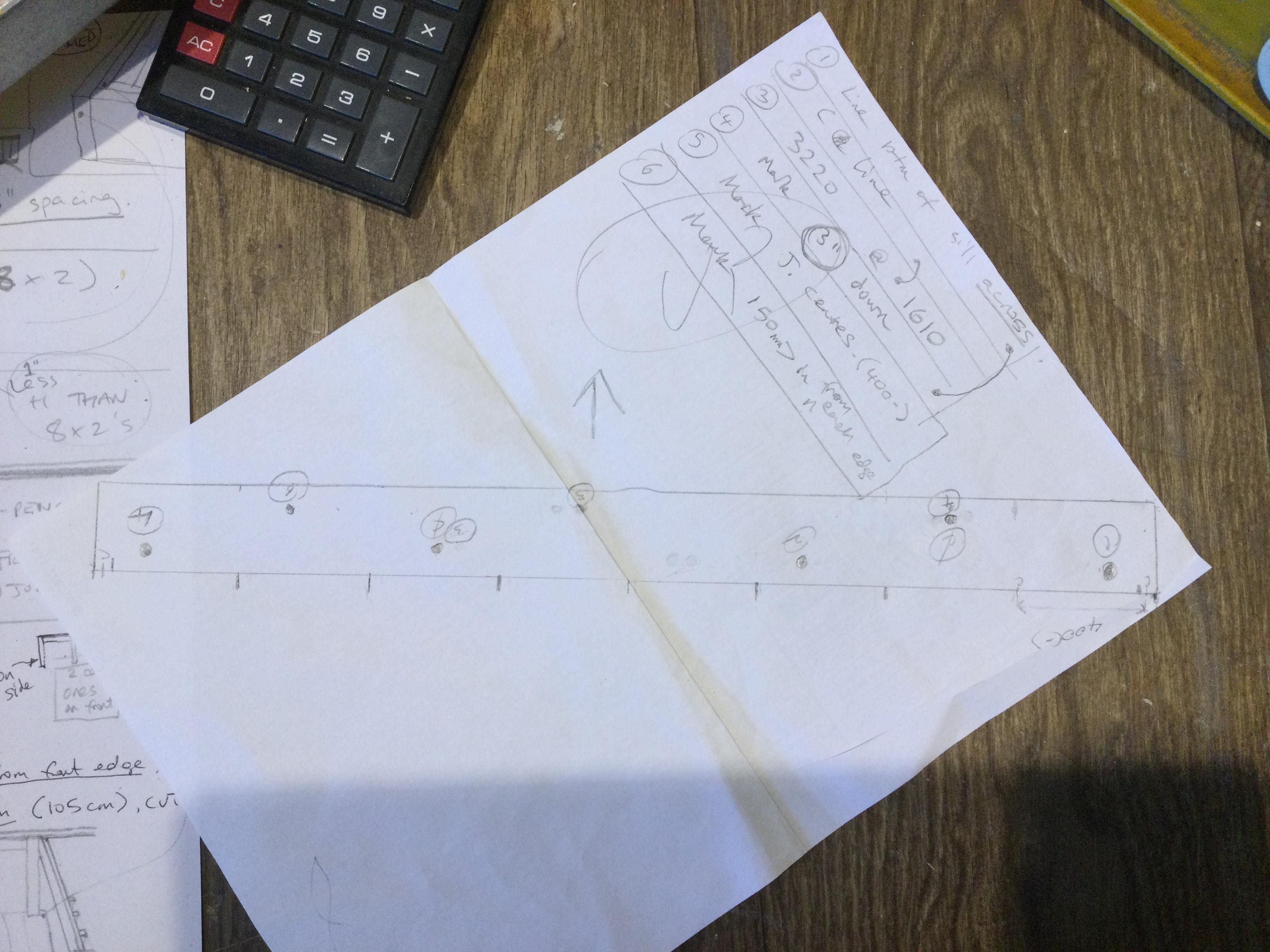

zoothorn Posted August 5, 2022 Author Posted August 5, 2022 Hi chaps. Right it's zoot-liftoff time. I've plotted my ledger 7 mount positions, avoiding my perpendicular joist positions, & marked these 7 on the wall. But just thought is it best to mark my 7 upon my ledger > drill holes > offer timber up > drill thru to mark the walls? Maybe two sturdy rawl-plugged (temporary) screws into wall, to sit the timber upon.. get level > drill thru holes etc? I've done this plotted mount hole positions. Missing (9 total) joists @400mm centres. Mounts are 30mm down/ up, from btm/ top of timber edge. Comments welcome. 3220mm W. [I need to clear some furry guests away 1st mind you!]. 1

joe90 Posted August 5, 2022 Posted August 5, 2022 I found it’s difficult to accurately mark a number of holes so I would fix either end on your bolts (making sure it’s level) then drill the other 5 in between through the timber into the wall, all 7 should then line up, remove timber, fit bolts/studs with your spacers the re fix timber to all 7 studs 👍

Onoff Posted August 5, 2022 Posted August 5, 2022 1 hour ago, joe90 said: I found it’s difficult to accurately mark a number of holes so I would fix either end on your bolts (making sure it’s level) then drill the other 5 in between through the timber into the wall, all 7 should then line up, remove timber, fit bolts/studs with your spacers the re fix timber to all 7 studs 👍 +1 An alternative is to prop the ledger up on some timbers against the wall and drill through it like that. You could pre-drill the ledger on the deck then just spot through when it's propped. 1
zoothorn Posted August 5, 2022 Author Posted August 5, 2022 1 hour ago, joe90 said: I found it’s difficult to accurately mark a number of holes so I would fix either end on your bolts (making sure it’s level) then drill the other 5 in between through the timber into the wall, all 7 should then line up, remove timber, fit bolts/studs with your spacers the re fix timber to all 7 studs 👍 Hi J. Good idea.. but would it still be a pig to get it level like this, fixing it one each end to start with I wonder. Hence if I had a perch, I could easily shim it level. Then drill my two ( thinking as i type) end ones & continue the rest like your idea. Or drill just one end stud in, slip my board on, pivot it up to a predone perch, shim it level etc. hmm.
