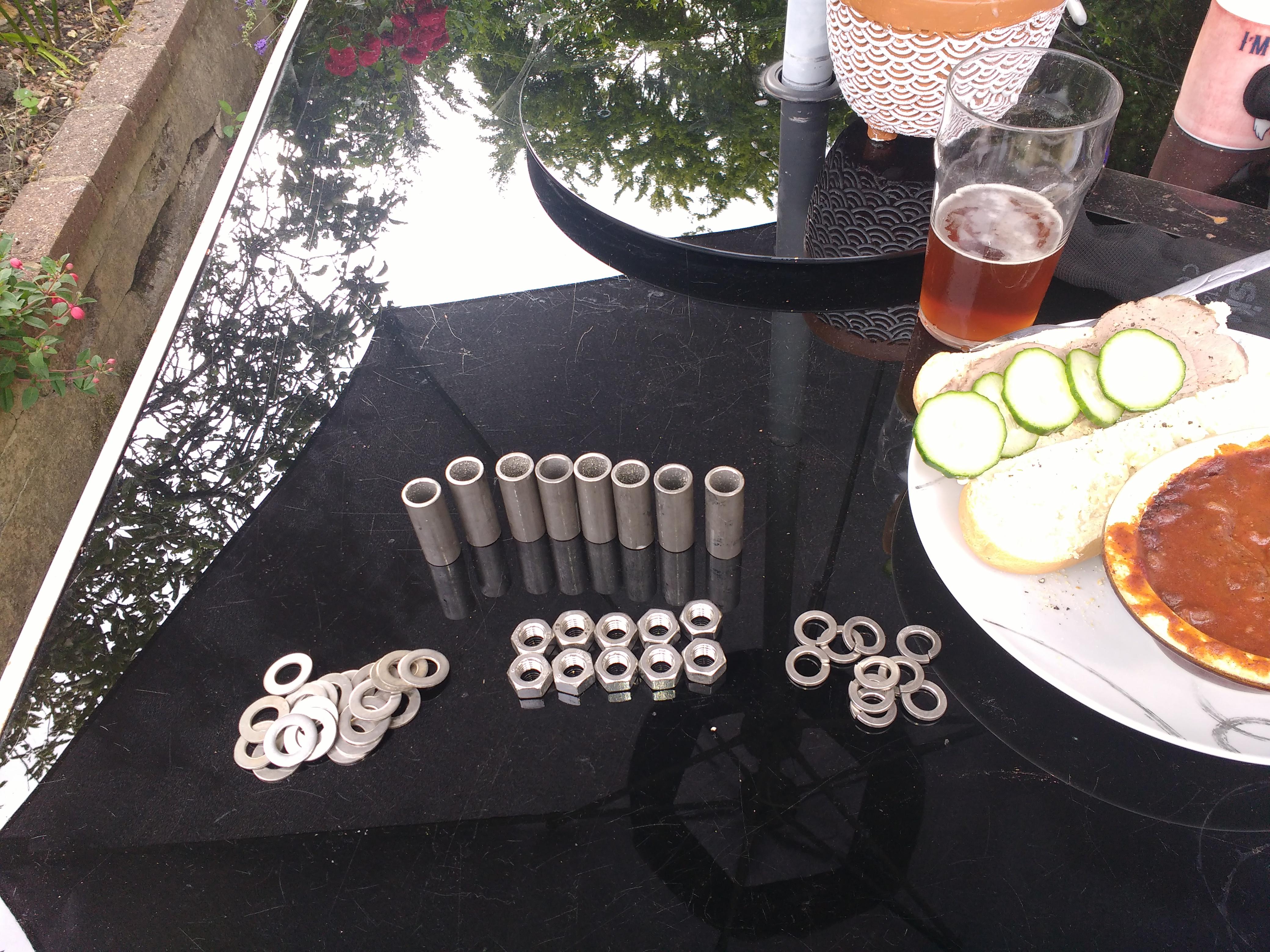

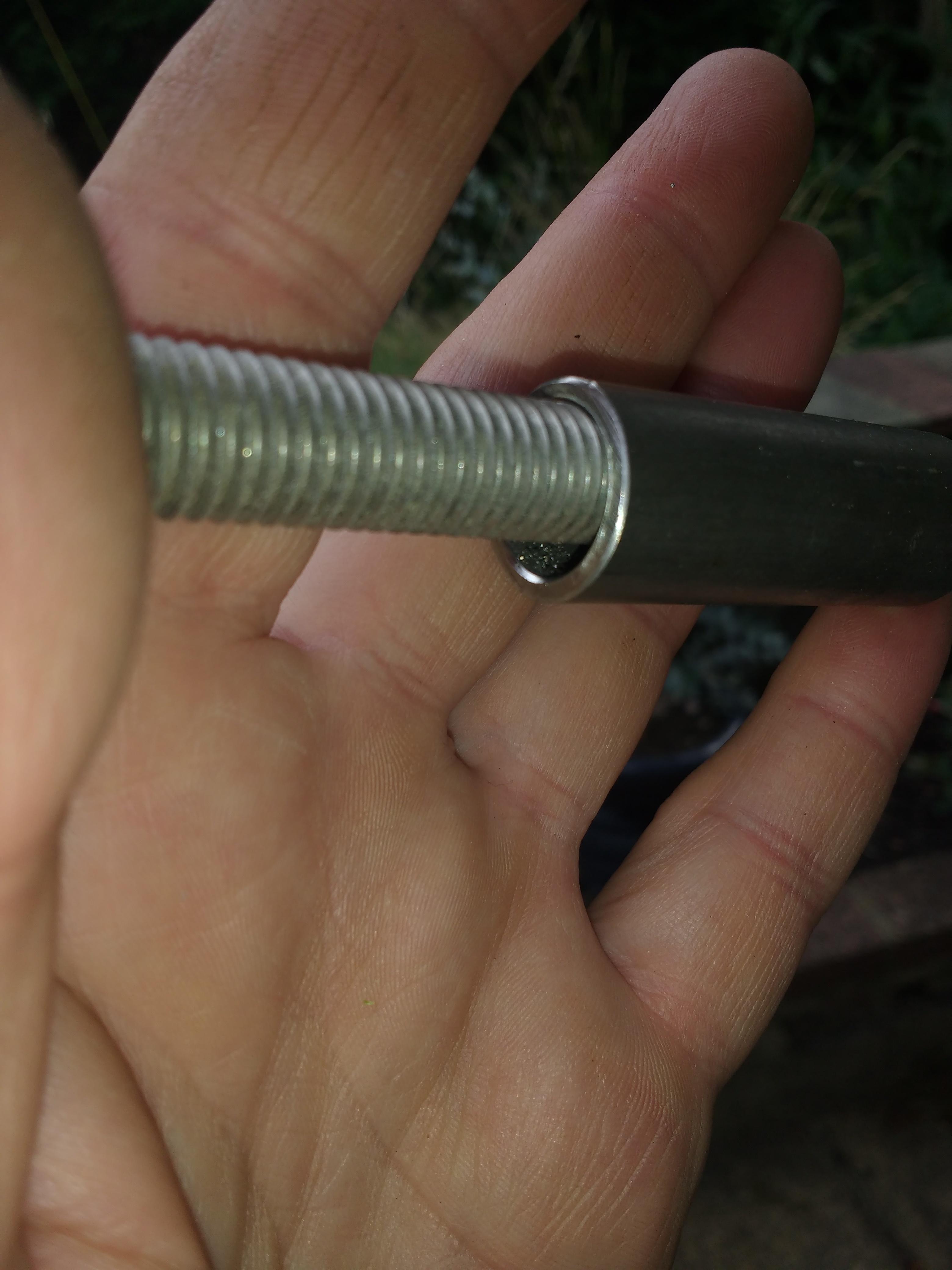

Right, stainless tubes cut. I'd cut slightly over length with the intent of turning them dead square on the BiLs lathe. Then realised we're a Covid household at the mo so probably not very sensible to go over to his place. Thus I've cut them on the bandsaw, dressed the ends with a flap disc and gotten rid of the internal burr as best as with a countersunk bit. They are square enough for whet you're doing. Length is 48/49mm.

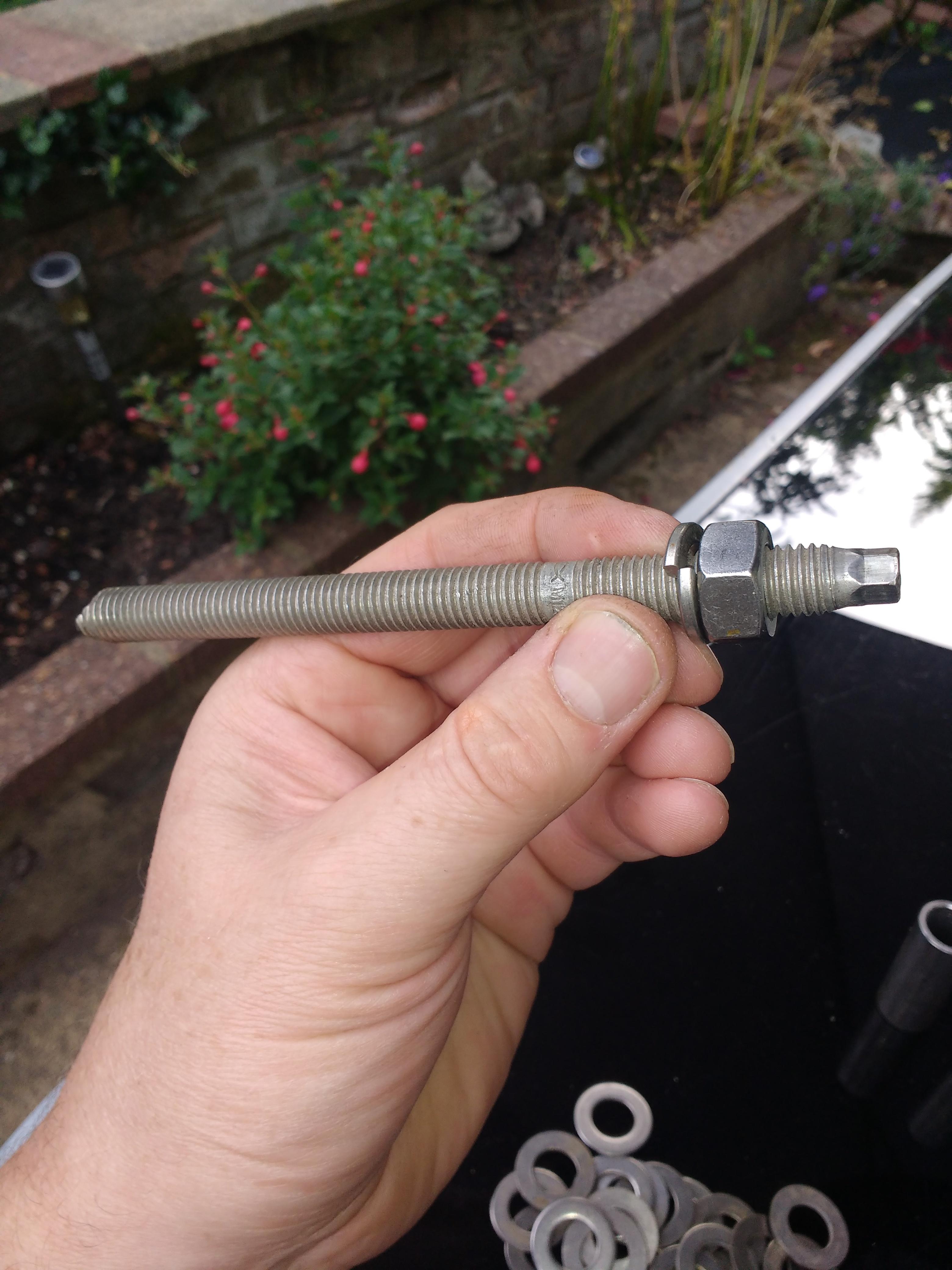

Shown on an M12 stud:

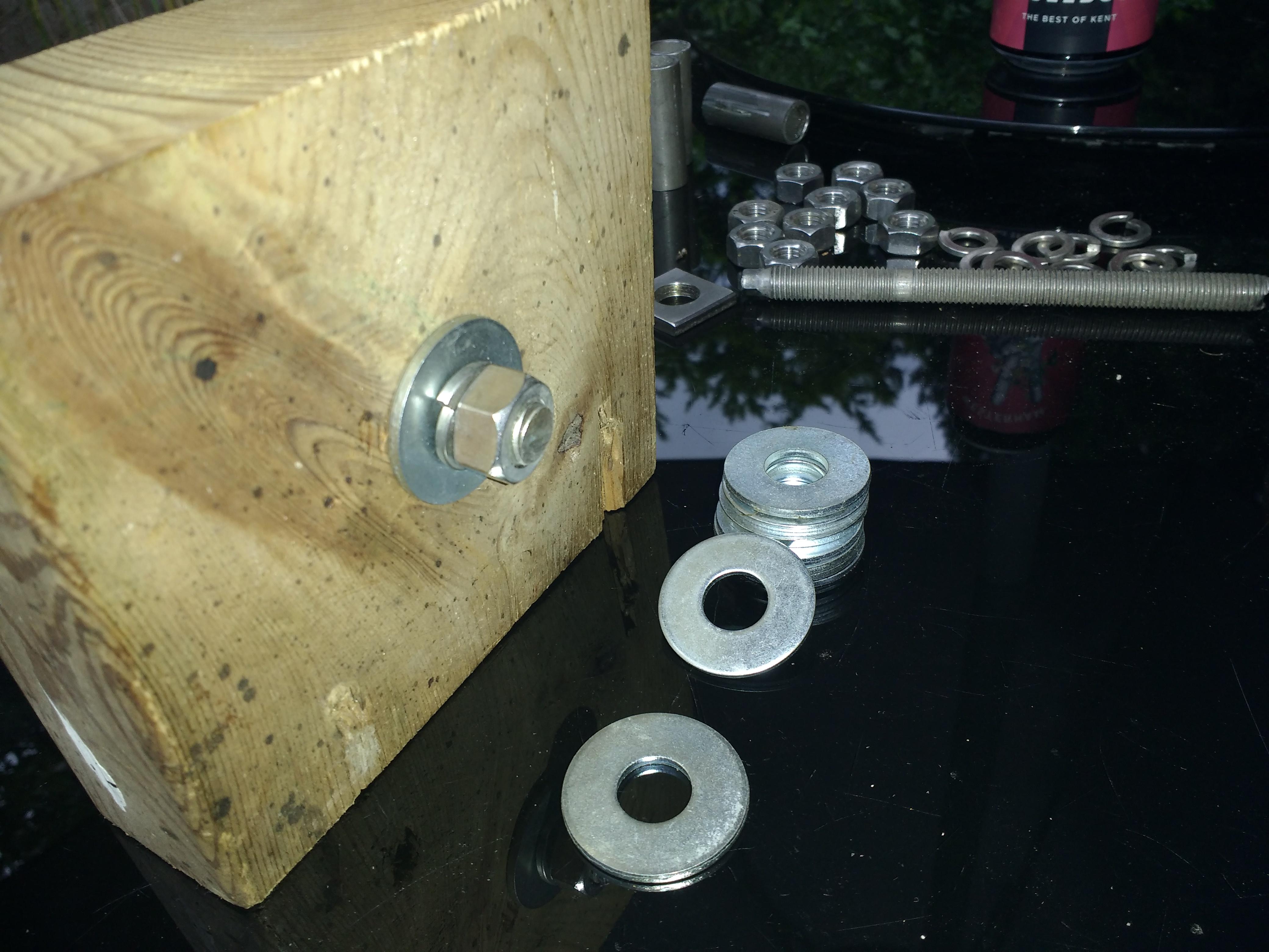

Then I've sorted 20 flat round washers, 10 spring washers and 10 full nuts. All stainless but a mix of A2 and A4 grade.
I'll try and remember to give you a small tub of anti seize paste. Messy stuff you smear on the stainless stud itself or inside the nut, that stops it locking up. Stainless, especially low grade A2 is notorious for it (locking up) if using nyloc nuts. No nylocs here, instead use a full nut and spring washer. Shown here on a genuine, M12, resin anchor stud. Has the hex drive one end and chisel point the other. For what you're doing just use stainless studding, cut to length. Anti seize paste is belt and braces.

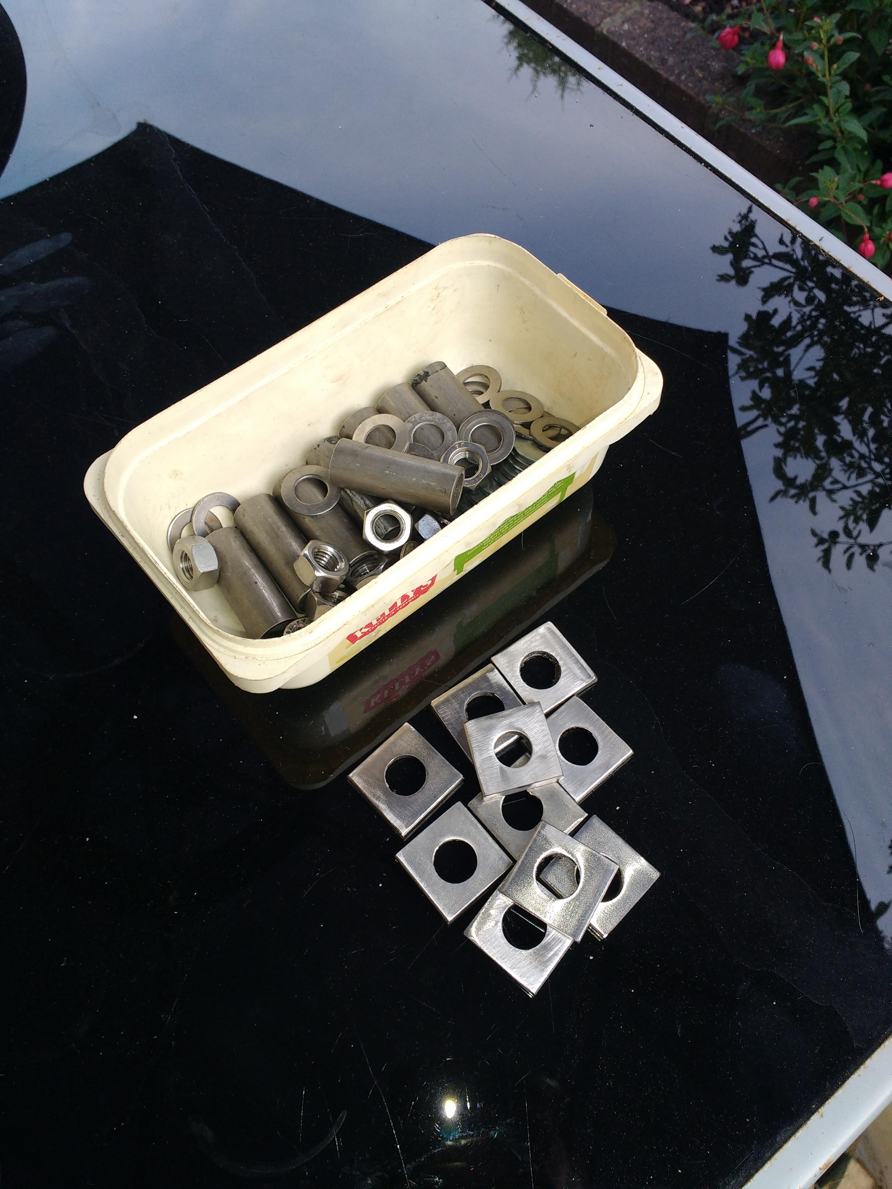

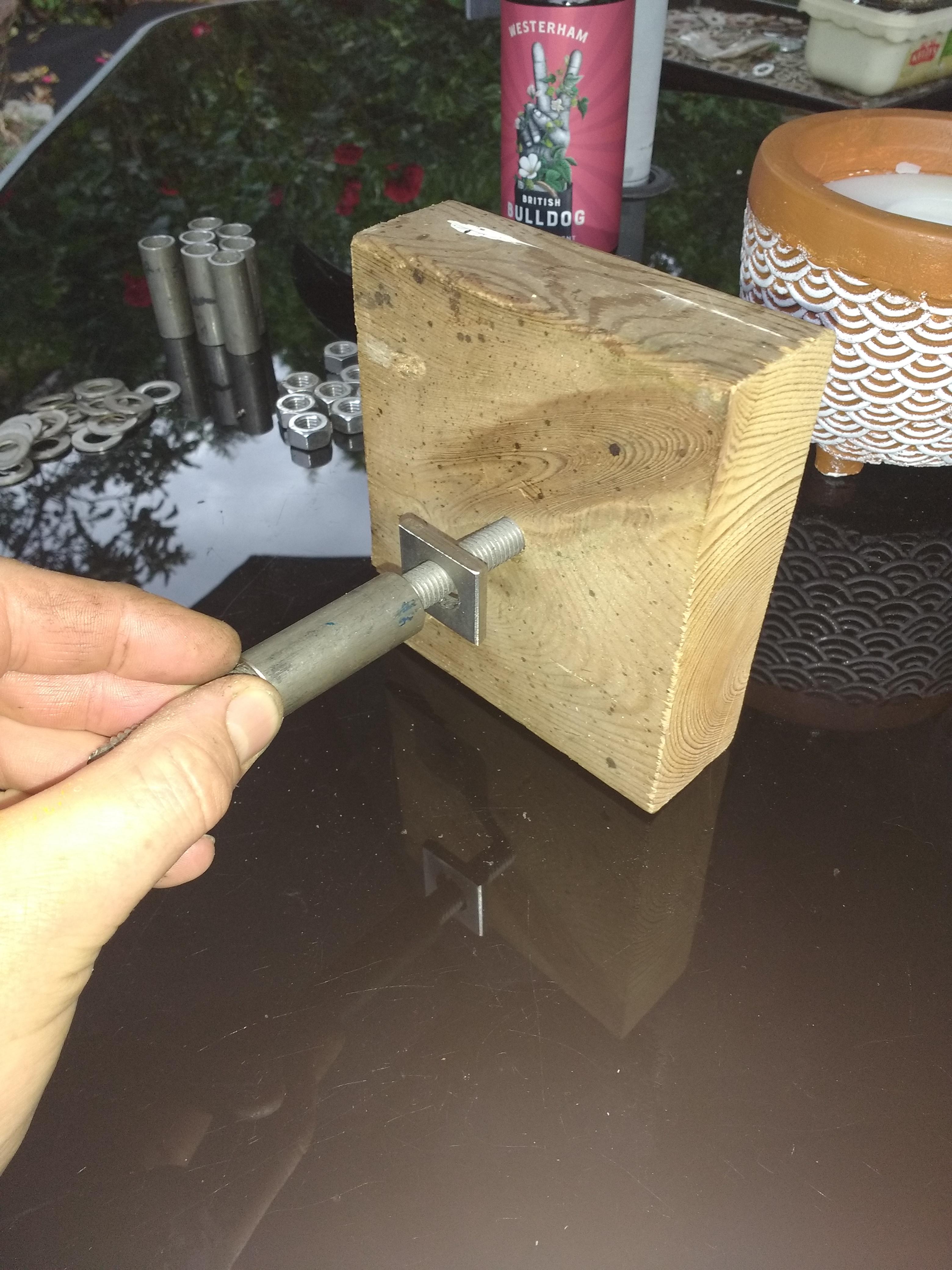

Evening @zoothorn Right I've drilled the 30x5 stainless flat bar at 14mm and started cutting the square washers. Sod's law I think the cutting compound is causing the bandsaw blade to slip. Truth be told I've had a couple so am giving up for tonight.
Basically you'll get these:
I'll tell you know the hole won't be dead centre like this in all of them! This is what you get when you don't employ a professional! :)

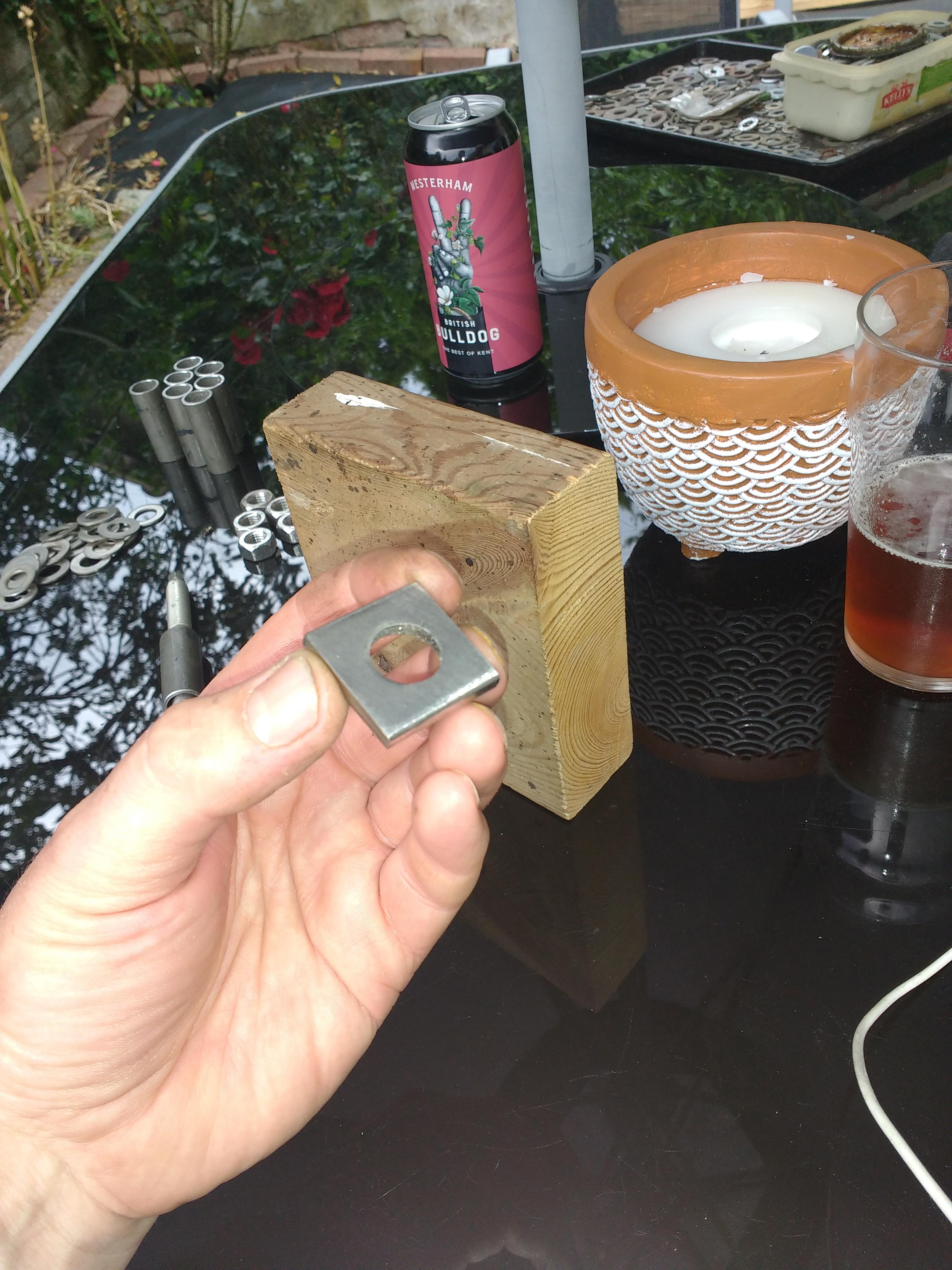

These square washers btw are from grade A4/316 stainless what you use for maritime applications. They won't corrode unless you I don't know over heat it or something. As in its good stuff. Tbh I'd have preferred to make them 50x50 but beggars can't be choosers so they're 30x30.

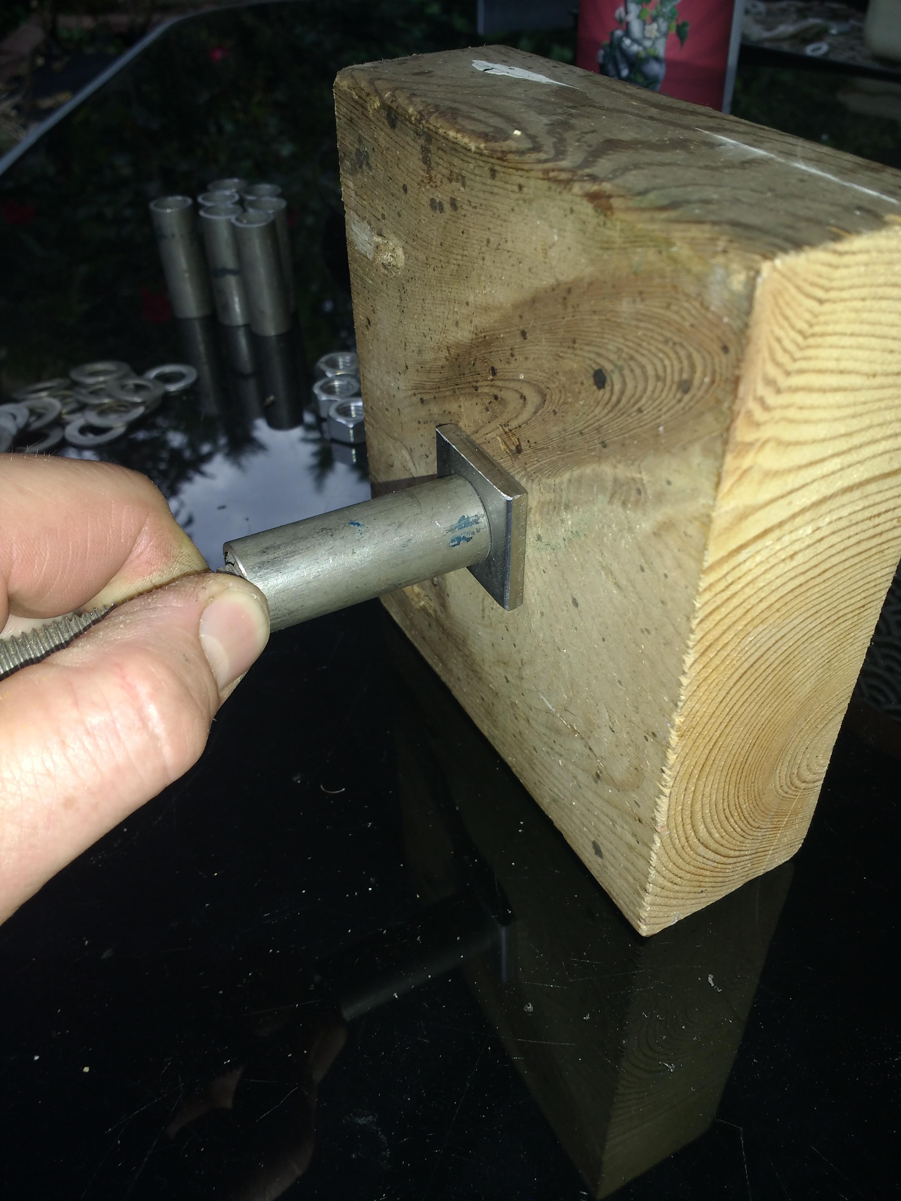

In use then the stud will project out of the spacer and there'll be a square washer on the end of the spacer, between it and the ledger. Mocked up like this:
The other side, the front of a ledger then again you ideally want a large diameter washer to spread the load. Here you could afford to use galvanised or even bright zinc plated ones for now. You can buy M12 square washers easily enough. Worst case if they rust you can change them later. The thing is that at the front of the ledger you can access it. I'll chuck in some large form zinc washers for the front, it'll get you going. So here it goes big washer, spring washer, full nut:
Ideally you want "3 threads" projecting from the nut so about 5mm but as it's wood, I'd go 10mm. Leave your M12 studding over length and cut off later. We'll discuss how razor sharp the ends of cut studding can be another time, along with how to address it.

I've just some A4 Fischer ones, photographed above somewhere, think they're only 160mm. Saying that I want to keep them for when I make steel framed infills either side of the gate pillars.

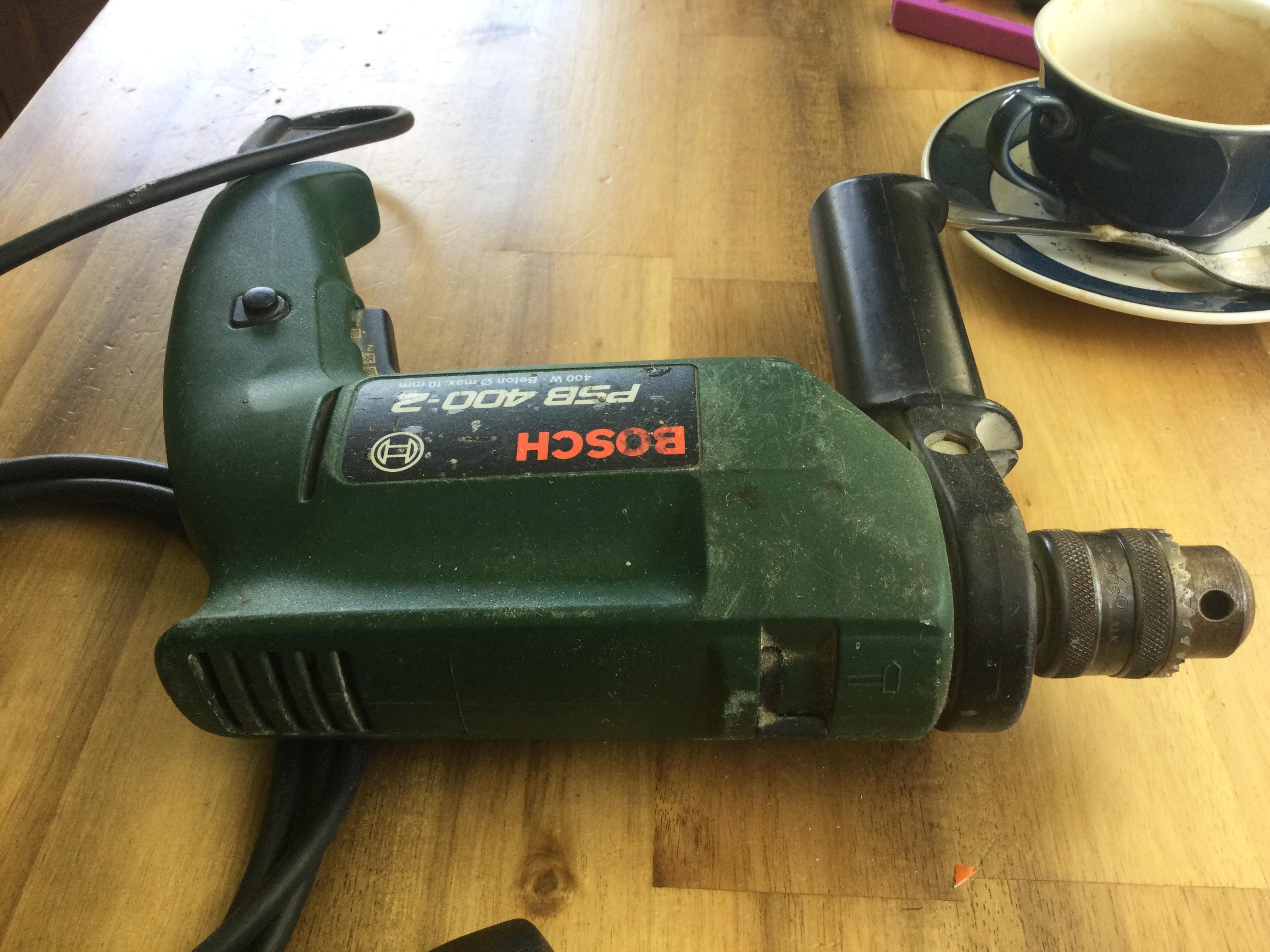

SDS drill.. is a hammer type, or one with a hammer setting? Mine does have/ switch on top. Precious this swiss made I sacrificed my smaller bosch on the porch/ burnt it out, don't  want to with this.
Thanks, zoot.
I don't think mine is an SDS drill is it. It's something to do with the chuck area. Mine's a std Chuck key type.
I did drill into the concrete cabin pads with it, though I used 8mm stud ( so would you have suggested a 10mm hole? Seems logical).. not 12mm.
