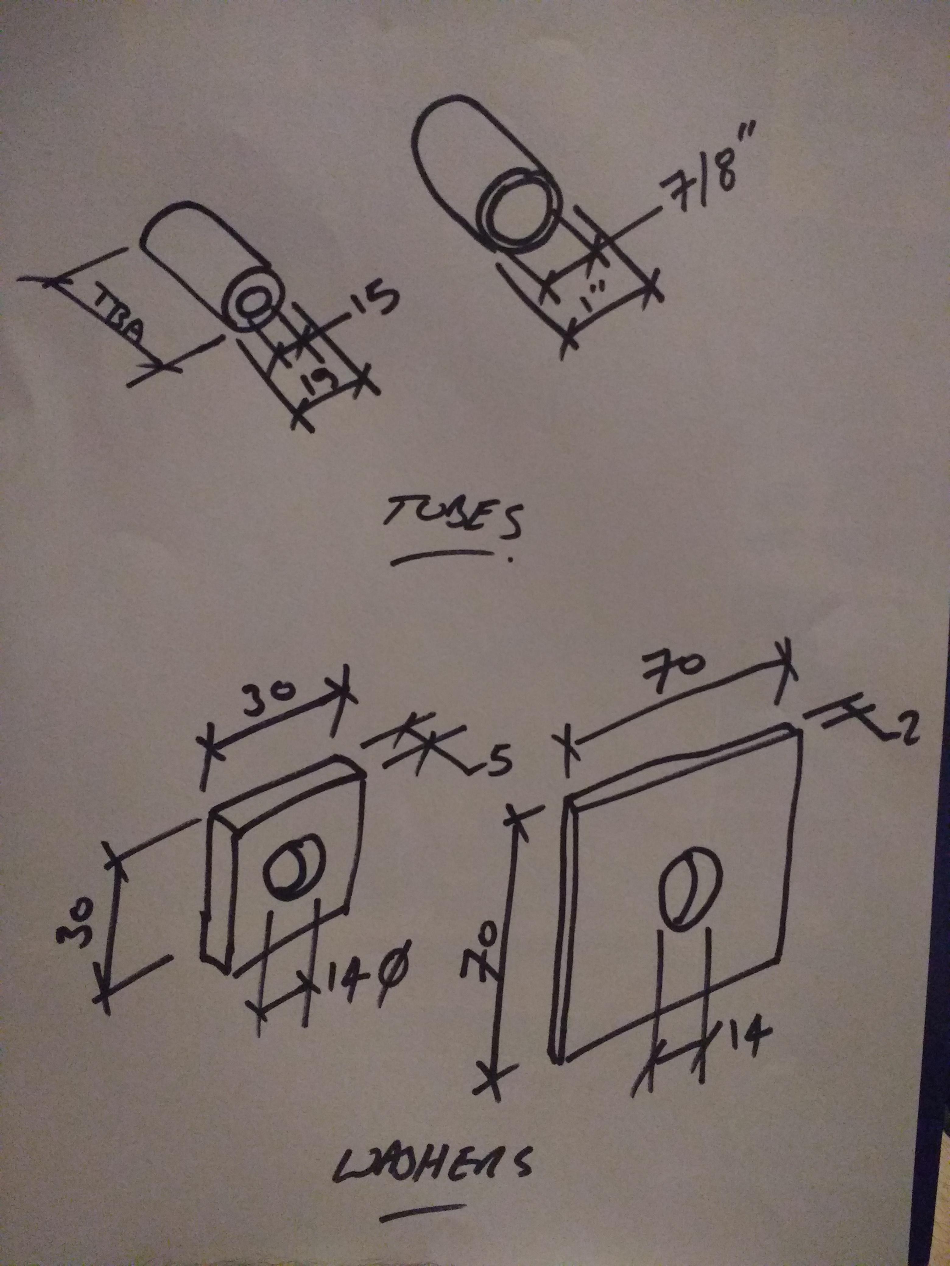

I've some stainless flat bar here. I could knock up some square washers at least for the rear, between spacer and ledger.

OK, tube spacers no issue.
The flat washers. Just realised I used the 5mm plate to make lintels for the gate pillars. Think there's more somewhere but where...
With what I have to hand I can do:
10 off - 30x30x5. Grade 316.
10 off - 70x70x2 . I think Grade 304.
14mm hole in the centre of each.
They'll be cut square enough and de-burred.

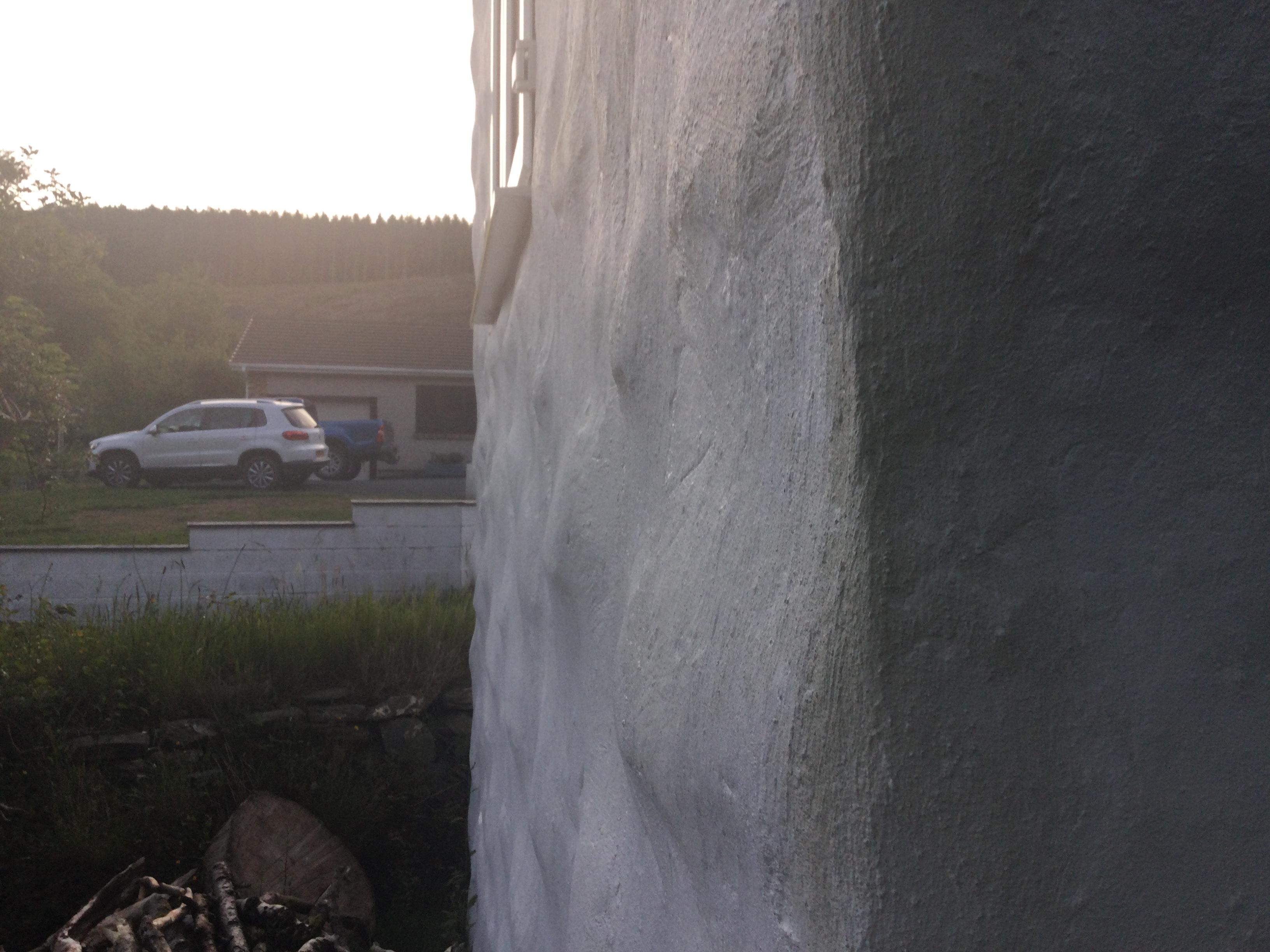

@Onoff I'm a bit behind but I'll get the 20mm flat bit out tmrw & drill down to a block face. Btw would the standoff conduit idea help by not blocking the tiny placcy block vents?

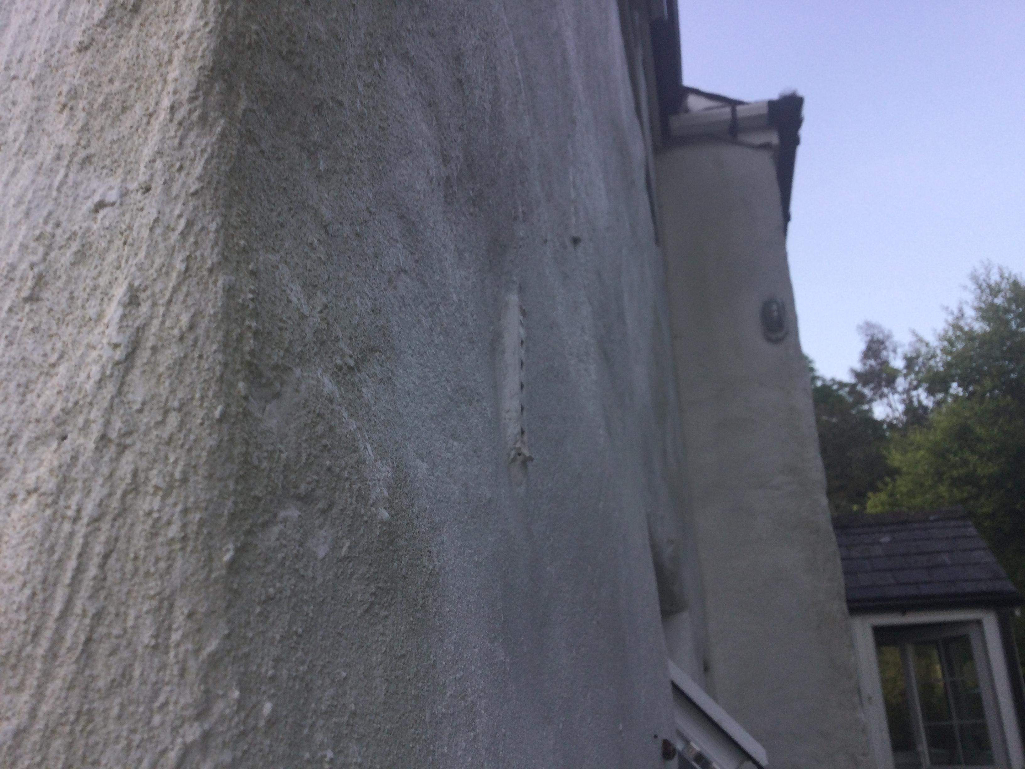

Pic 2 shows one of these odd 'vents' have seeped some stuff from, godknows what, seems a flow of calcified rain drips.. (seen here on the 'flatter' front of house 1st face).
The first pic is where balcony to go. Its like the house has mumps.

When you say 30x30.. what is the 5? The thickness of the steel tube section? It might seem this one preferable to the 70x70 ones.
Give me strength!
I can do lots of either tube
I may not be able to 13 of either square washer. 10 yes, for certain.

Ok sorry Im not on board with the washers yet.
I can so far understand the bits of tubing as standoff spacers, which is what I thought the 5 referred to. The thickness. But not then.
Is the tube bits to sit inside the washers inner diameter hole or something? I'm rather lost tbh. Or to spread the weight pushing onto the block? This seems reasonably logical. Im just thinking/ writing out loud.

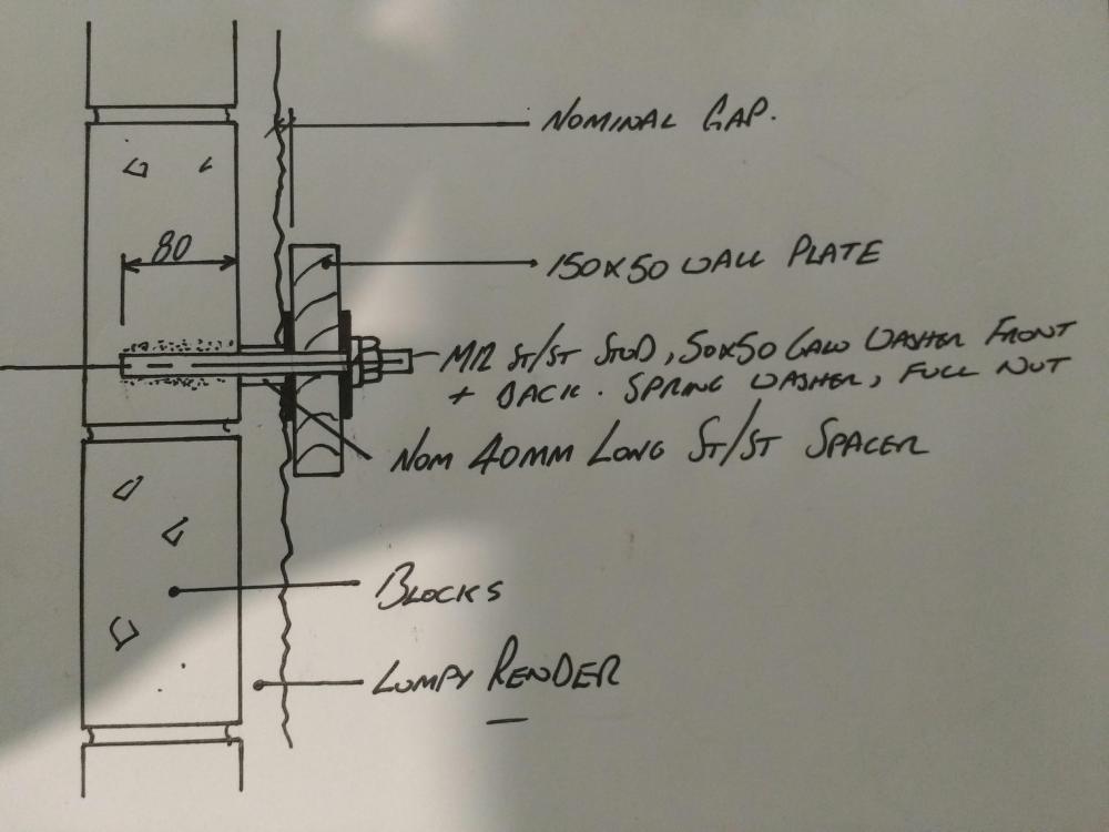

Once again, same drawing as before:
IMG_20220612_095213.thumb.jpg.4c2fd16d303c6632f611f4355a54f8aa.jpg.da45ddb2c9d5b8ff95fb8e13b516db1e.jpg
The spacer projects slightly beyond the highest peak in the render. Not drawn too clearly but I assumed you'd grasp the idea. I'm doing these fag packet sketches on the fly with a Sharpie.
A big square washer sits over the M12 stud and against the end of the stainless spacer. Ideally both spacer, stud and washer are stainless steel as you won't get to them again.
The ledger plate sits over the stud against the square washer.
Another big square washer, spring washer (to lock the nut) and nut secure the ledger.
The square washers spread the point load over the timber faces - normal, little round washers would dig in to the timber face. They also help stop "rocking" a bit.
The loads are thus transmitted to the blockwork not the render.
You'll want to seal up where the spacers penetrate the render, with silicone. Same when you put the first square washer on. Squidge some silicone around where the stud comes out of the spacer then put the square washer on.

@Onoff hi there, great thanks I was going to go back over your cross section sketch, but tbh Id not have spotted the standoff!
Ok I'm on board pretty much with that then. Alot more complicated than I thought. But I should be able to follow. Once this sodding ledger board up.. the frame is plain sailing. Apart from my 2 legs.
Anyway. Drilled into me render. And this is how inept I am: I can't tell if I've gone down into block, or Im still in render. I've chosen a dip area to drill in from (my brain worked that out itself) & gone in 3/8" with a 20mm flat bit: surely I should be into block by now? I can't seem to tell tho.

Im ok to crack on. But I am hopelessly stuck, & feel idiot-panic creeping in. Im trying to establish where the block surface starts, but I can't. Unless I find this it seems, I can't start the job.
I flat-bit drill into the render. Im starting at a dip. I drill in 2 cm. It seems I'm still in render. Or am I in block? i cannot tell.
As the two are " grey" I cannot distinguish a boundary. When I drill I push the ground render fwd, hampering seeng a sudden change/ boundary. I scrape & brush. I cannot see a boundary.
I try onto an offcut block, hoping I might " feel" a clear difference to the render. But it feel similarly soft/ hard. Ive no idea how thick the render was applied at the 'dips' so have no clue of an approximate idea of where the block starts.
Is there anything else I can do? Thanks, Zoot.
