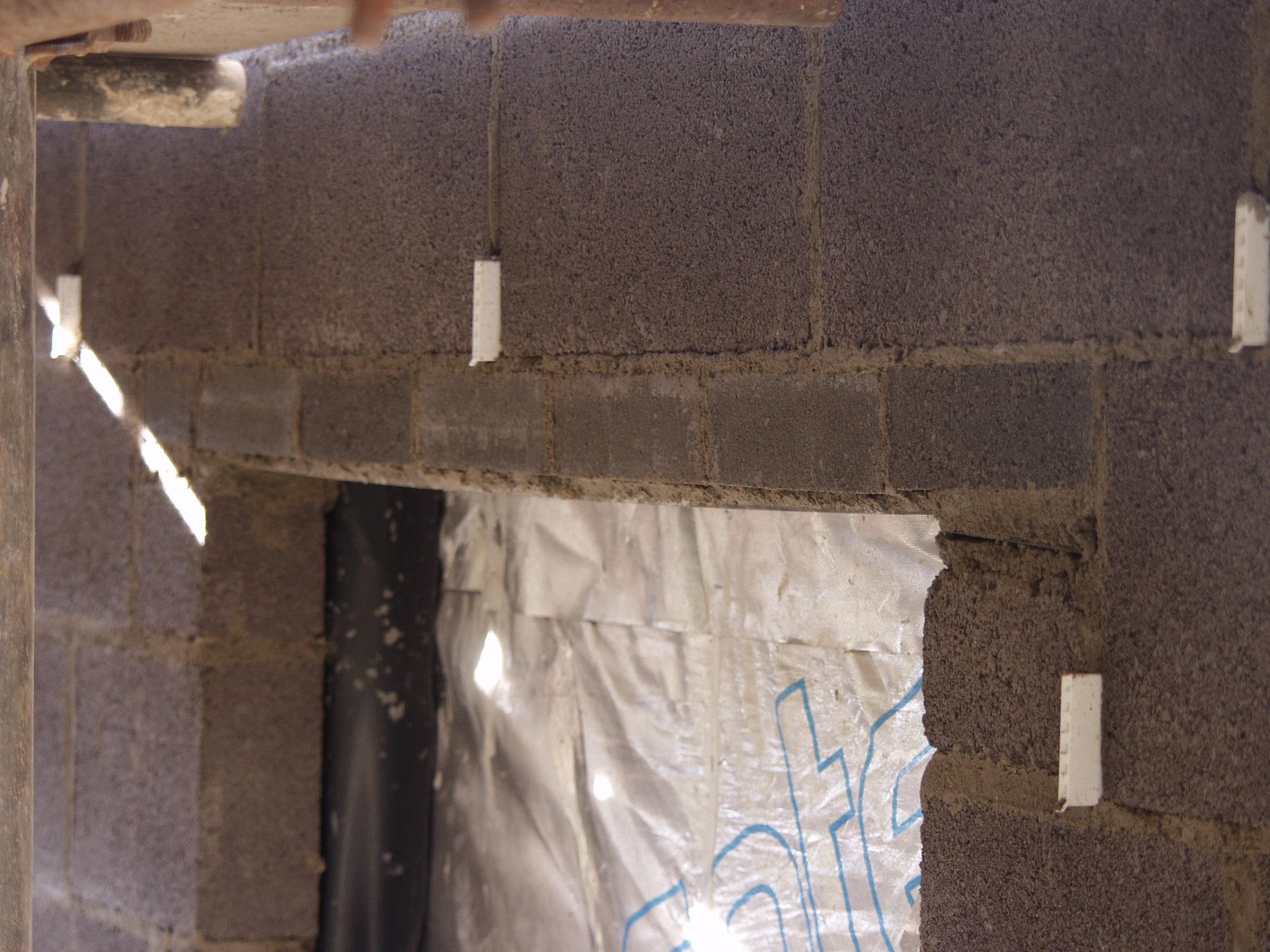

Anyone know about the vertical white plastic vents between blocks? They're possibly set proud of the block?
If so maybe there's a standard extent renderers aim to set them proud of the block.
Thanks, zoot

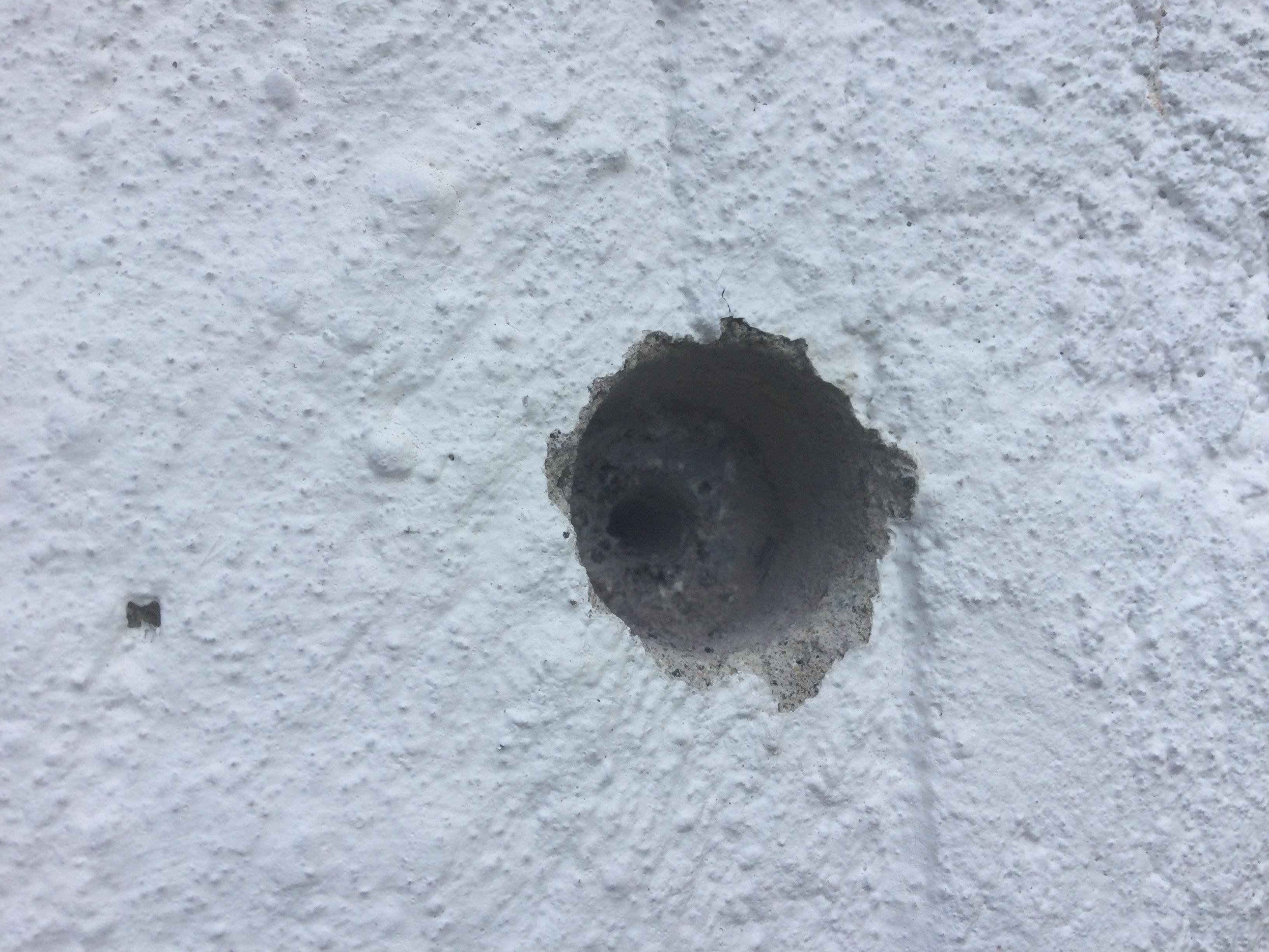

Hard to tell Zoot the hoot but, from the picture it looks like you may be way past the render and into the block. So hard to tell from looking at the pic
Hi BJ, yes this is what I'm thinking too. Dammit. This is holding me up. If only I'd thought of asking this area under my doors to be smooth render.
So another option surely on paper anyway, is whether these mumps dips areas, can be added to.. to flatten it all.
But then Im fixing into who knows 2" of render, & still unsure where the block starts, to guage how far in to go with the studs.
Would anyone know if there's any way of -removing- this render?
Zoot
The only other thing is, do you know how thick the blocks used in the construction are ? (100mm). You could drill until you reach the cavity. Then using a wire coat hanger with a small 90 degree bend on the end, measure the depth of each of the holes. You could then plug each hole with a bit of plastic bag untill it gives you the 80mm depth you require for the stainless steel rod. Pump each of the holes full of resin and stick you overlenght rods in. When they have gone off, cut and put on your spacers and washers. Put your timber up, followed by your washers and bolts. Then trim off the excess rods.
First off I'd sluice that drilled hole out with water from a plant spray bottle. Drilling dust may well be masking an obvious colour change between render and the underlying block.

What I have found, as a clue?, is this photo. If these vents all put in to a similar proud mark (presumably all were) on all 3 walls prior to rendering.. & their extent out must be some "render guide" then I think my best bet is aiming for "20mm" below the vents.. as my block start point. 30mm sounds wrong/ too thick, to me.
Does 20mm ring a bell to anyone, as a standard dim to set these vents proud of the block I wonder?
Better than a 30mm mark, if I'm aiming the studs into the block a good 50mm minimum surely.

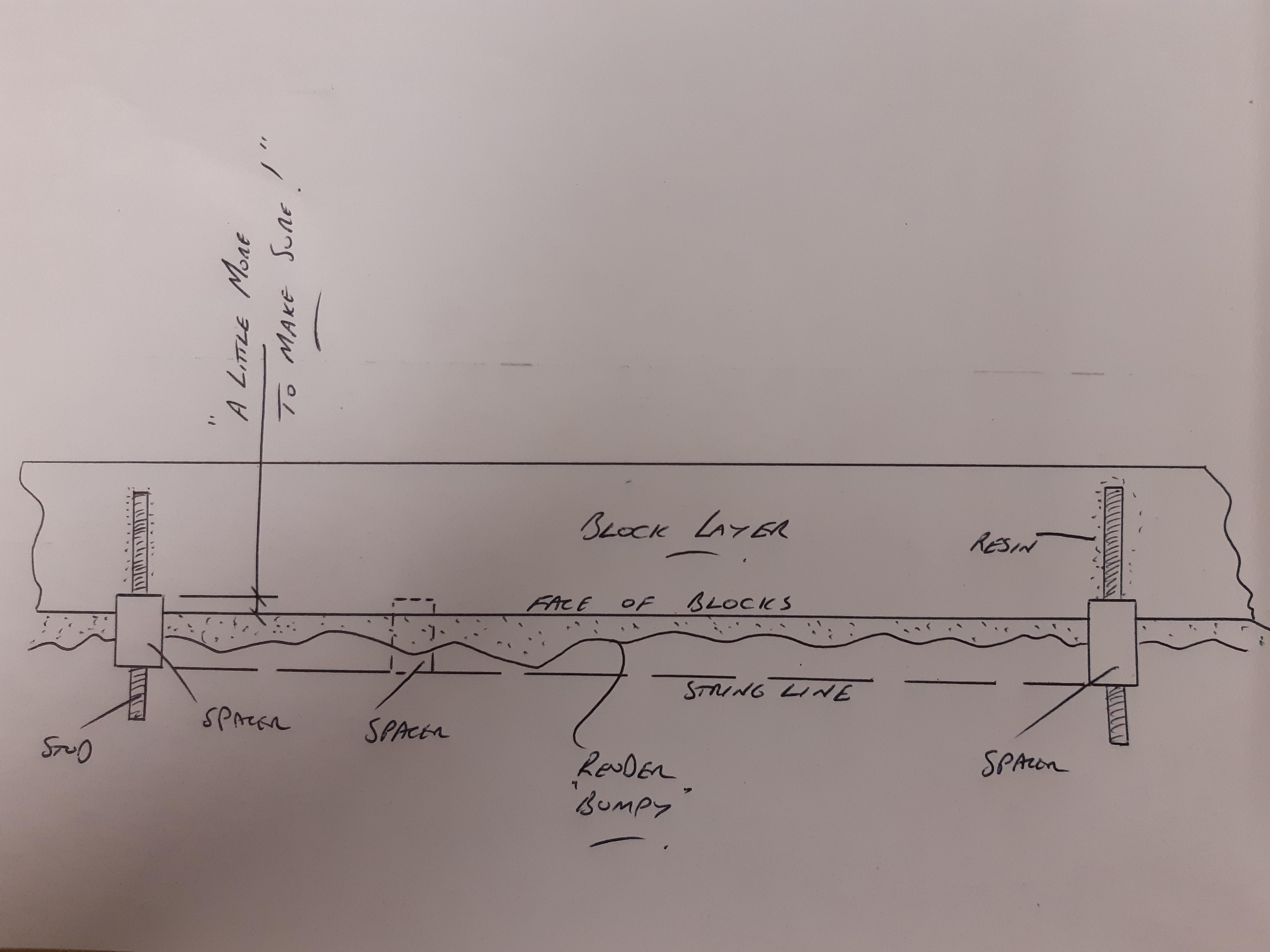

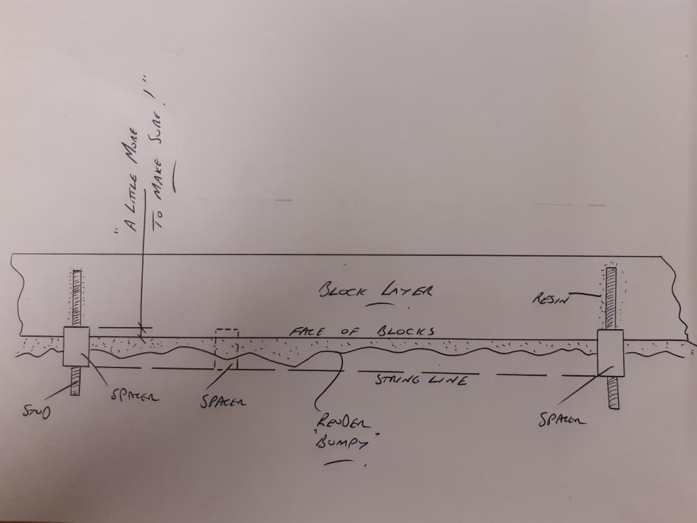

Hi chaps. (More oldies' wknd duties. But Im free again!)
Great help Onoff with this sketch, really clear. Stringline good.
Ok back on board. I've (best I can) determined my highest bump, to the start of the block @ 45mm. Call it 50mm including "A Little More" safety.
Now is this figure excessively high for the spacers I wonder?
Thanks, zoot.

12 minutes ago, zoothorn said:
But don't the spacer's also need a flat say steel surface to press against, at the block? might they cut in without?
Fair question I suppose, but the stress on the fixings will be shear, in other words vertically down, the pressure on the spacers will depend on the tightness of the nuts only! Perhaps a thick walled tube as the spacer would suffice!, gentlemen, comment!
2 hours ago, zoothorn said:
I realise tho getting a big square washer for eg, here... is a tricky prospect: clearing & prep a big smooth area of render.
The thoughts up to now weren't to have a washer here, just tube bearing against block. It's a fair comment though. Imho I don't think it will be an issue.

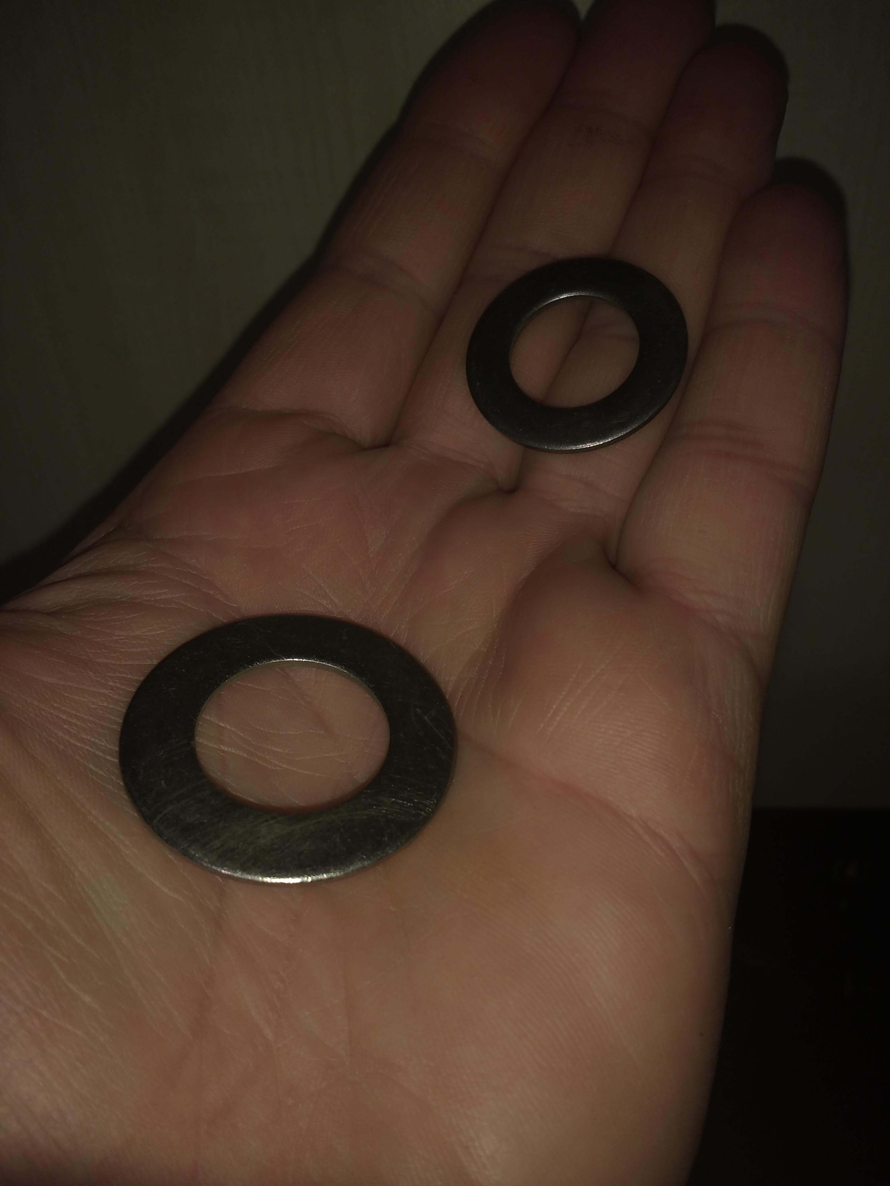

Washers I have to hand are M16 and M20.
ID/OD is 17/30mm and 21/37mm respectively. Forgot to measure the thickness but would guess 1.5. - 2mm
Hi Onoff,
as said I'll go spacer onto block, without washer, after Peter's thoughts. But if you had a few anyway for -shim- duties, on the timber side of things.. that would be great.
So 5x 45mm long tubes, perhaps the metal width as thick as poss, & overall tube width- up to your opinion.
Os that ok? I can shim, or grind a bit of render off my biggest 'mump' if needed. Or chisel the bleedin stuff off!
Thx Zh
I'll send you a selection. I'm doing all sorts of cutty, grindy things today so may get them done.
